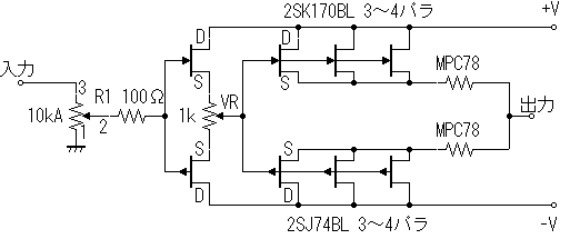

...i had small dc offset on output, so i put cap there...
Add some more JFETs and a pot
