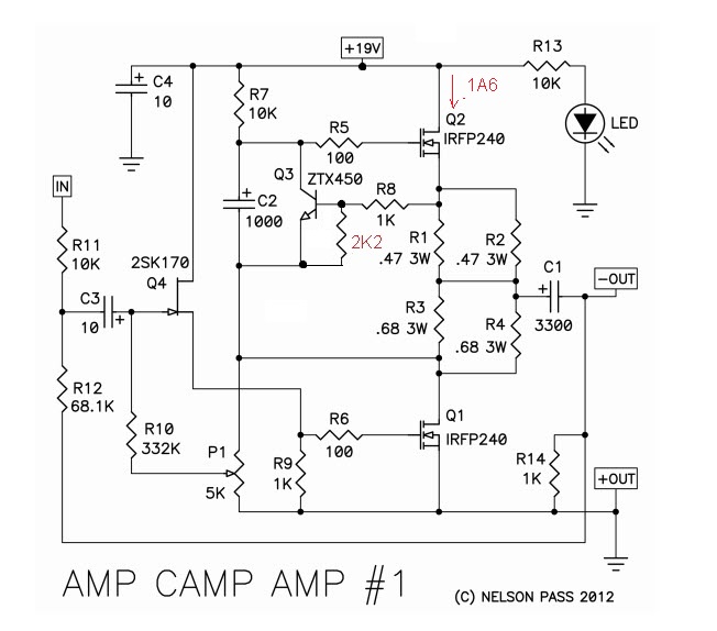

After seeing how the simple capacitor I use for the crossover of a FOSTEX T500 affects the response of my JBL2441/Truextent I am thinking I need a dedicated amplifier for these. Maybe I could figure out how values to keep it from creating a rising response but I would rather just power the T500s separately and not touch my crossover for the 2441s.
Cannot afford an SIT1 for just the tweeters - I could not afford the SIT1 to begin with but I had to have it.
I would like a single stage design since I am lazy. I do not have a problem with caps on the inputs and outputs - would not have a problem with transformers, either.
Crossing over at 9 to 10KHz so very little power is required. Of course, a first order slope will be used so it needs to be GOOD sounding since it will influence frequencies below for an octave or so.
I was thinking about a spud amp using that Russian tube that Romy uses but I thought I should stick with the PASS signature since the range above 100 hz is driven by First Watt amplifiers and a tube could lend discontinuity to the sound.

I am embarrassed to have to admit I do not know which circuit is the ACA!
Please point me in the right direction, ZM.

AMP CAMP AMP - aha! If only I would search before asking ...

What would you think about lowering the amount of feedback to get some more gain?
I have this unbearable desire to do SOMETHING different with it. Likely I will leave it alone - If I need gain I will put an autoformer in front of it.
Will it be happy with just a 1uF output cap? Sure hope so ...

ya can call it Poor Man's SIT amp
Well, if we replace the current source with resistors could we come closer to a poor man's SIT1?
Or is this the place to try choke loading the MOSFET?
Any thoughts?
Just found ZM's SHADE version. ZM, should I try this?
feel free to try everything you want
ACA - it isn't simple CCS above , that's sort of Mu Follower
but , who knows , maybe you'll prefer resistors instead
I can't remember that I made Shade version .... 🙂

I know people who love resistive current sources. Actually, the SIT-1
uses that. Halves the efficiency though...

not Ing. Pass himself , but eternal adoptee ......
if you're keen to do that ..... make ACA in original iteration , then listen
after that you can replace upper half with few power resistors
will post schematics soon
............ then listen .......... leave whichever iteration you like most
again - output cap goes in size and flavor of your liking

5R625 - not exactly value carved in stone
however - you can find them easily at ,say, mouser
chassis mounted (usually goldish) , 25W resistors
two of 1R8 and one of 2R (or 2R2) , all series connected , will result in nice 75W resistor group
you can get them for under 20 bucks (for all 6) ....... shipping excluded

Michael Percy has some non-inductive goldish resistors - does non-inductive mean anything in this application?
Sorry to keep pestering you about the feedback - do you think there could be any value in increasing the value of R12?
I'm not overly bothered with "non-inductive" resistors , finding usual Dale-ish goldies enough non-inductive for my liking
feedback - same as I wrote for trying active vs. resistive loading - try original ACA , then change one thing at a time
why should you want changing stage gain , in first place , without any defined starting point ?
To satisfy my curiosity - I read that some have recommended using high voltage B+ - is this simply for more power or is there a sonic benefit to doing this?
The reason I keep going on about the feedback is to adjust level if that is needed; there is the 4 dB difference between ACA and SIT1.
I will be using a crossover arrangement similar to what I am using for the JBL/Truextent on the SIT1 - both input and output caps sized for the crossover point but with the addition of an inductor for a .5 Q slope.
I have found with the JBL that an Lpad/damper really makes an audible and measurable difference and for that i will likely need the extra gain. If you think the distortion from low feedback would spoil the whole thing I will dismiss it now.
