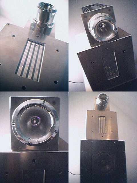

Do a search for "plasma tweeters"... basically, you use a small tesla coil to create HV and ionize air near a wire to create a "flame"; the high voltage then gets modulated to an audio signal to create the sound. As i recall, this works only well for a tweeter and the sound is suposed to be quite good. As you said, ozone is a concern (it's poisonous in high concentrations) so you might want to play that on an open room 😀 I have some schematics laying arround if you can't find it on a search engine.
I build a pair of plasma tweeters, and there is no smell even after hours, likely because it is hot inside the housing.
Ozon falls to pieces fast, when it is hot.
This is not my explanation, just read it somewhere else.
Bernhard
There is no kit, no manufacturer.
Various schematics can be found in the internet just by typing +plasma+tweeter
The horn is taken from the Visaton TL16H horn tweeters.
I use it with a 5 kHz 24 dB crossover, soon it will be changed to 3,5 kHz.
It sounds very real...
I have curves somewhere, but I am not shure if they are correct, my notebooks soundcard isn´t so good.
Your chassis and horns look so nice, I thought it must at least be a kit.
Nice work!
I've been through the DIY plasma tweeter sites, but none of the pics looked as clean as yours.
Is there any danger of arcing to your metal horn throats?
What's your approximate efficiency with the horns? From what I've read, the other DIY plasma tweeters are plagued with inefficiency.
Bill
