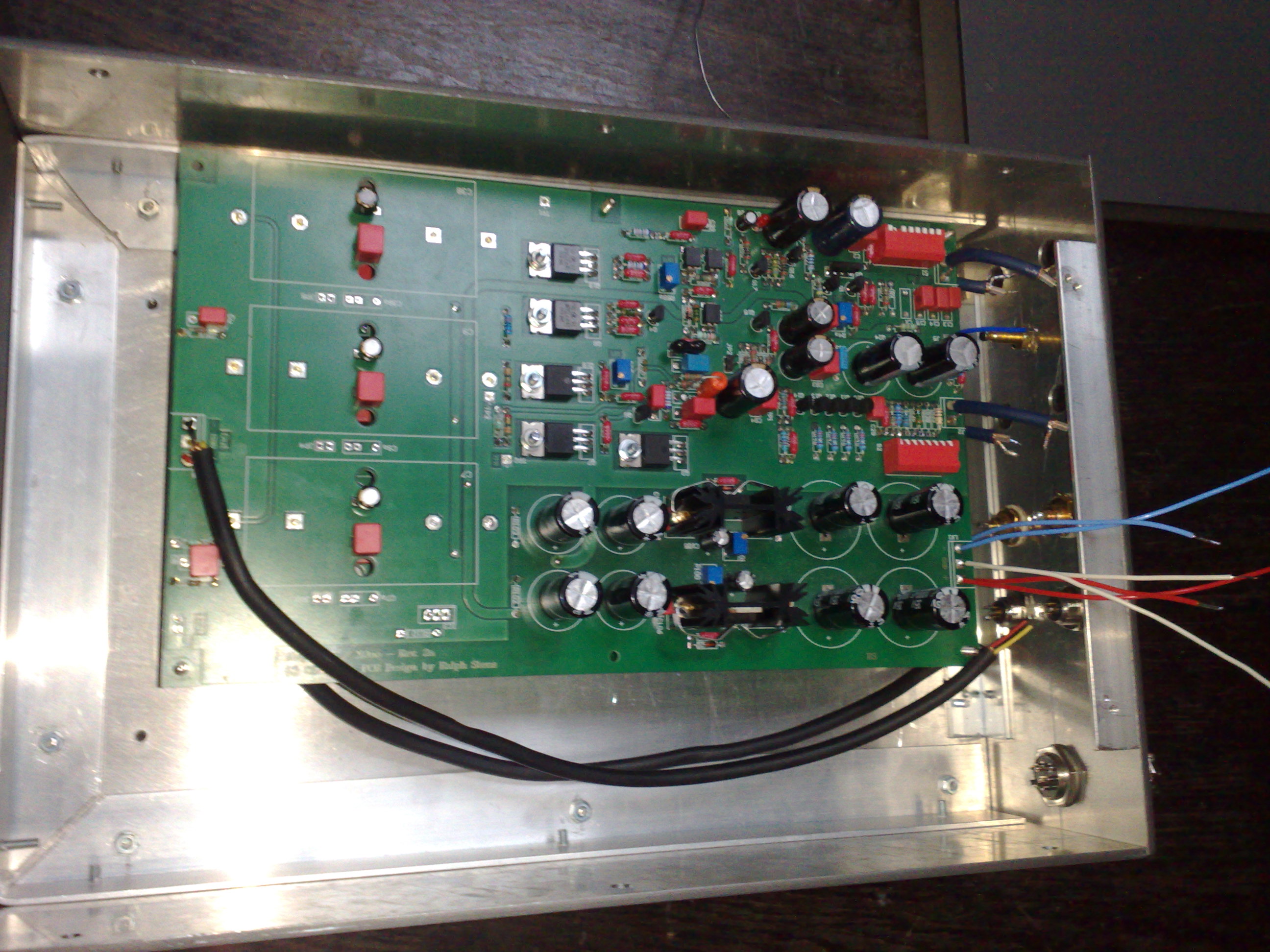

Hi there! I don"t know if I have te make a new post, but thought I can follow this one because its about the xono.
I have the Ralph Stens boards and they look fantastic, but got on one board good gain with back ground humming and on the other clean gain but to soft.
Anyone here can answer me this problem.
On the board with the good gain I have at the output around 47mv jumping down between 25 and 60mv on the lower gain board I have between 0 and 10mv. Could it be a grounding problem? I don't use the xlr's output but got the minus from the board output on the minus from the xlr connection, then coupled to the gnd from the rca.
Can I adjust the gain on the boards with only the blue jumper switches or is there an other place on the board to adjust?
Thanks for the answer. Teake

The original Ono offered gain reduction by inserting jumpers in 1-2 places; unless you put them in, there is no switchable way to affect gain signficantly as long as the circuit itself is working properly.
If you get significantly lower gain in one channel, then that sounds more like a problem of the circuit to me. The Ono has a rather sensitive frontend that works only for low current jfets (GR and lowish BL).

Hi there!
I can't get my xono fixed! I checked the solder joints and measured the checkpoints. Still only one board is working with hum (hum getting louder opening the volumepot of my pre), the other board still getting sound (also with the same hum) but with the volumepot at more than half open. At that board I got 370mv on R47. So is it possible that Q12 isn't working? Thanks for the answer. Grtz Teake
