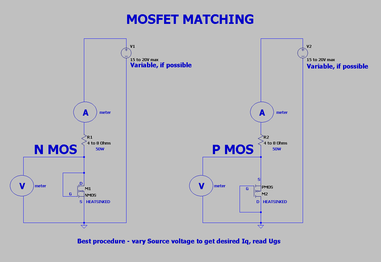

Focus on current, not voltage, and use a heatsink during matching:
I meant to use the values (in this case 50 ohm resistor vs 16V5/29V) that provide the correct current that the MOSFET will be biased to in the real circuit. To rule out factors such as draft, and to reduce risk of blowing the devices up during matching, I always attach the MOSFETs to a heatsink during matching.
My suggestions are as described above, but you can decrease resistor values to accomodate lower voltage during testing. I think I used 25R.
Make sure you use a big high wattage resistor.
In any case you cannot measure Ugs simply by recreating the original circuit, much easier to follow Pa’s schem.

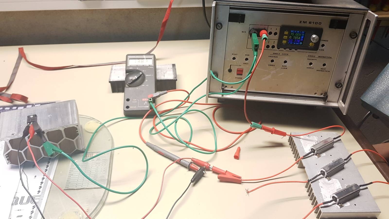

Oh ok, thanks for the clarification. it is for a A2 which I have for quite a while and that I want to finish now. They require 2x 6 N-Ch Mos for each Channel. And indeed, I read the schematics too quickly, the resistors in the circuit are 6x 1 Ohm, and not parallel (each R is between the MOS's source pin). The 6x0.47 Ohm in parallel are attached to the drain. But as you say, none of them are relevant here.
Yes I already prepared a heatsink for that purpose, with silicon pad. Yesterday I gave it a quick try and had quite low current values (around 180mA) despite 6.2 Ohm Resistor (50W R array, also mounted on a separate heatsink). I'll have to check again, I suspect a PEBDAC (Problem Exists Between Device And Chair)...

I see! Nice setup!! Well prepared 🙂 with such low resistance you should achieve 350mA with approx 8V5 on the supply. Given using one of the resistors (I see you have three).
well yesterday I was far away from that... approx 180mA with 15.00Vcc...so something is wrong for sure. Maybe I had 1 or 2 beers too much... I'll check everything tonight and will keep you posted.

But I am unsure whether your circuit is correct. There should be no need to measure current. It is given in the V/R ratio.
Have another look at this article by NP:
https://www.passdiy.com/project/articles/matching-devices
Based on this I use 170mA just like Pa for IRFP240's. 1000's are happily running in Pass/FW clones, Ampeg Bass amps, Llano rebuilds, etc.

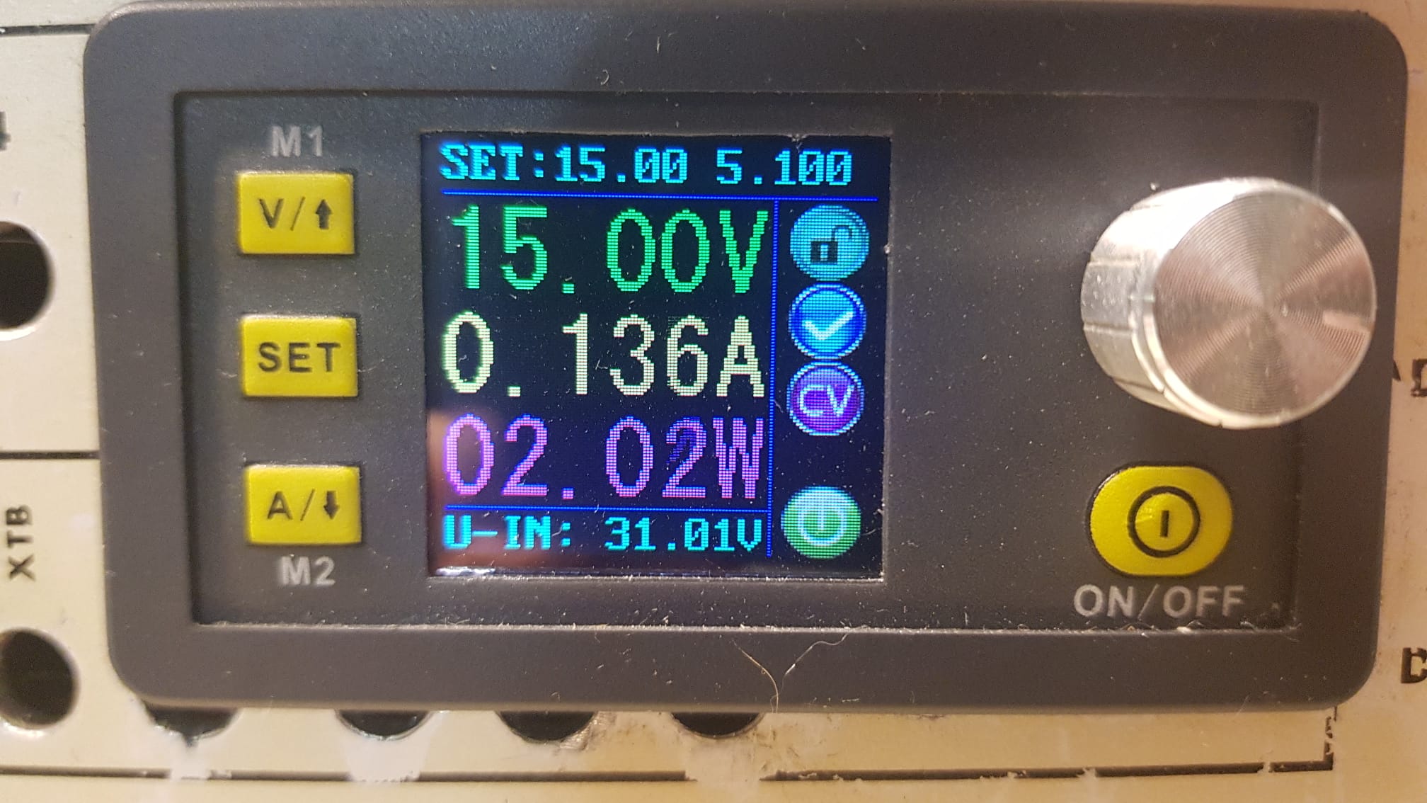

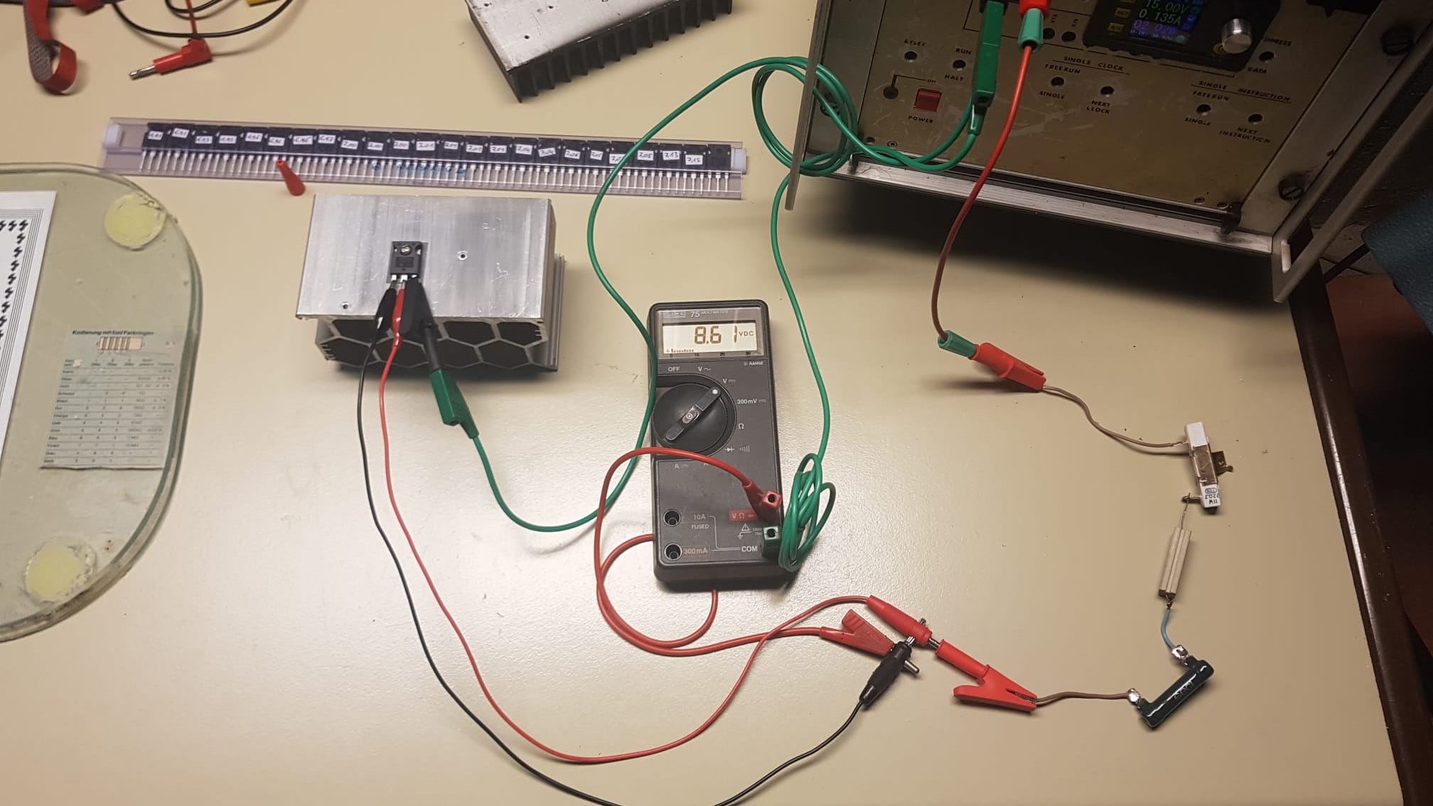

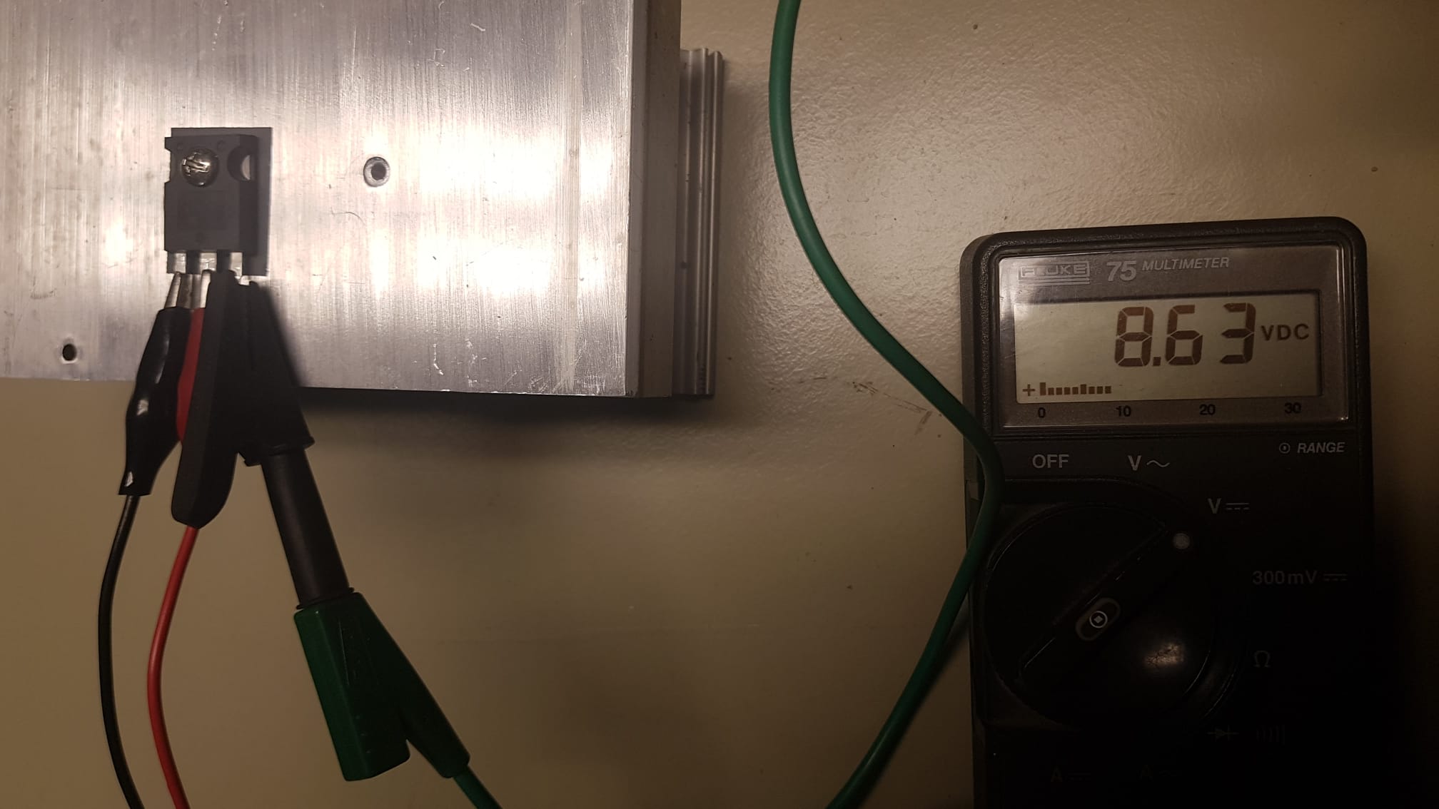

OK, done it again (sober - so this is ruled out as a possible cause) but I still get different values from those expected. R = 46,8 Ohm
Vcc voltage is 15V, and the circuit draws 0,136A only
Vgs = 8,63V. I tested with another multimeter, with similar results +/-0,1V)
Here's my setup. Do you anything wrong?
all green wires are ground.
Red coming from the PSU is +15V, runs through R1 (47 Ohm, measured), and from there to pins 1(Gate - black) and 2 (Drain - red). Source pin is the green wire on the right that goes to ground.
and seen from the top, left to right we should have gate, drain, source.
