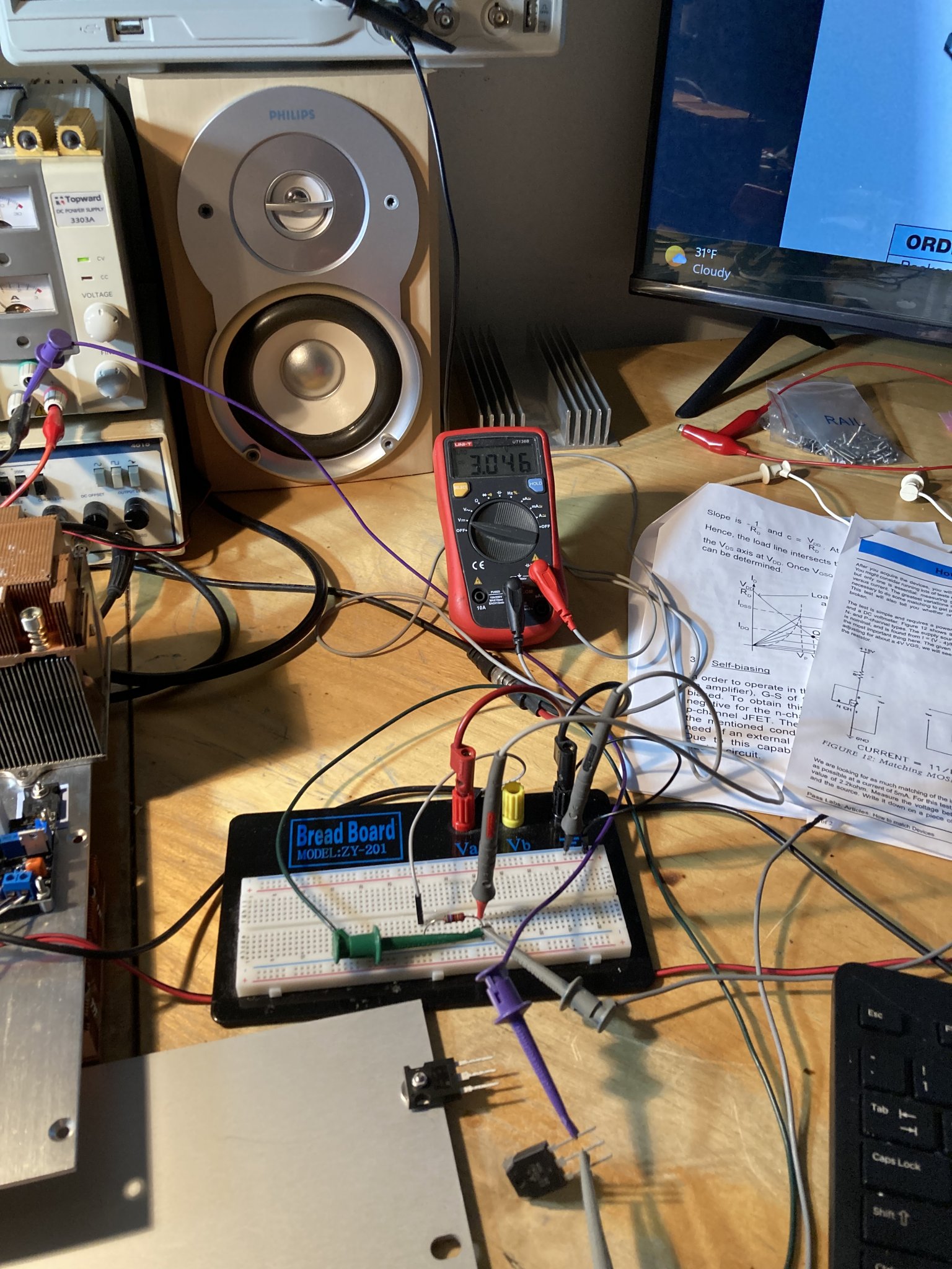

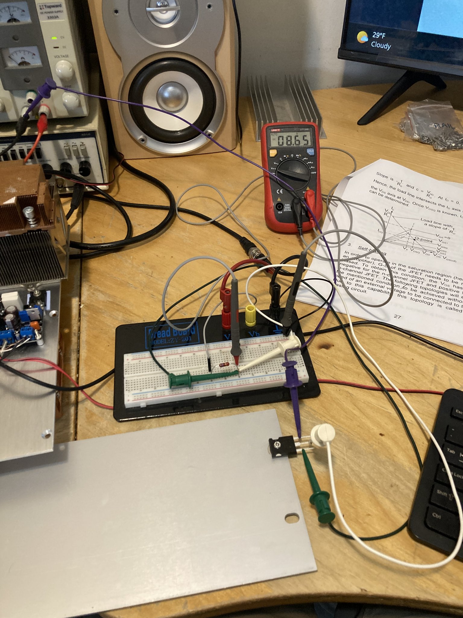

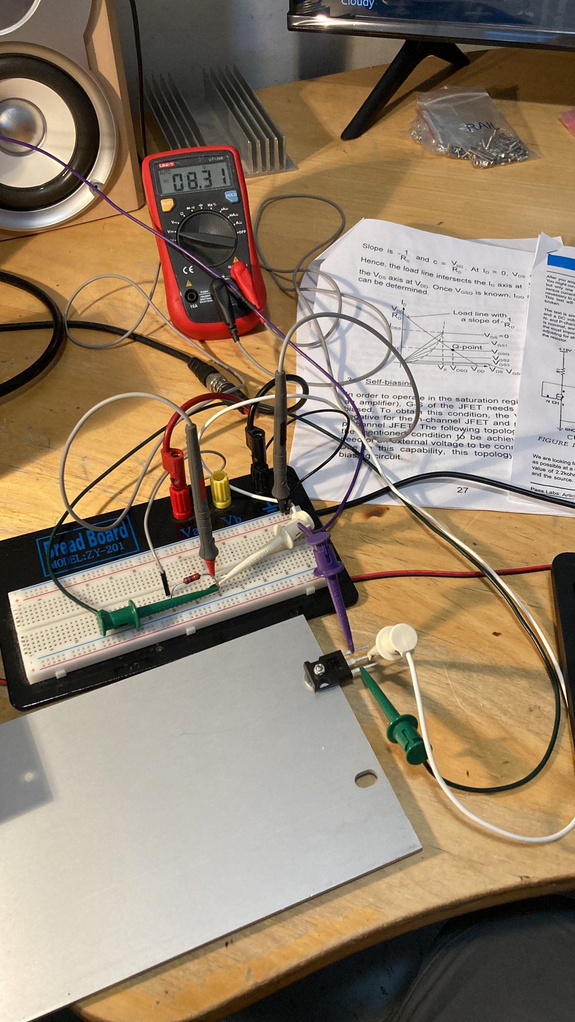

Hehe, I know it’s not pretty setup but i've double checked it and everything seems connected well. I tried another MOSFET IRF140 and I get 7.62v.
The circuit is not complicated here is a photo.
With IRFP240 I get 8.63vDC for VGS and across the 56 Ohm 2w resistor is 6.19vDC
Well, I am nearly out of ideas. I see that you have some power resistors. Use them to check your power supply to see that it is not limiting its output current. I can see the CV light is lit, but it doesn't hurt to check.
Here's another thought: measure the Vgs directly at the mosfet, in case the wires are adding resistance and dropping voltage.

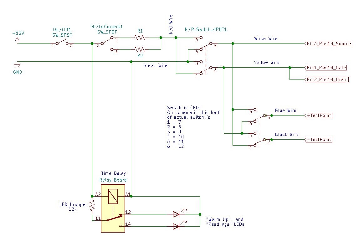

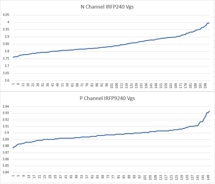

I'd expect Vgs in high 3V - low 4V range on the IRFP240. At one point I thought it was clever to graph the results of a batch I did. See the results. The last batch of 1000x 240's I did trended higher.
I made a matching jig based on Nelson's article. I've run a few thousand through this schematic. I forget the resistor values. Higher current is for 240 & 9240, low current is for 9610's etc.

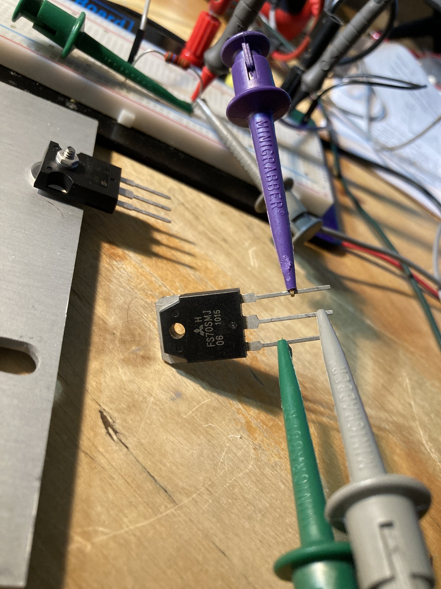

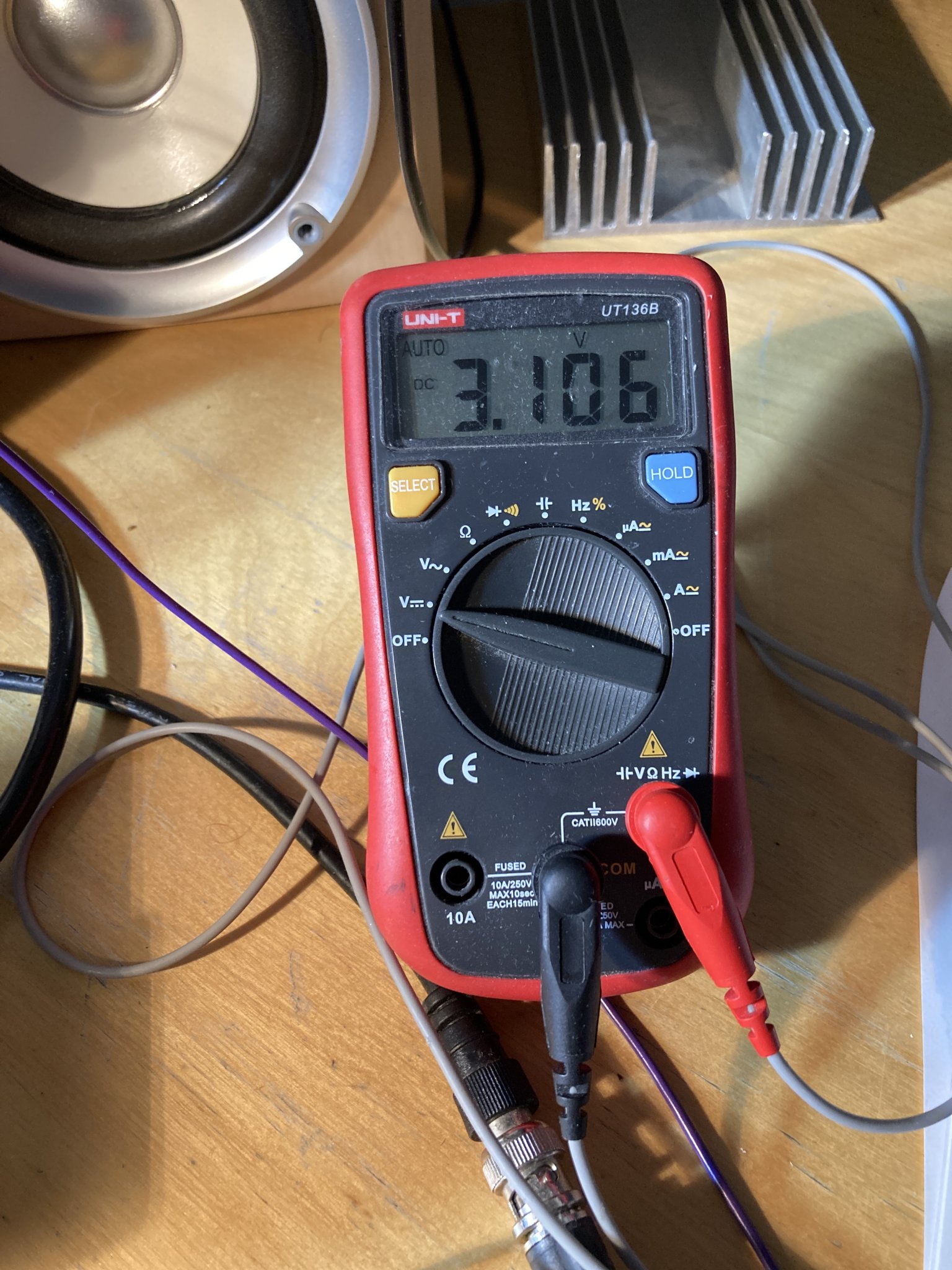

lol, this is nuts I spent all afternoon trying to get this little circuit working funny as it sounds... what I can tell its working albeit with some unexpected results:
I test 3x IRFP240 and all were between 8.2-9.0v VGS.
I tested 3x IRFP140 and all were between 7.5-8.2v VGS
More interesting is I tested 3x MITSUBISHI FS70SMJ-06 (used in vintage Sony ES power amps) 3.0-3.2v VGS
Those a wrong numbers - sorry. These parts have Vgs between 2 and 4 volts. Most I have seen were between 3 and 4.
Solved - I found that one of my breadboard jumpers was damaged/pin was blackened! Now I can get 3.86 VGS on one IRFP240.
