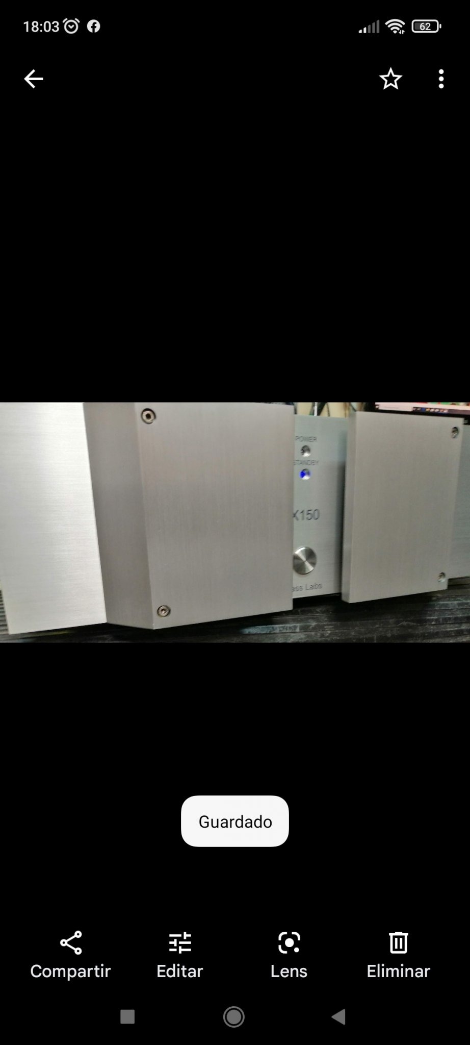

Pass Labs X150

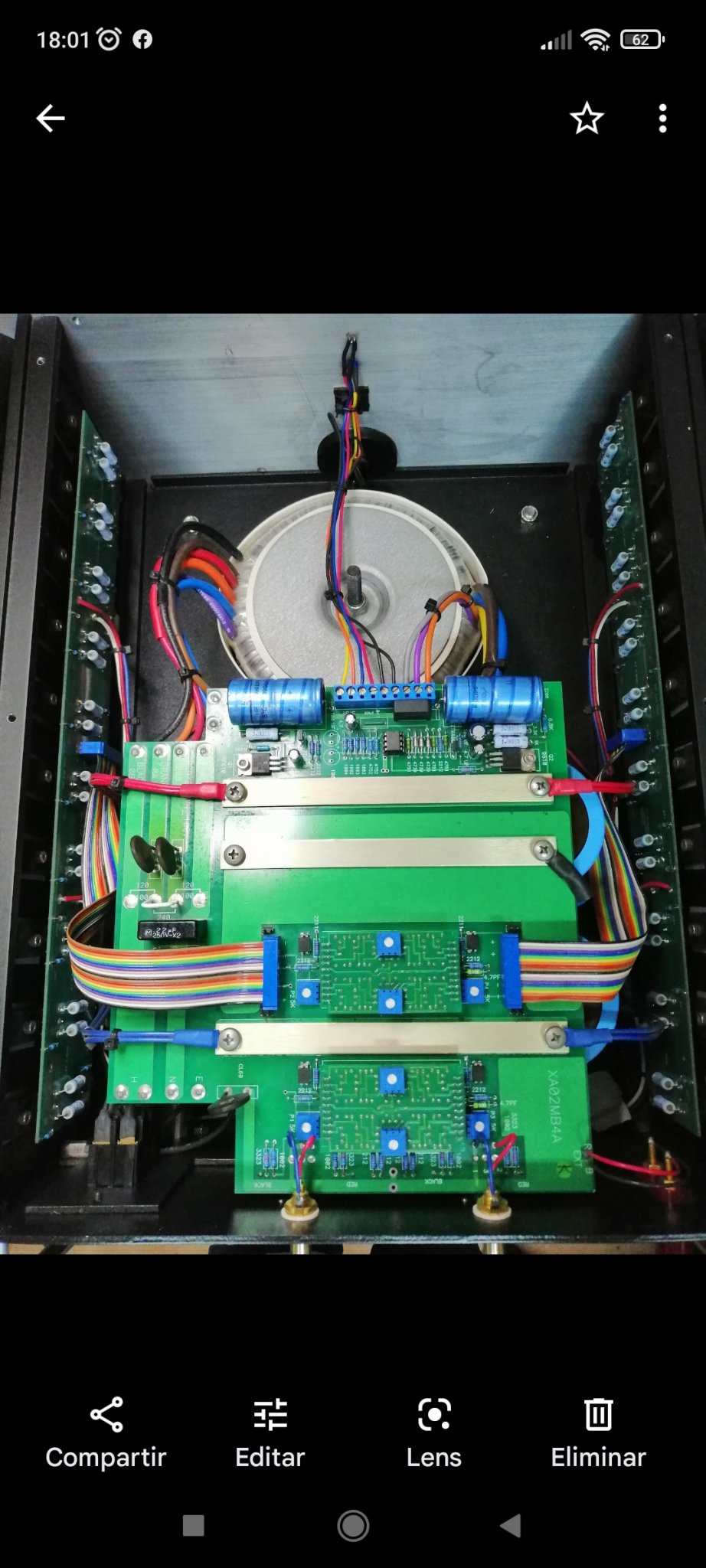

easiest way to do it is - cut one wire of each LED, insert 10K or even bigger value resistor, put some isolation
much easier than replacing LED resistors on pcb
btw. all LEDs are sorta same voltage, except special ones made for automotive industry, and these will not work with existing limiting resistors on pcb
or you can simply desolder one wire (of each LED) from pcb pad, solder resistor leg in pad, solder same wire to other end of resistor
that way you can even mount heatshrink on wire (prior to soldering), and put it around resistor and wire after soldering; Voila - neat looking
