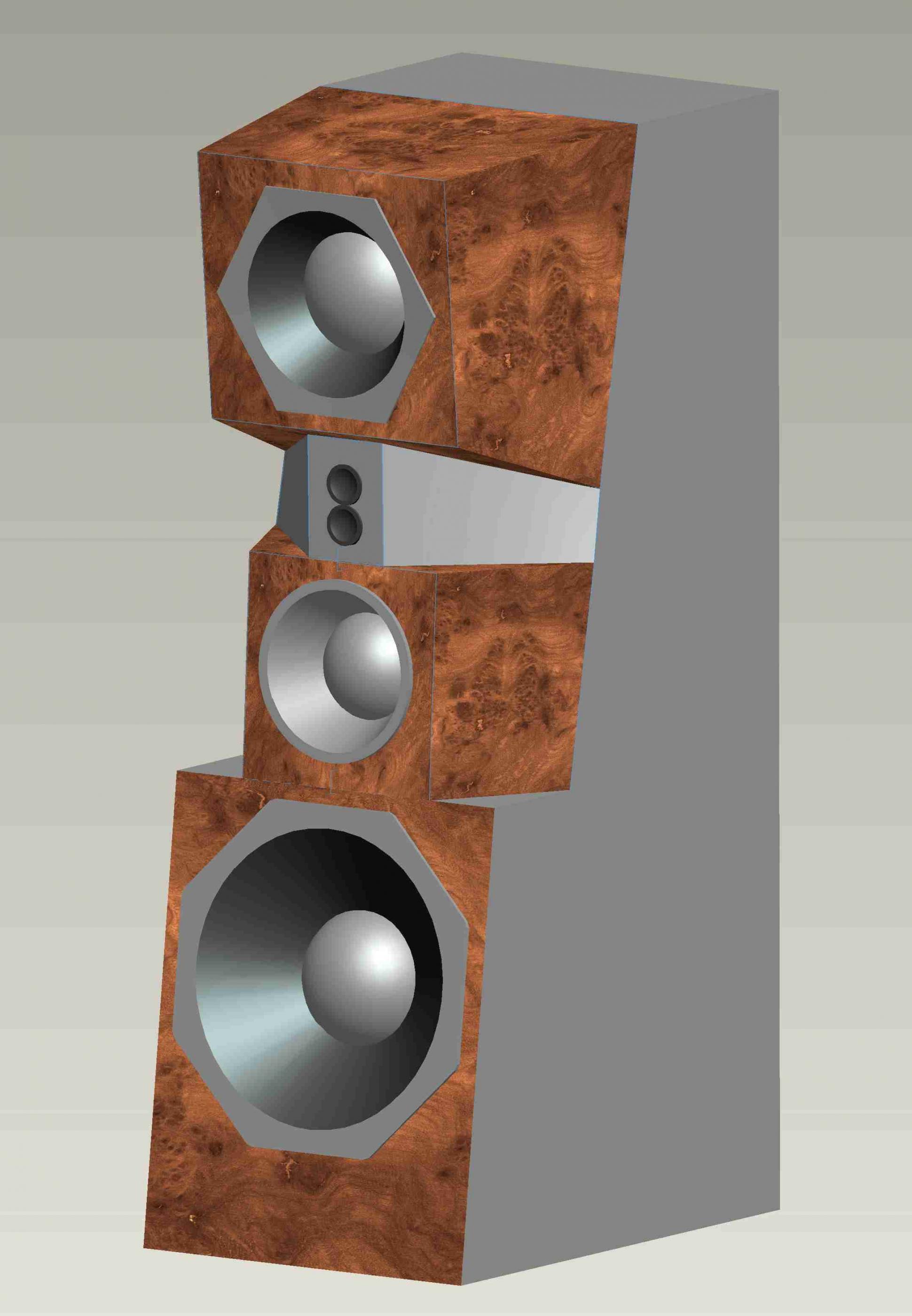

I have not used the TPL150 before, but Stig Erik (look for his dipole thread here) has quite a bit of experience with it. The vertical response of the TPL150 collapses above 3 kHz. I will use a conventional, rear-firing tweeter angled upwards to fill in above that. The midrange and midbass are PHL 1130 and 3440, both 16 ohm drivers with 96-98 dB sensitivities. The bottom end will be dual Beyma 12SW1300Nd front and back in a push-push-configuration. This also gives some ability to fight the cancellation from the wall behind the speakers. All drivers will be in closed cabinets.
To begin with, I'll run this "semi-actively" using a DEQX HDP3 digital crossover together with six Hypex UcD monoblocks I already have, three amplifier channels per speaker with two drivers per amplifier channel. The digital crossovers will go between the basses and the midbass, and between the midrange and the tweeters. I'll use a passive first order crossover to protect the rear tweeter, and probably a second order Butterworth between midbass and midrange. The two 12" basses will run in tandem with no passive crossover. That means that both 12" basses and the pleated diaphragm tweeter will be connected directly to an amplifier with no passive components between. The other drivers will see one or two passive components between them and the amplifiers. I can then fine-tune the frequency and phase response in the DEQX. I would really not want to make a passive crossover for these speakers!
Later on, I hope to move to separate amplifier channels for each driver, along the lines of the Rushmore itself, since these speakers really do not need a kilowatt of power per side. I'll still keep the amplifiers separate from the loudspeakers for flexibility, and will still have (at least one) DEQX HDP3 as the brains of the act.
As for progress, I'm done with the paper design and calculations, the drivers have arrived, and I'll start cutting wood shortly. Attached a preliminary rendering - we will see if I'm able to translate it into actual wood...

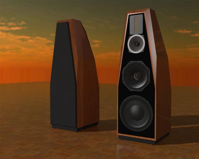

I will probably go for something like this, each driver in it's own box. More work but can help to reduce interactions.
Major part just for bass/woofer, around 140 ltrs, mid /bass around 20ltrs.
Cabinet made from 25mm mdf, well braced. I suppose not really a Rushmore clone, more a

This is my take on a similar speaker to the Rushmore .I have heard PHL drivers in 2 ways,3ways & 4ways active & passuve ,two with Raven ribbons and the 4 way with out I liked the sound very much . My will be active but the drivers will be driven by 300B SET amps I'm building .I'm looking at using a F5 amp on the 15" PHL 5021 bass driver .
The drivers I'm using
Raven R1
6.5" PHL1120 ,very nice match the the R1
10" PHL3020 ,mid/bass
15" PHL5021 ,bass
15" alloy baffle & driver
One of the mono300B SET amps I built ,the xover values are part of the amps signal circuit.
