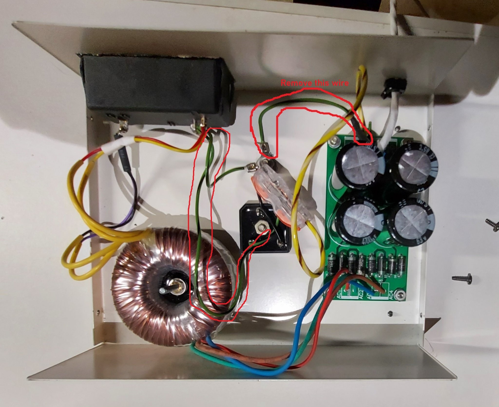

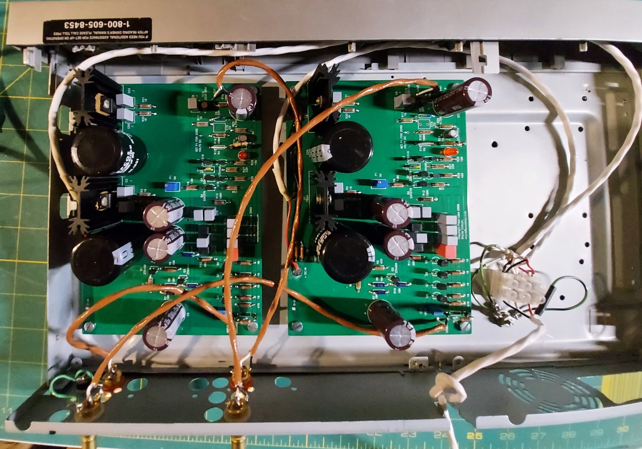

I recently put together the PassLab Pearl 2 phono preamp from the mail order kit and am getting a consistent hum coming in both channels. I remember reading in multiple forums that you need to get the grounding issue right, but they never tell you what issue they were having or how it was resolved. I also separated the power supply from the left and right channel boards by a meter long shielded cable (3 conductor plus braided shield), to no effect. The Pearl seems to be very sensitive transformers in close proximity. Moving the main unit away from other equipment helps a little, but doesn’t eliminate the hum completely. The main case is steel and the front panel is plastic. The phono input shields are grounded at the inputs. The DC power cable shield is grounded to the power supply case and to the preamp case. Any suggestions or is anyone else experiencing this issue? If you get past the hum the phono preamp sounds really good.

Hello Ben, thanks for your response! Here are some photos where I separated the boards from the power which did not eliminate the hum...
A few issues:
1. Power supply: Looking at your picture of the power supply, Ground at AC power has two green wires. One goes directly to chassis ground. The other goes bridge rectifier for ground lift. From bridge rectifier there is a yellow wire with stripe that goes to PS board ground. There is also a green wire from PS board ground to chassis ground. This wire needs to be removed. The PS ground should only connect to the chassis ground through the bridge rectifier.

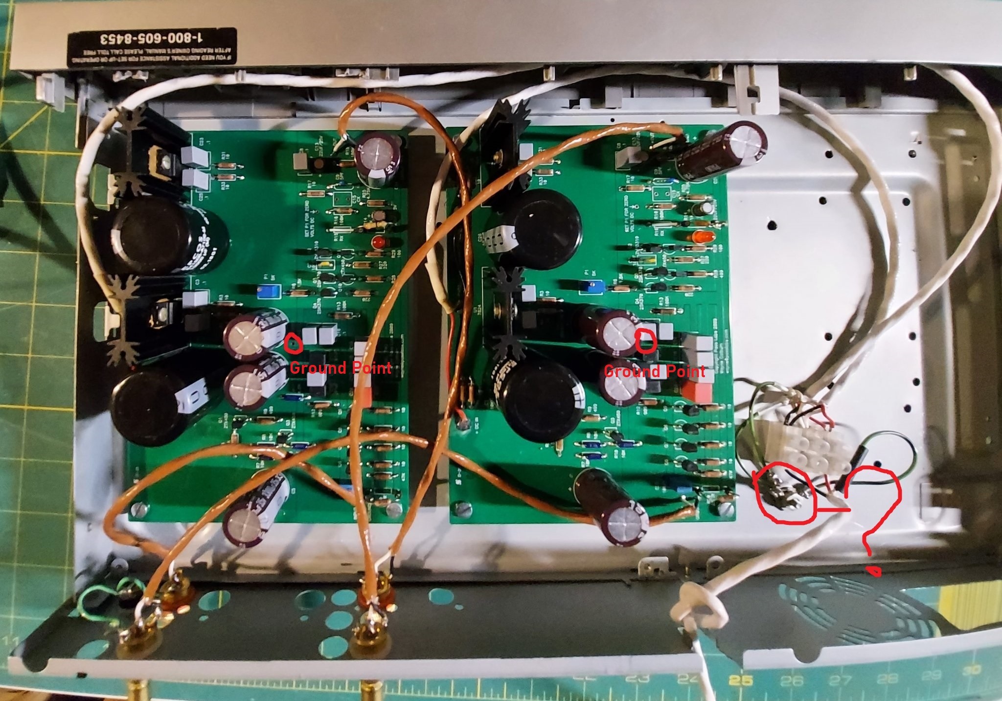

2. Main board and chassis: There should only be one Ground point on the chassis. At the power entry there is a ground point to the chassis and it is not clear to me what is connected to it. The V+, V-, and Ground from the power supply should go directly to the main boards.
The RCA connectors should be isolated from the chassis and connect directly to the main boards. Check to make sure that they are isolated.
As mentioned, there should only be one ground point. Only the turntable ground and the ground from both boards connect to it. The ground point on the boards is between C4 and C12.
Well Ben Mah, I wanted to give you a BIG THANK YOU for helping me figure out that grounding issue with the Pearl 2. It really wasn't clear to me from the directions (instructions) provided when building it. I still have a little hum but I think that will get cleared up once I get a new case. Thanks again
