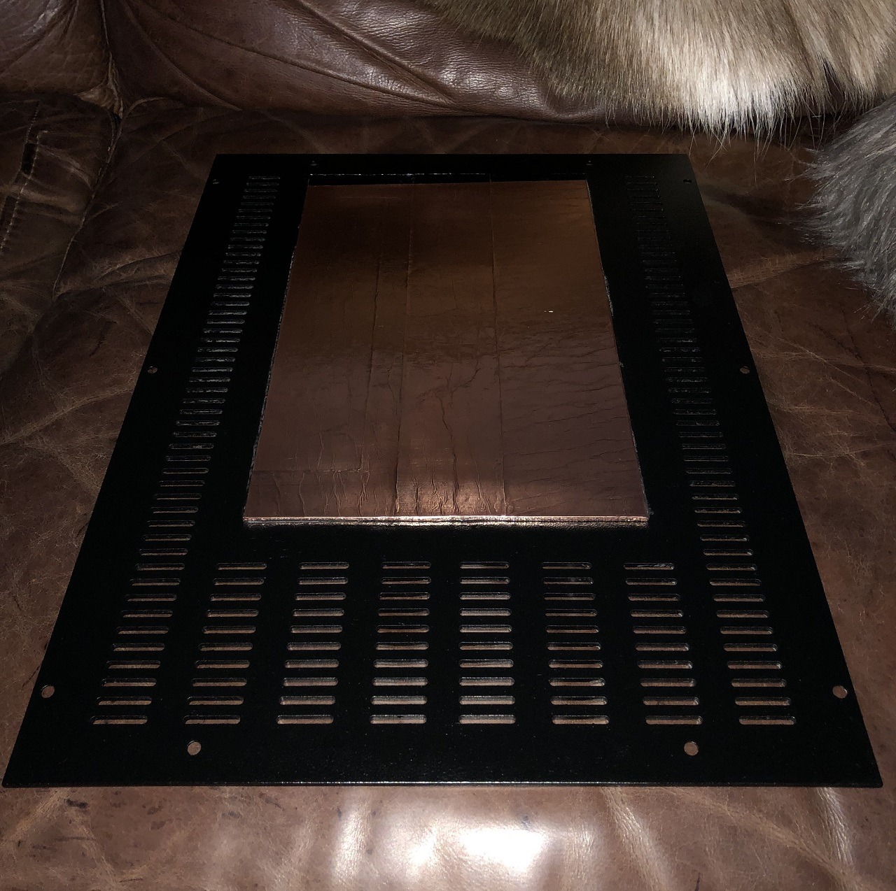

Next, dealing with the rather resonant steel top cover.
This was done with Monacor MDM-830 bituminous felt, it's around 4mm thick and perfect for the job:

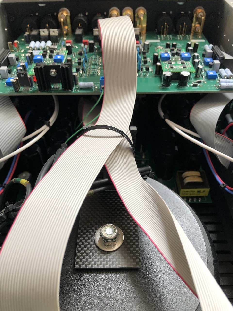

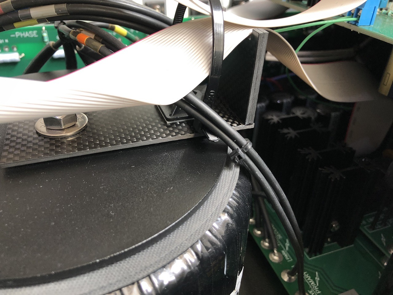

The other mod is more aesthetic, a bit of cable dressing:
fabricated from 2mm dry carbon sheet
