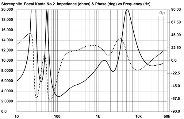

There is much to admire in the Pass Labs INT-25's measured performance. However, its intolerance in the treble for loads of 4 ohms and below means it will work best with loudspeakers whose impedance doesn't drop below 8 ohms at high frequencies.—John Atkinson

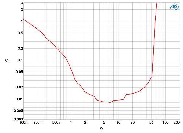

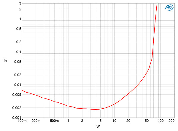

How can this be, Stereophile distortion measurements
left XA25 right INT-25
Incredible difference, what went where wrong?
