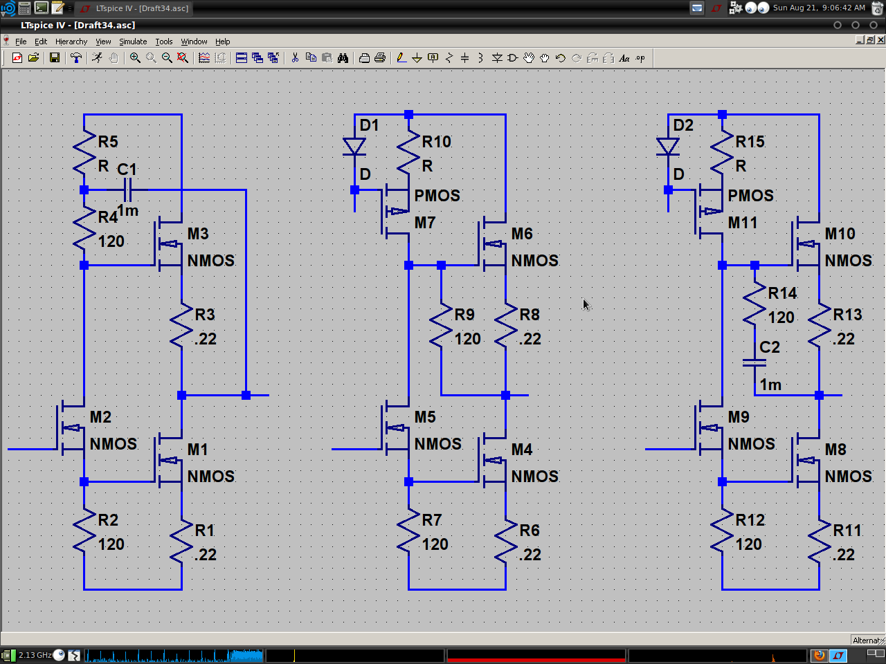

Here are some examples.
The first is the simplest. The compensation resistor, R4, is integrated into the bootstrap. Because the current through this resistor will mirror the current through R2, it's voltage drop will also be that of R2, to the Vgs of each output will be balanced and the outputs will equally share the load.
In the second, the CCS is still used, but it will have to have twice the VAS current because it must now also provide the current through R9.
In the third example, there is a cap in series with the 120R resistor, to block DC so the CCS current can be decreased. Overall, the first scheme should appeal for it's simplicity, and the second scheme should appeal to those who dislike caps. I don't know why anyone would use the third scheme, but it's an option.
Also, the .22R resistors you have placed on the drains of the upper outputs are not doing anything helpful. They should be placed at the sources instead, like in my schematic.

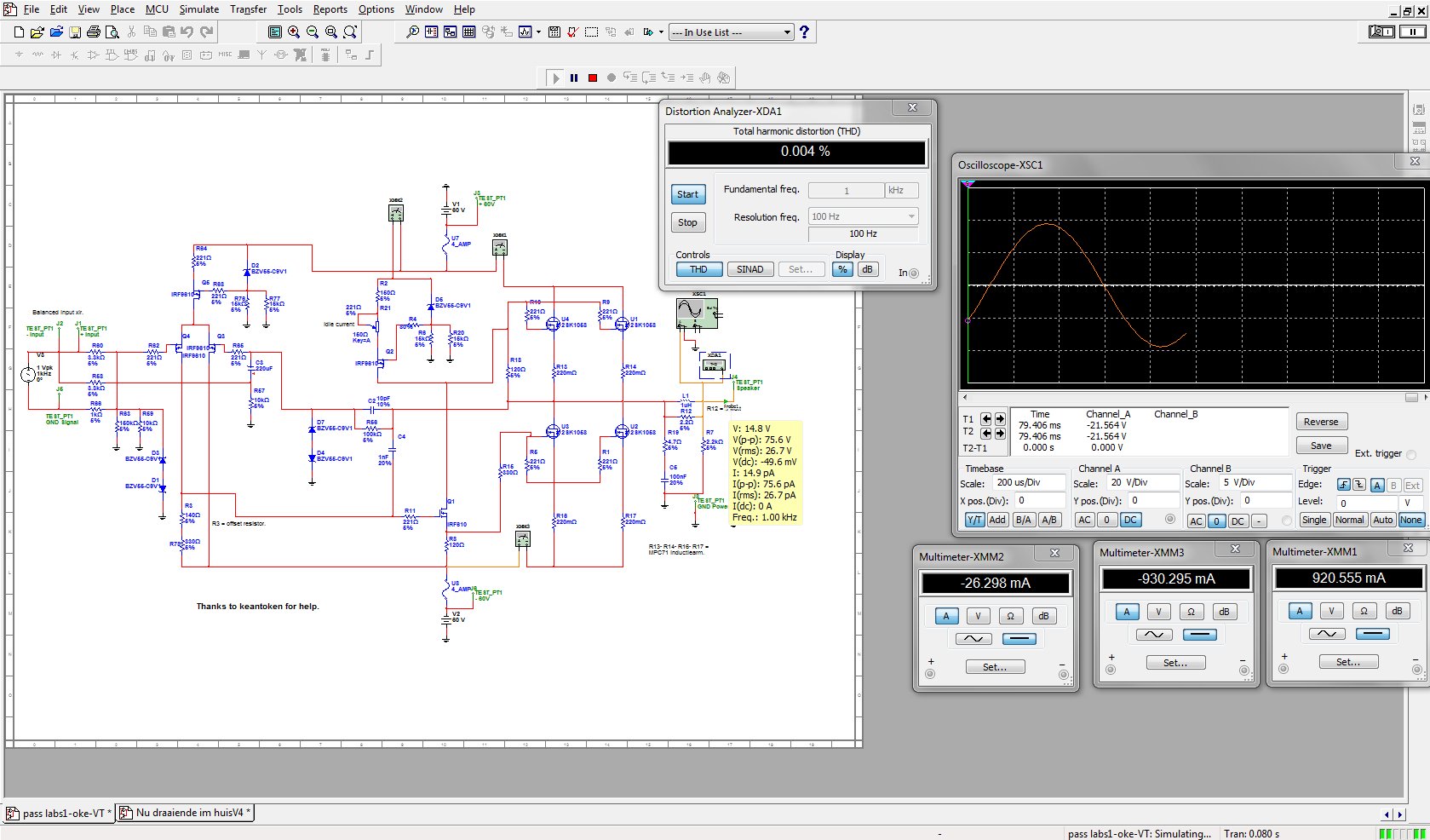

I have tryed i, I have used your middle solution on picture without a cap to keep current high for driving mosfet gate.
I have discover that simulation of that quasi thing is not so easy, for multisim it is a strange circuit, however I have nice specs, but fake the load, so I am not shure, with 8 ohm it collaps what is strange for a mosfet,.
Your gate stoppers for the lower MOSFETs are connected incorrectly.
Also, C4 should be connected to the drain of Q1, unless there is a specific reason you're doing this.
D7 and D4 will cause large problems, if these conduct the output will clip to the rails. They do not protect anything I'm aware of, and their junction capacitance may worsen amp performance.
