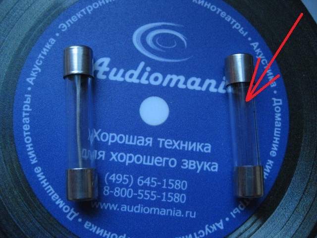

There may indeed be a problem in the amp... unclear to me from the discussion if these are power supply fuses (B+/B- rails) or if they are line (AC mains) fuses? IF they are the B+/B- fuses, AND they blow on ONE channel, then it is likely there is a fault or broken channel. If it is the mains fuse then IF it is the proper value and still blows then OPEN (remove) ALL of the B+/B- fuses and try again. IF they still blow then you have to look at the power supply for a fault, either a shorted wire (come apart in transportation) or else a fault in the rectifiers or more likely a shorted or very leaky power supply cap.
In the event that you can not find a SLOW 2.5amp fuse, it is possible to substitute a "FAST" fuse of somewhat higher amperage rating. You lose some protection, but not much. I would use a 4amp or 5 amp "fast" fuse as a substitute - at least for TESTING.
It is a good idea to go with the recommended fuses after you find out if the amp works, and you just had the wrong fuse, or that the amp has a fault and is broken.

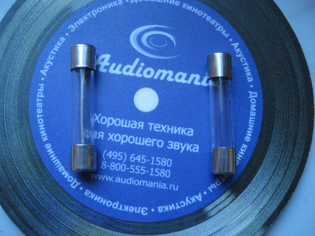

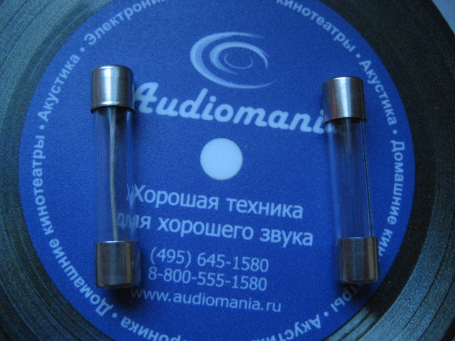

original fuses seems as slow blow
later bought ones seems as fast ones
it's hard to follow , considering that OP is using Google translate , so I can't be sure what goes first , what second
I bought a slow fuse, the other is not there.

I put a quick fuse with a higher amperage.
The amplifier works fine.
I want to have power protection, so I'm looking for the original fuse.

My x150 is listed as a 2.5a slo @240 vac.
Some **** stuck an 8 amp in it before i bought the amp.
I replaced the fuse with a 2.5a slo 'littlefuse' from element 14 (farnells).
My advise.
Get a 2.5a slo from rs or farnells and be happy its the right rating and style.

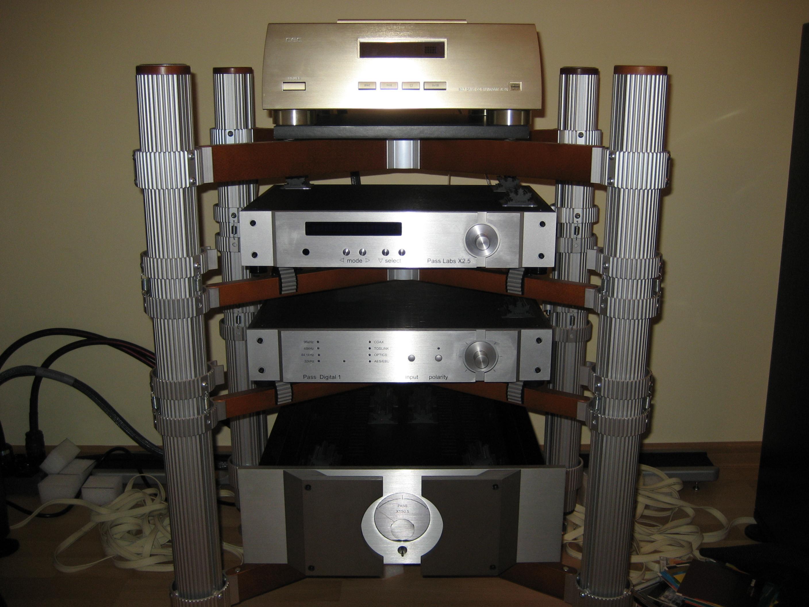

It would help if you sent a photograph of the front panel (and also the back panel with a clear well focused detail of the information there including the serial number. On the assumption that all you say is correct I am sure that Mr Pass will help you. Without FULL information, including serial number and if possible receipt for apyment along with pictures of the amp I would ignore your requests.....[Mr Pass - and other makers - have had a lot of trouble with people attempting to make direct copies of their work and then selling them as 'the real thing'!]
