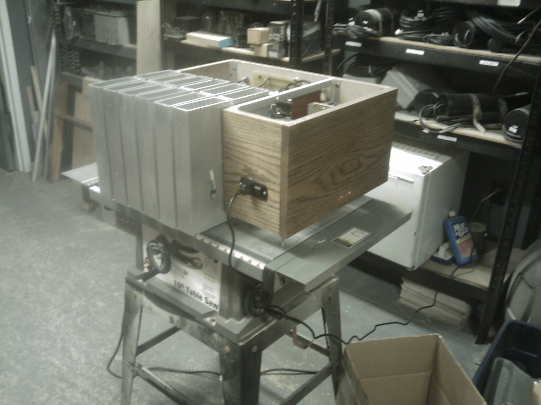

pic of amp or relay cir?

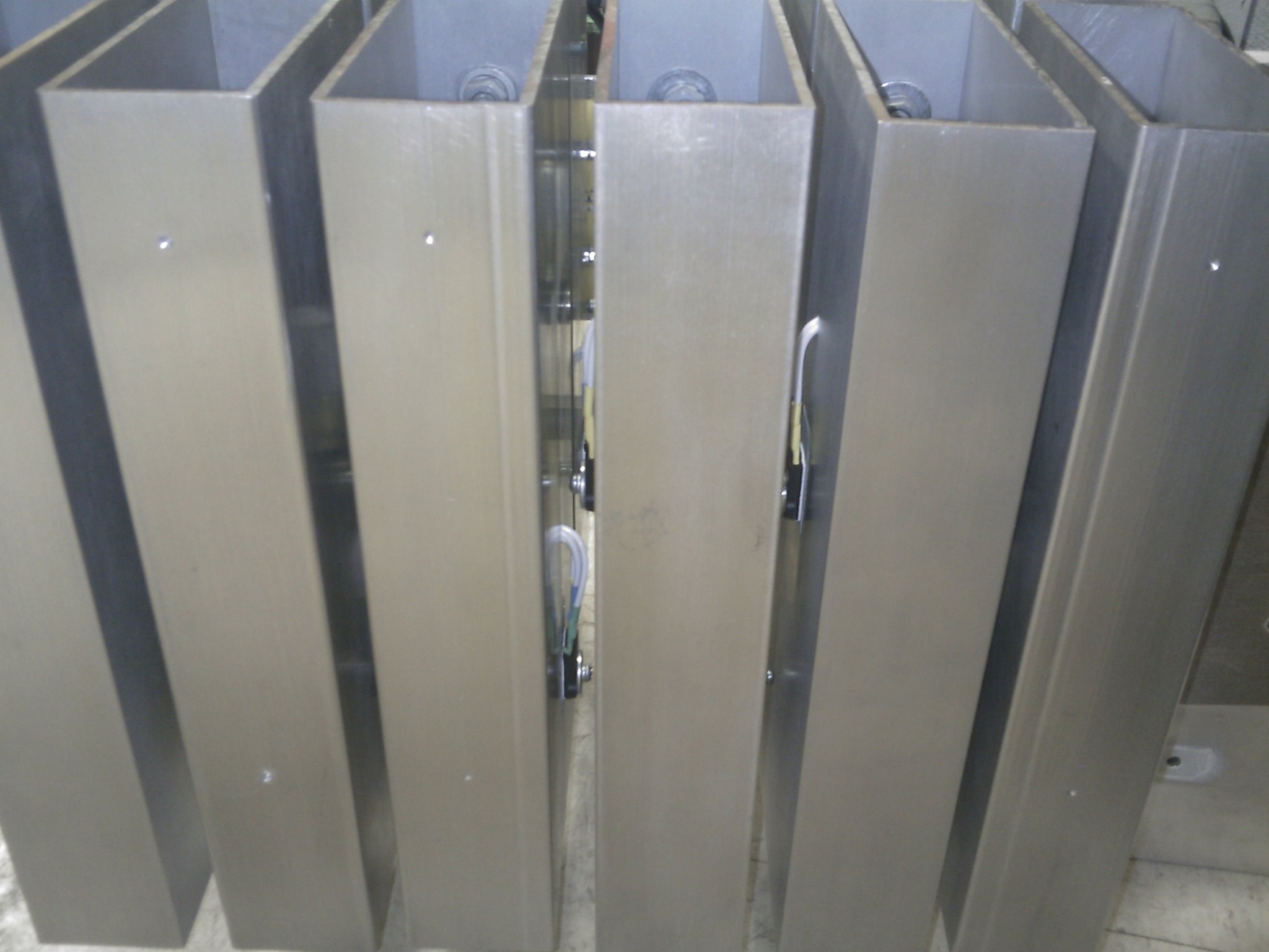

ive got my notes and my multisim scematics if you want them. amp pic here i go....to try to post.
these are of the first block at my office without the top

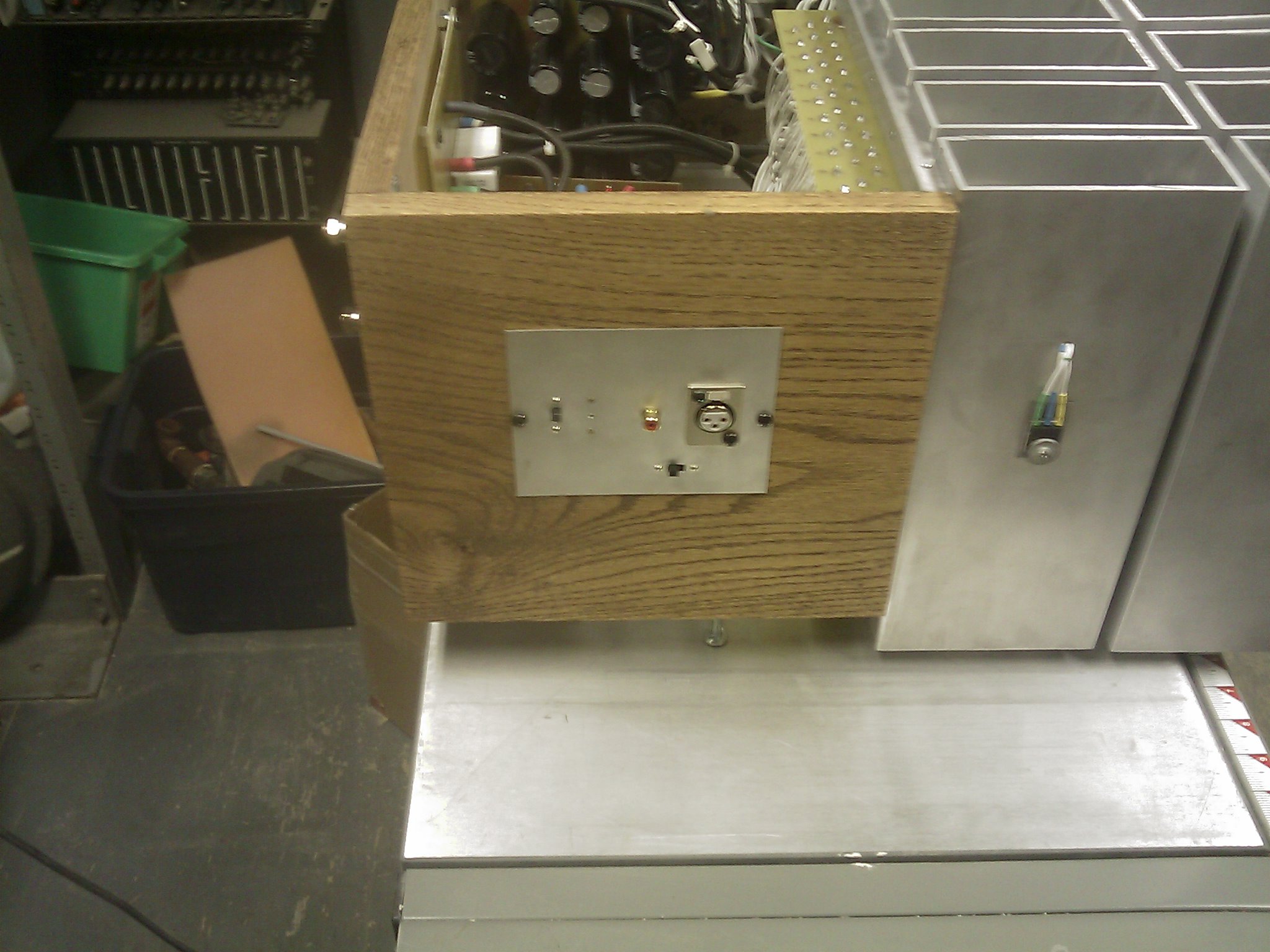

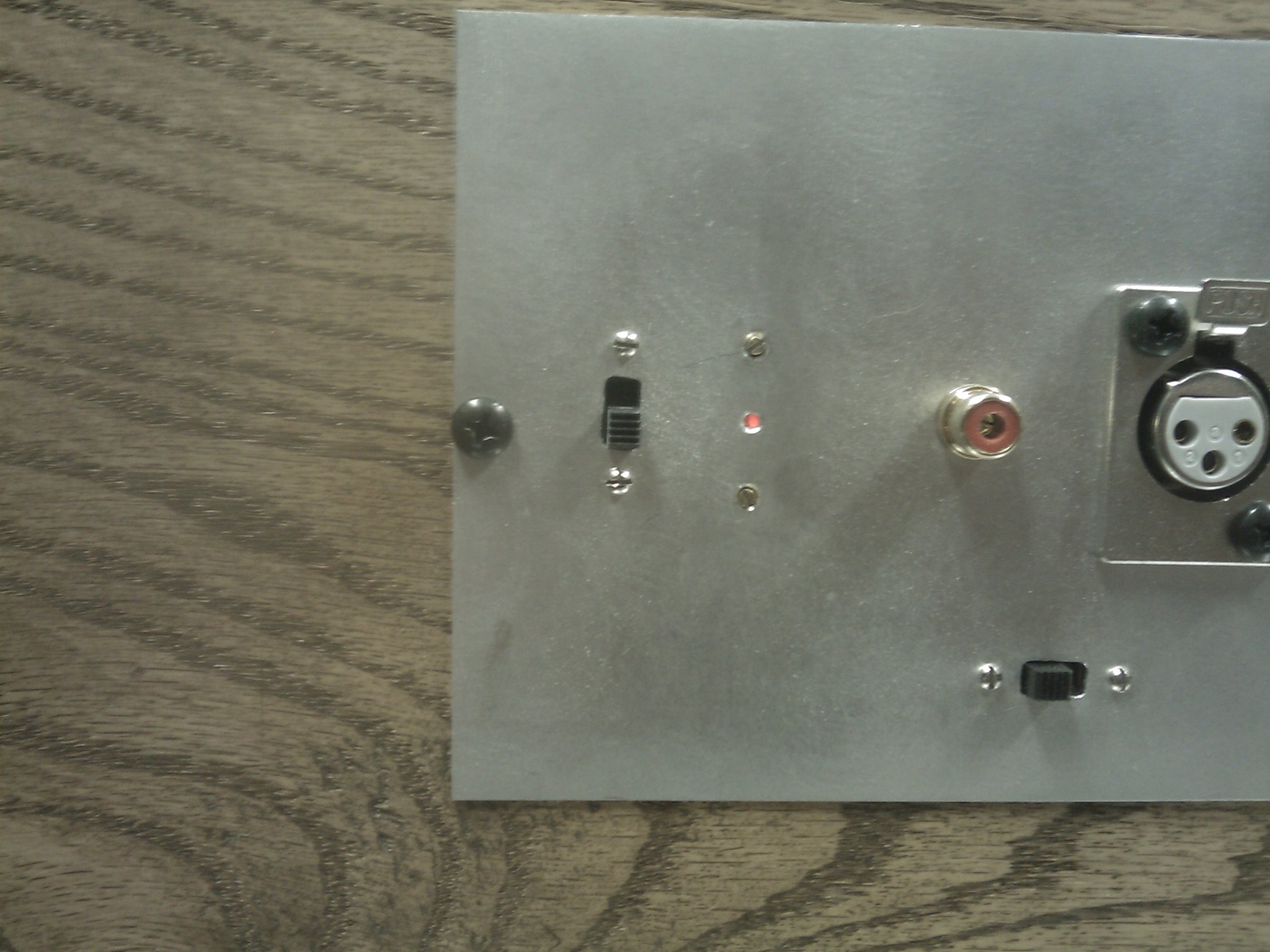

closeup of input panel

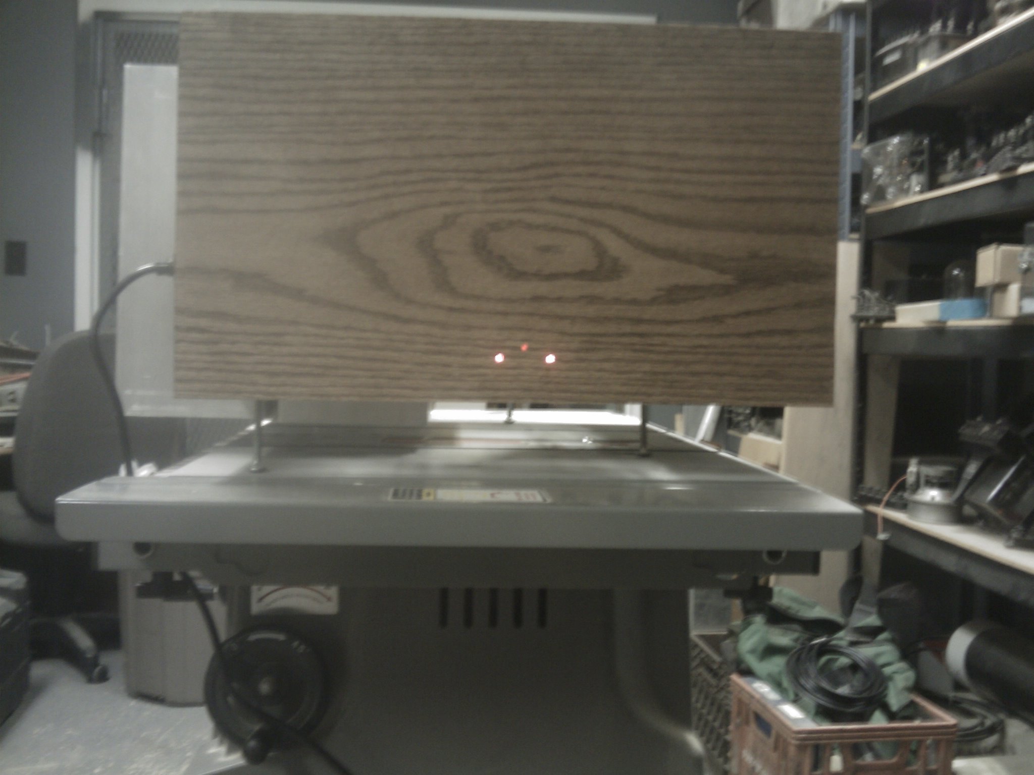

bias switch... up is normal, led turns green....down red. the next pic will show 3 leds on the front. outside 2 are fuse indacators middle is the same as this one on the rear.
pots acsessable are the fine ajustment for the bias. course is on the board inside.
this was before i drilled the hole for the conector that makes it slave off the preamp.

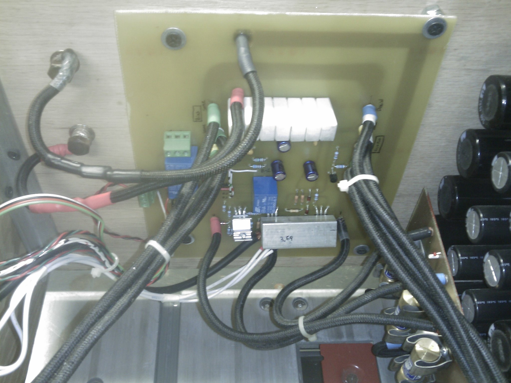

main board......the empty molex conector top left above relays is the pre input to turn up the bias. leaving the switch in the standby postion allows it to be slaved. 3 relays......if i remember right.......1 to select color of leds.
2 to bypass the switch (preamp in) and pick the 3rd relay in the middle that is the bias changer majigger. it all worked on paper and now for real.....but havent thought much about it. i have all my notes.

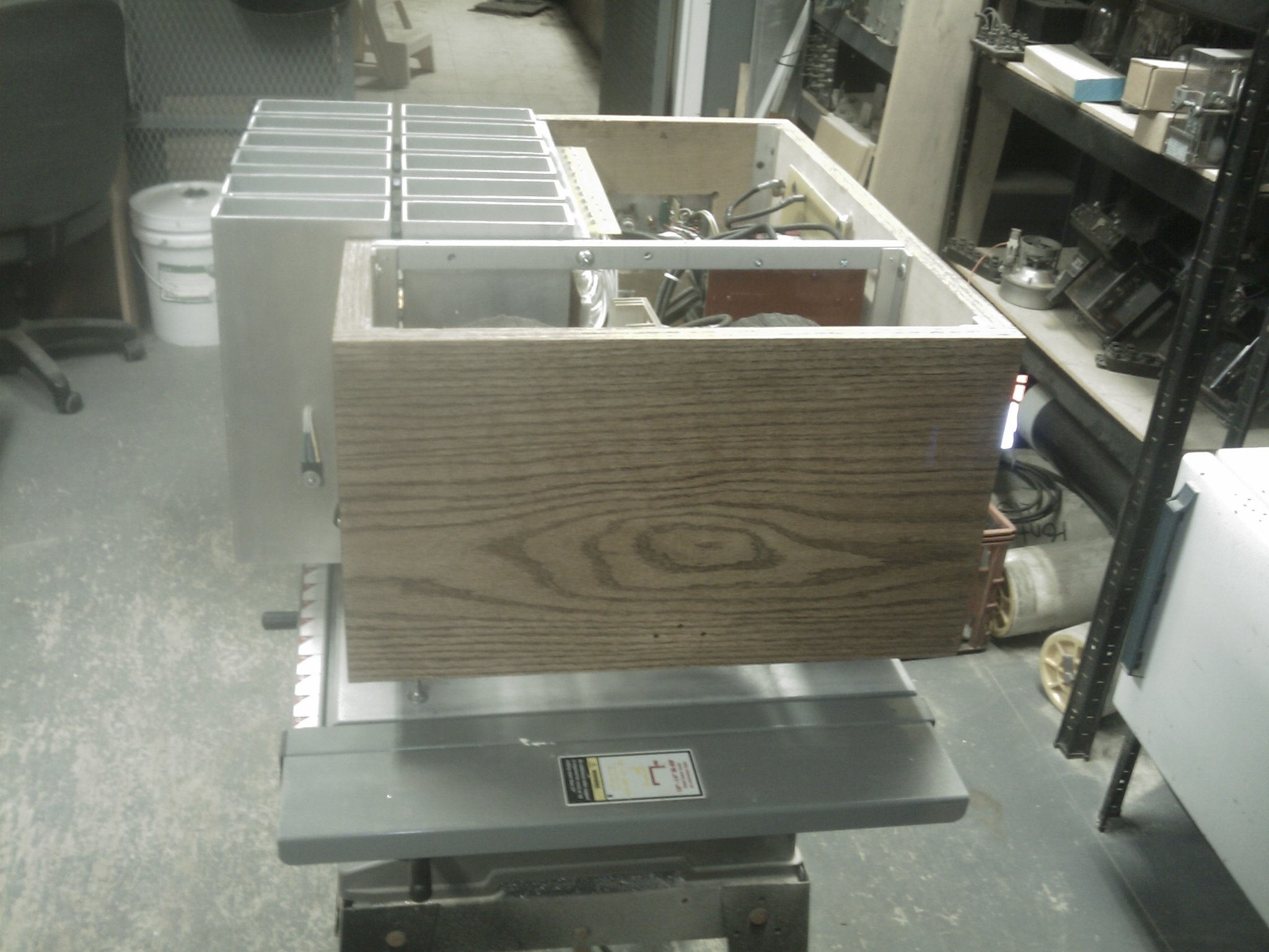

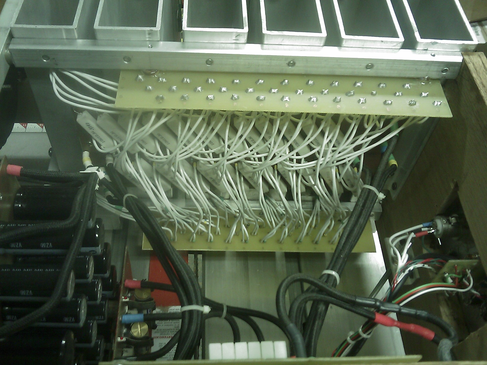

fet spacing on the sinks. 2 fets per sink. each sink has 1 fet for current source and one output. sounded like a good idea at the time so heat would be more uniform to to bottom of the cir.........dose it make a diffrence? i dont know. but it sounds good huh? like my first marriage...sounded good at the time. i was worried about temp diff. from one fet to the other, cause they are all seprate, but i found that the diff in sink tep varied only 5degc @ the extrem most only 1 or 2 deg......dose that affect sound? i dont know. sounds good to me.
this one is the right chan. left chan is mirror image so the sinks face out from the speakers. i did it like this so it could sit right next to the speakers.

Thanks, sakellogg! (I guess you also get a discount on aluminum? -- Those rectangular tubes remind me of NP's BA chassis...)
I think I can imagine the bias stand-by relay circuit.
yes thats where i got the idea.
tubes are from crossing gates that have been hit. i cut out the unusable part and save the rest. i got the OK from my boss. otherwise we throw them away.
