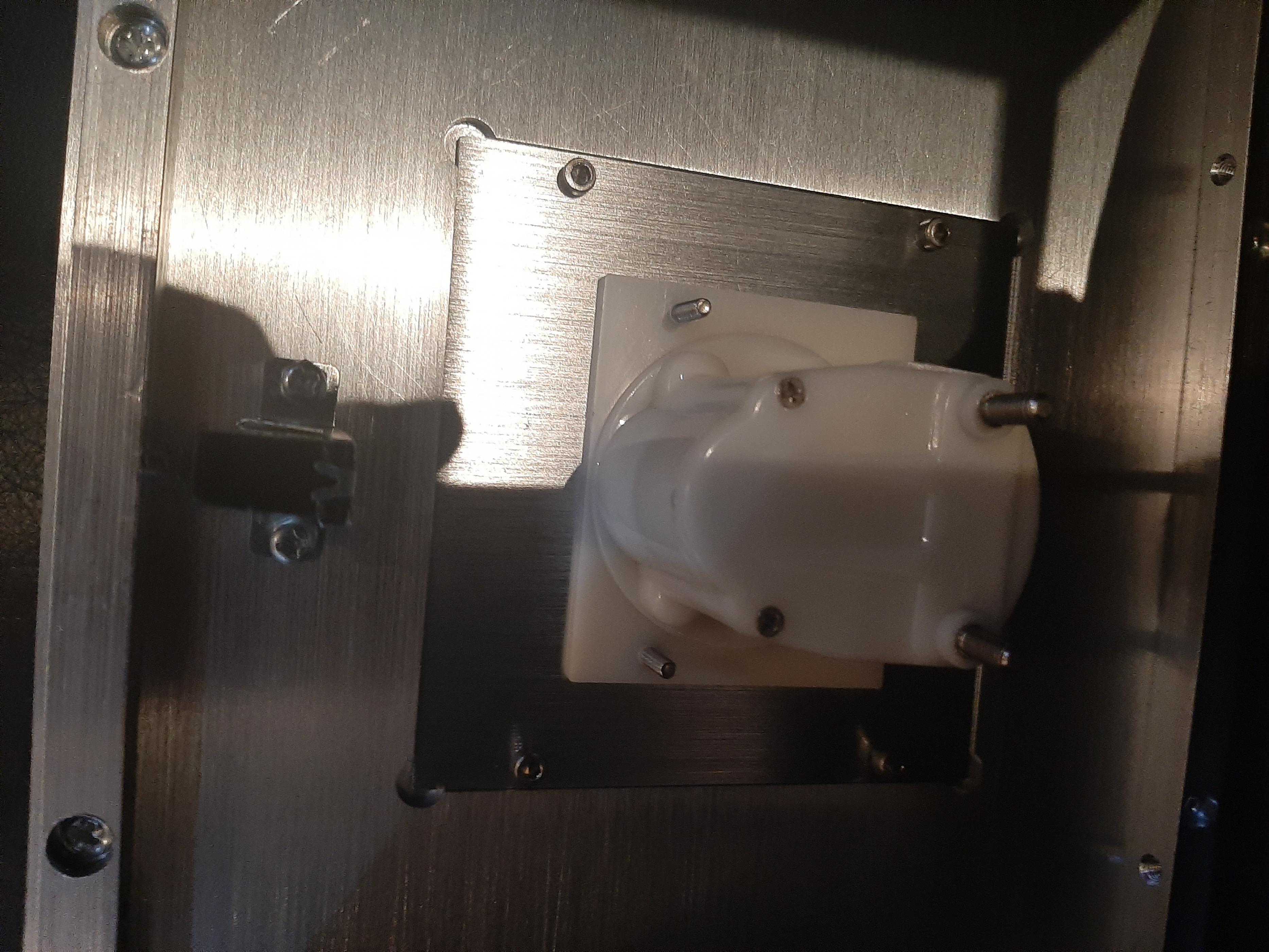

That's as far as it goes. Rest is pop rivet

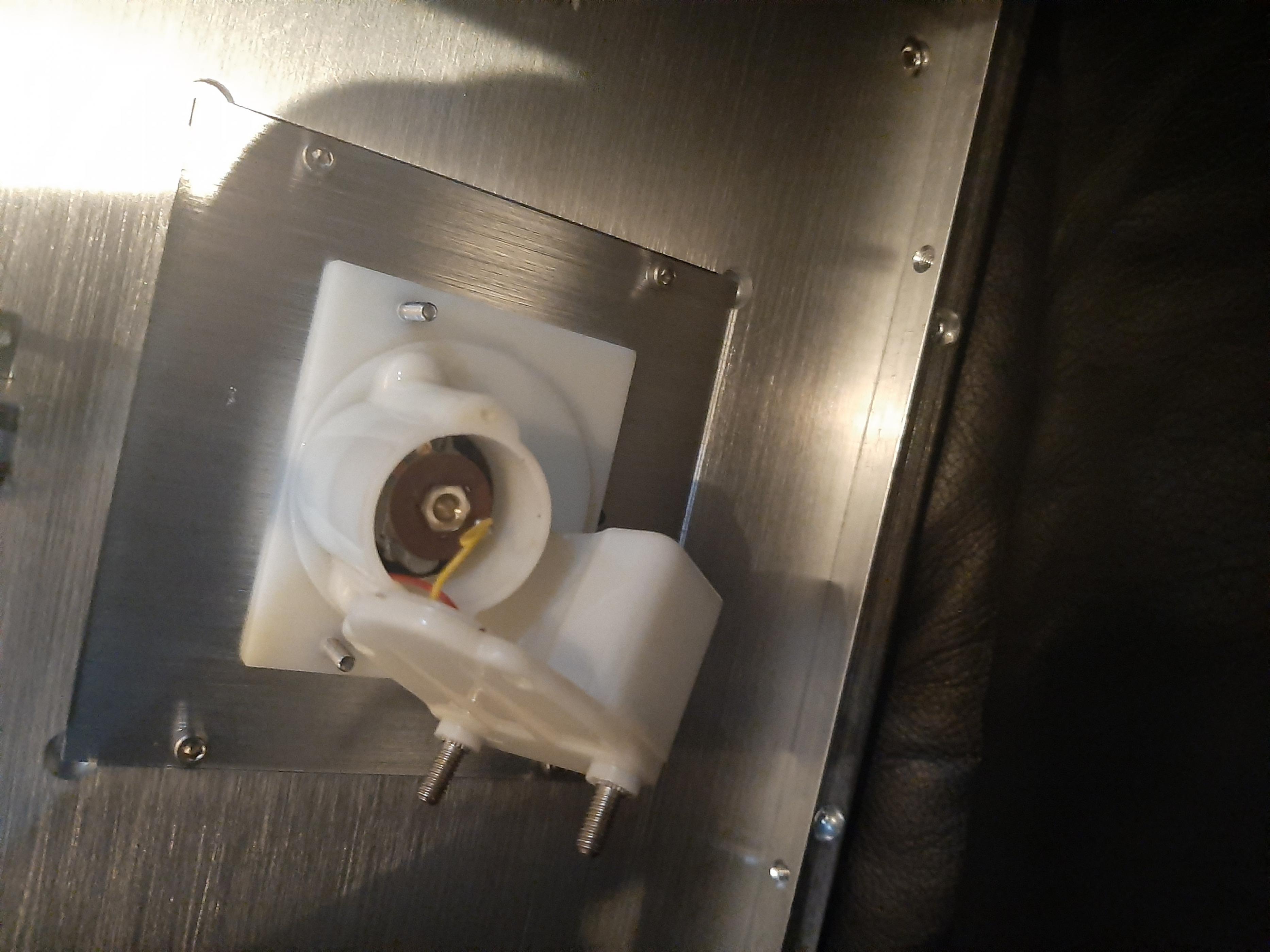

is there something (some funny electronics) contained in that little box behind those M4 screws?
what you did open is meter mech. itself and we aren't interested in that , but in fact is there anything between contact screws ( two M4) and meter coil itself
have you any Rdc reading at these screws?
if they're directly at coil , when you try to measure Rdc , needle will move
check Rdc with ohmmeter
if no other way ( you can't read Rdc of coil itself) , just cut those wires (yellow and red) furthest possible , drill small hole at back of instrument and route them out
solder some extension wires on them and you have your instrument ready to connect to whatever you want

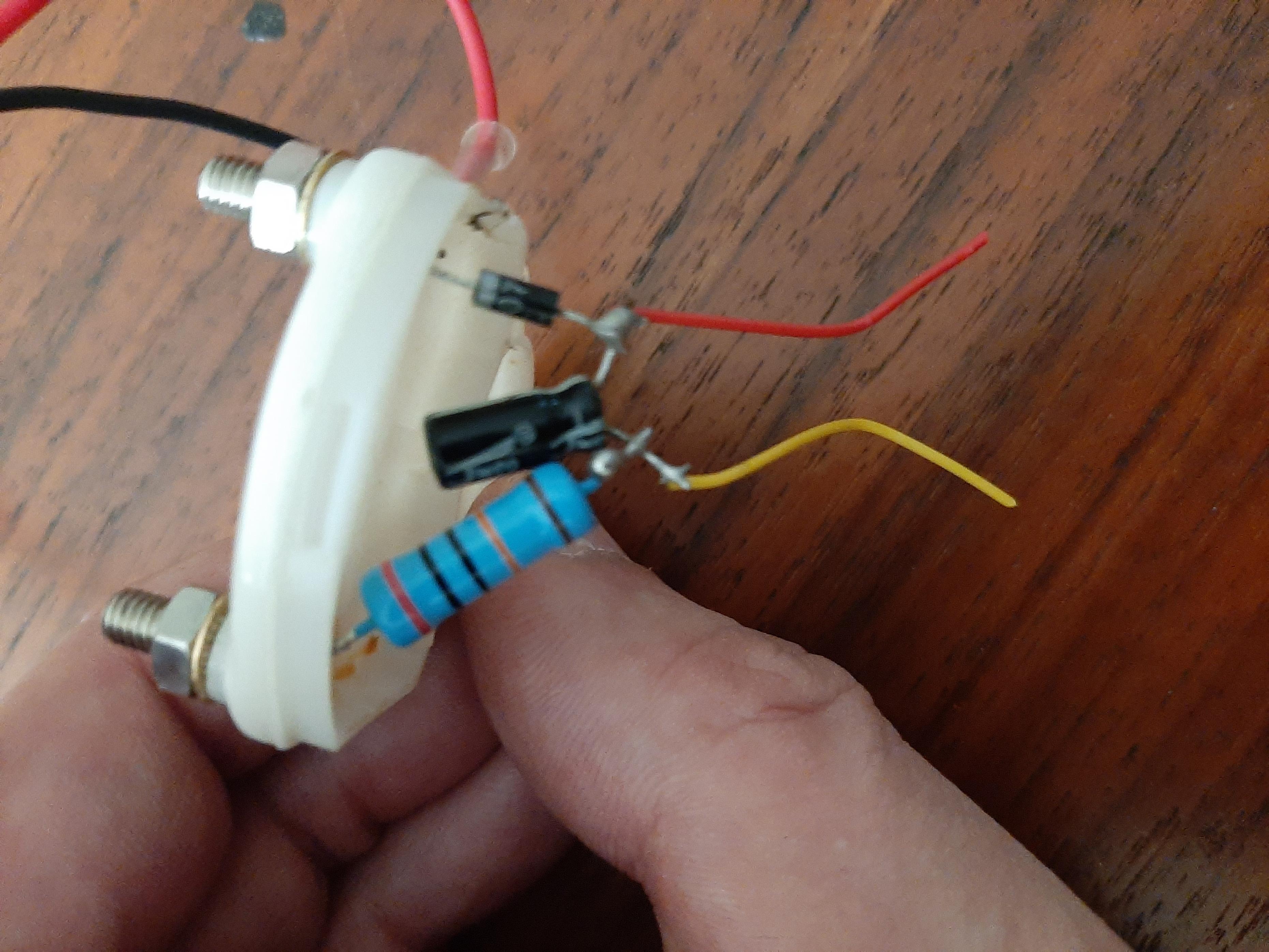

remove everything shown inside (resistor , cap , diode_
solder coil wires to output terminals/screws and close it

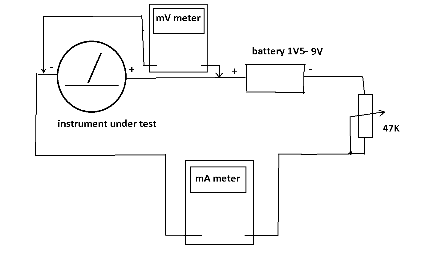

make test circuit by attached sketch , start with maximum value on trimpot, fiddle with trimpot to get full tilt of needle , then write down current and voltage
after that we have all data needed to implement it anywhere
