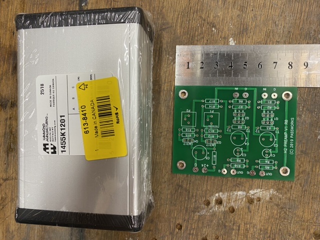

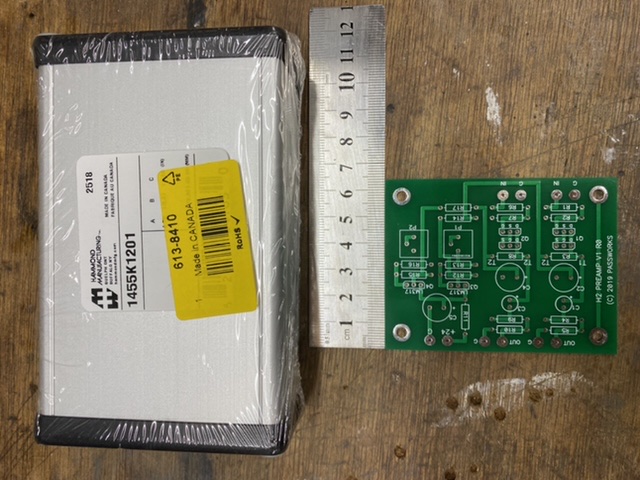

Hi Marty, as NP still works in inches I believe, the pcb is 3.25" x 2.5" or in our language 82.5mm x 63.5mm.

Affirmative. I’m going with the 75mm wide Hammond case pictured. I’ll be trimming ~8mm off the end with the print to be able to slide it in. I’m also putting a 50k Alps blue pot on the input.
No matter what you are building or how simple or complex the circuit might be, it does definitely pay to measure all resistors with a DMM, to check they are OK and are within the tolerance range or indeed are not incorrectly marked with the colour bands - this has happened before, so I strongly agree with Nelson's point in his post.
