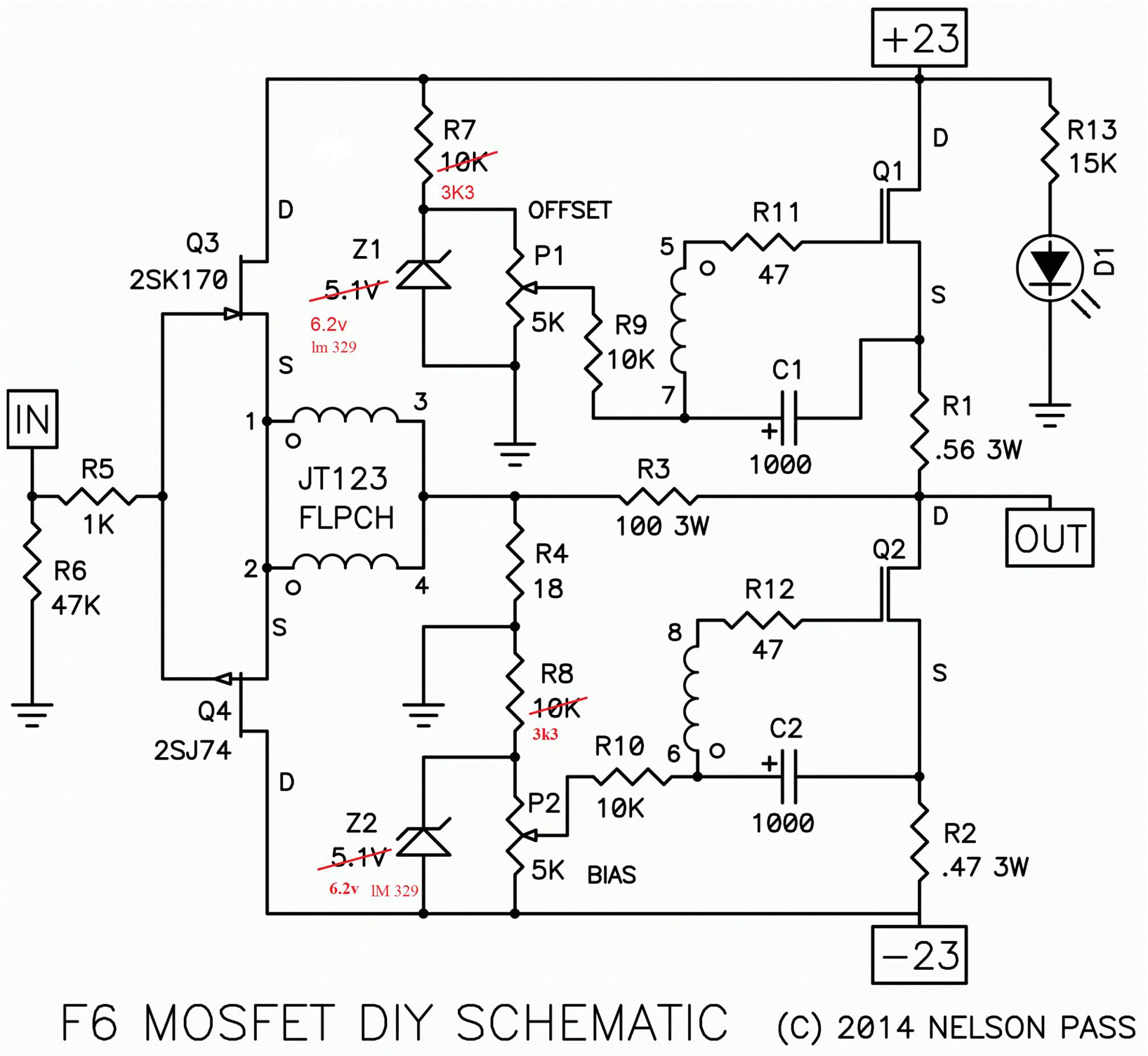

Since you are a new builder let's re-state some of the guidelines.
Buy good components, from mainstream suppliers.
Buying components, especially the transistors from E-bay is likely to result in fake components and failure.
The J-fets (Q3-Q4) are very important, and difficult to find. The store has good quality equivalents in the right grade.
There is a mod to the zenner diodes that makes bias more stable. This is very much worth doing during the build.
See the mods on the circuit below.
