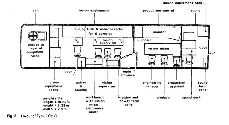

Aunt Bebe designed them for tight spaces... first installed in the type "#2" color mobile control room, or watching GMA in stereo during the morning constitutional. No loo on the their bus.
