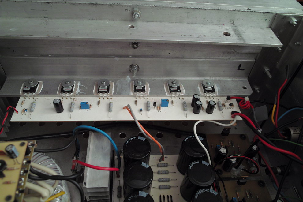

sorry for not replying earlier, I've been busy with another project.

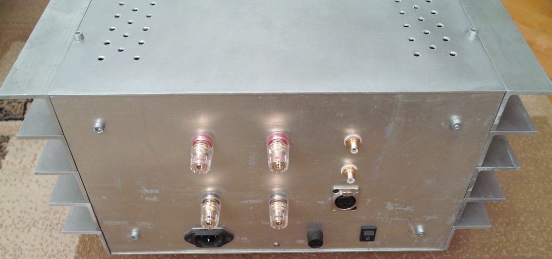

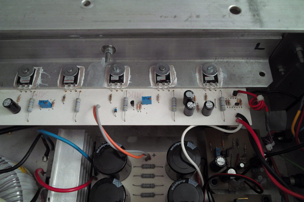

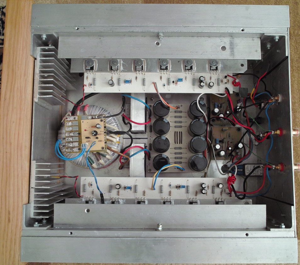

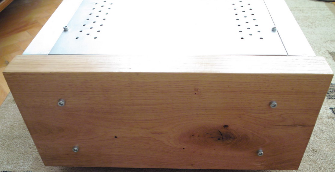

here are some pics of the thing. it may look weird for some with the oak front panel but I only call it different. those are not actually heat sinks but pieces of L profiles. kind of neat if you ask me, considering the price of a readily built heat sink. it may not ensure the perfect heat transfer at joints, surfaces not being 100% flat and all but the transistors stay below 65 Celsius for some 2-3 hours of uninterrupted service. it screams DIY and that's what we're here for :)
it weighs 21 kilos. there's no label for power rating on the tranny but it's 6 cm tall and 14 cm outside diameter. the thing sitting on top of it is a fan controller, you can see the green thermistor hanging near one of the output transistors.
there's 4x22000 uF of filtering per rail (label says Rubycon but nowadays that don't mean much).

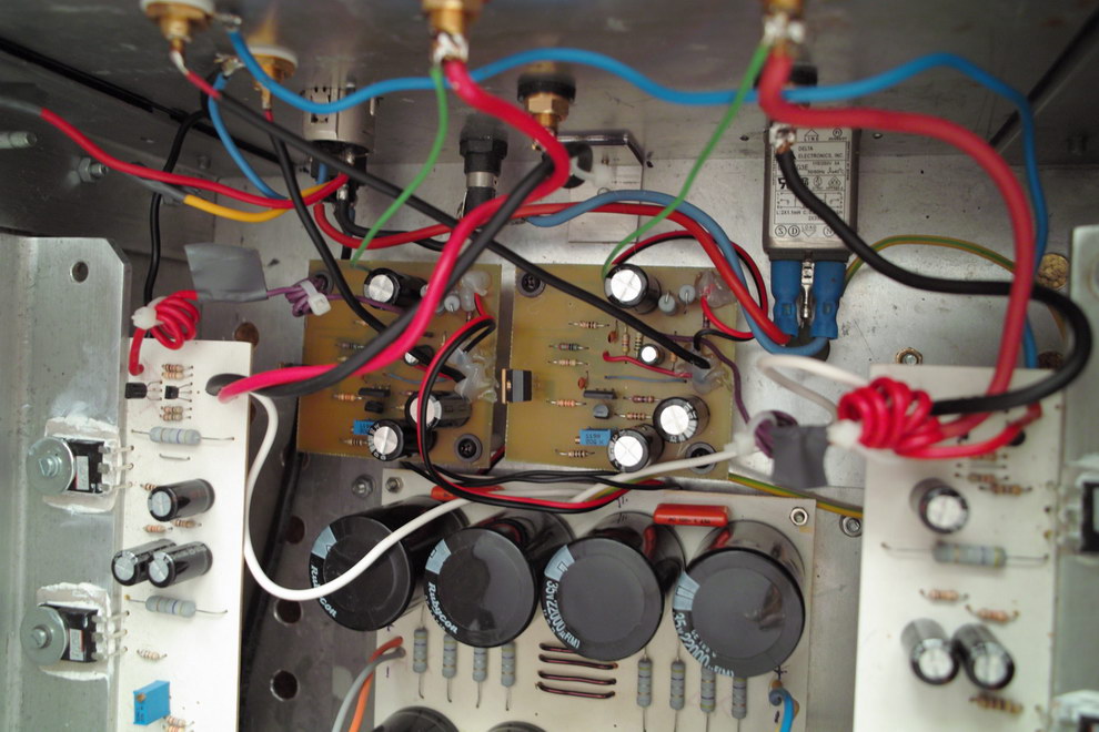

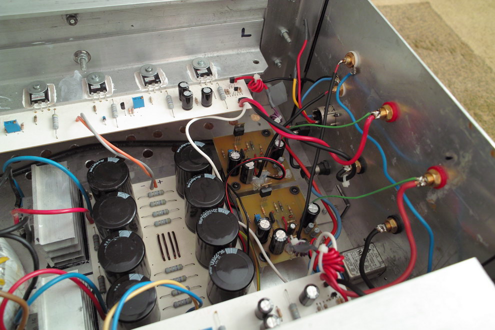

near the back plate there are the BA1 front ends built by me. schematic is taken from here: http://www.diyaudio.com/forums/atta...4351063-f4-power-amplifier-pass-ba1-fe-f4.jpg
basically Burning Amp front end with the DC offset (at least I think that's what it is) circuitry removed.
the J109s and the 2SK170 were bought off eBay from some UK parts shop. I don't know if there is any way to to tell whether they're genuine or not. no "boutique" parts used, I ordered some Elna and Panasonic caps for the front end's feedback and output DC blocking but they arrived late. at any rate, I don't think caps may cause such a degradation. Mr. Pass himself once wrote that even the lowest grade ones are not that bad as some would have us believe.
one might notice the little 20pF ceramics but I wasn't able to source any other type of such low capacitance locally.
I tried to connect the front ends such that there is as little crosstalk as possible. the wires of the two channels don't cross and they don't hang around needlessly.
I don't have the layout of the PCB in PDF format right not but I can say that I didn't go for a balanced layout since I'm not using it as such anyway. it uses a ground plane.
I'm guessing by the shape and parts positioning that the layout of the F4's PCB is the one found in the users's manual on the First Watt website.

To me, that looks like a shoddy job. You could do well to test all the connections, etc. Like you say, if it sounds plain bad, there must be something wrong with it.
your reply pretty much sums up the reason I think 1000 times before posting pics. wanna know my opinion? I'm sick of those luxuriously looking clones of commercial products with readily built, very expensive cases. that has nothing to do with DIY. if one uses good parts, has soldering skills and doesn't skip anything important there's no reason for things to go wrong. and amp is a good amp no matter the look of the case. and TBH judging by the look of the solderings it is pretty well build, I've seen much worse.
as for bias, I didn't yet, will do so soon and post results.
