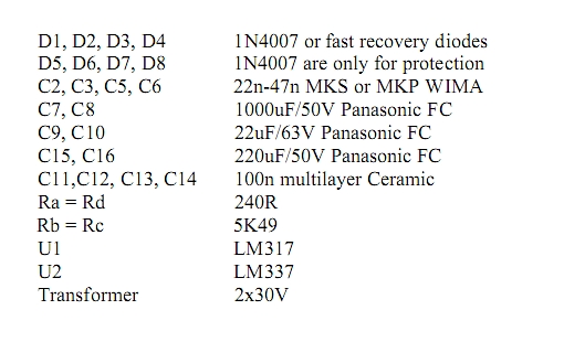

Here some suggestions for the parts from ZEI´s BOM List for the D1 IV Stage PCB:
C1, C1A, C1B, C2 = Wima MKP
C2A, C2B = Silver MICA
C3A, C3B = MKP-QS Audyn Cap
C4, C4A, C4B = Panasonic FC
or you take the Parts suggested in his EAGLE BOM.
regards
Alan
regards
Alan

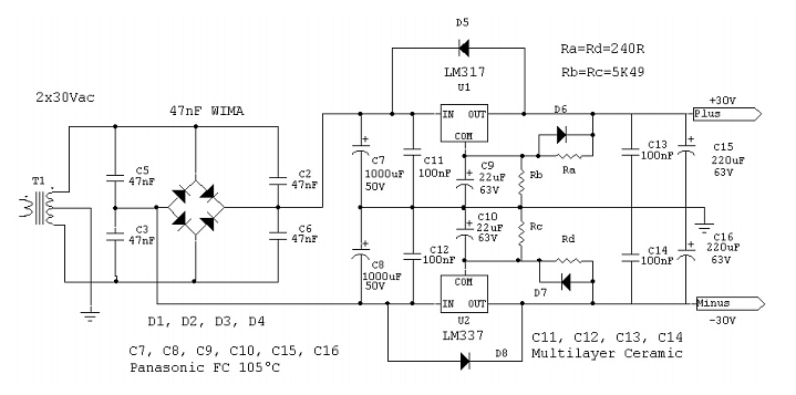

Thanx for the PSU scematic.
That is something similar that i,m going to use to start with. 🙂
As i wrote earlier in this thread, (it think) when i made the layout i was thinking of using output caps "offboard"
I have got some nice russian Paper in oil caps i,m going to use. 🙂
The PCB,s should arrive to me any day now 🙂
/JZ
/JZ
