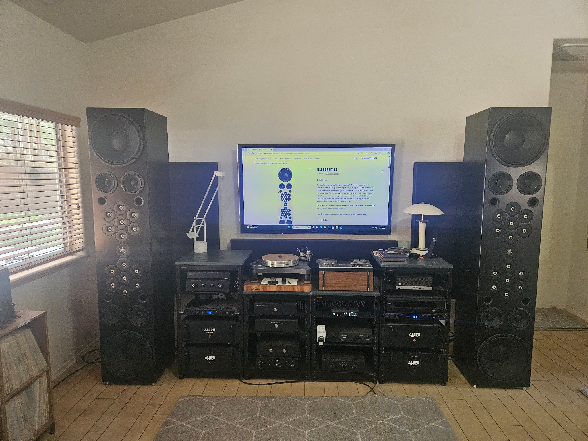

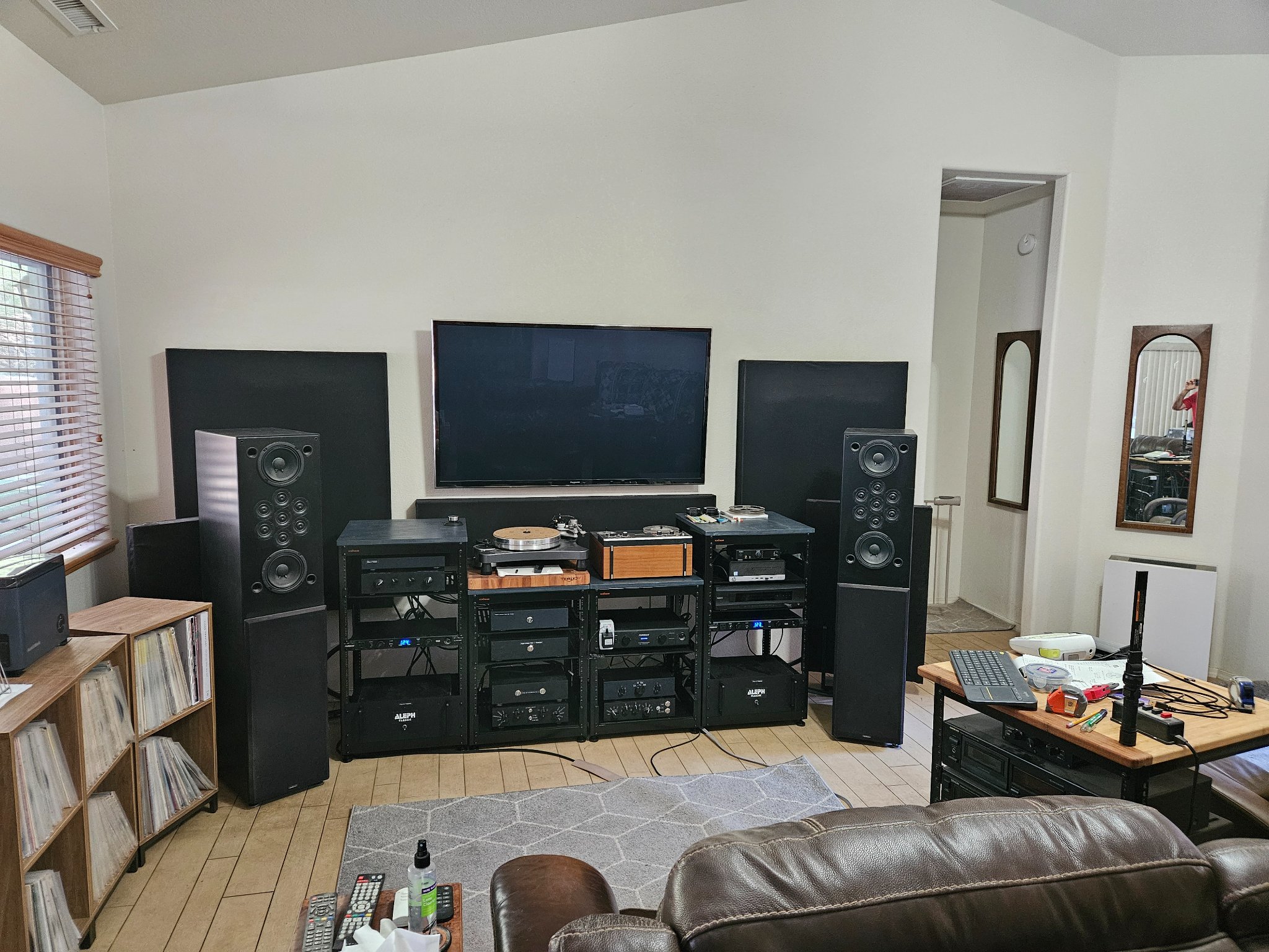

This 3-stage system uses a separate PCU for each channel/amp level and a discrete linear PSU for each board.The actual system is shown in the Jpeg below. This first incarnation spoke to Tekton Double Inpact speakers as shown below and was so successful it made you want to listen to your favorite media choice.
Decided to go towards a larger speakerwith bi-amp capabilities for orchestral play and, so...

Tekton Ulfbehrt 15s – design,delivery, and install
The first generation Ulfbehrt speakers used 12 inch woofers and Eric's patented 15 dome radiating hybrid midrange matrix array. The Ulf 15s expand the woofer size with proprietary 15 inch woofers from Eminence and add a beryllium centertweeter. Crossover upgrades are available as you like and my choices were Solen caps and Jentzen coils. The speaker design employs an expanded D-Apollito array of woofer, low mid, high mid, tweeter, then supertweeter. The central supertweeter is 41 inches from the ground –exactly at ear height when seated. Brilliant because there are thesame number of speakers above the ear as there are below.

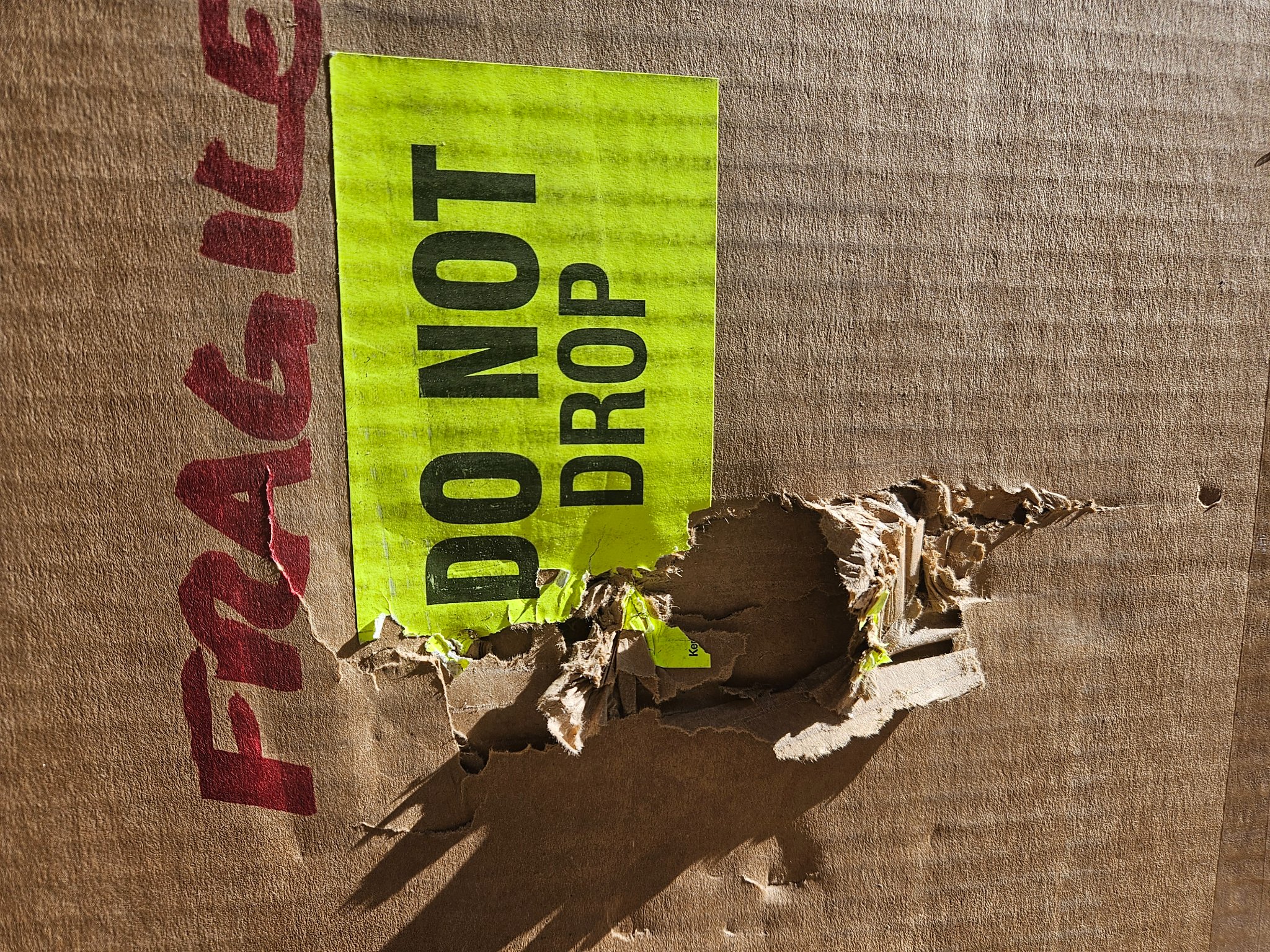

Eric sent me a photo of the shipping package upon completion and it is shown below (Eric Ships Ulf 15s). He likes to ship the speakers in vertical orientation. The second JPeg (Tforce Delivers) shows the speakers as they arrived – with considerable damage to the outer packing by TForce, the freight service used. The package was too heavy and broke down into horizontal orientation crunching the shipping pallet.
This created a major decision –refuse delivery (the recommendation of the TForce delivery guy) or accept with exception and hope the packing protected the contents (Eric's recco). Decided to accept and, because the containers are packed so well, this turned out to be the correct choice.
Had arranged with two of my neighbors for help in transporting them into the house and these two were so strong they easily carried each package into the speaker area. There I added the feet, leveled each speaker carefully (these function as line-array drivers and this helps soundstage accuracy) and used those round furniture pads under each foot to slide the speakers into place. A seven-foot tall speaker makes a dramatic statement in your listening area and the next Jpeg below show them installed.
Initial setup uses two Aleph 30monoblocks for each speaker in bi-amp arrangement. Using identical amps in a passive bi-amp is, of course, of modest interest. The major difference is the additional power supply. The passive crossover will turn the unused frequencies passed to it into heat. Want to use an active crossover connected to the BA2018 preamp and this dual Aleph setup being shown is in preparation for that.
