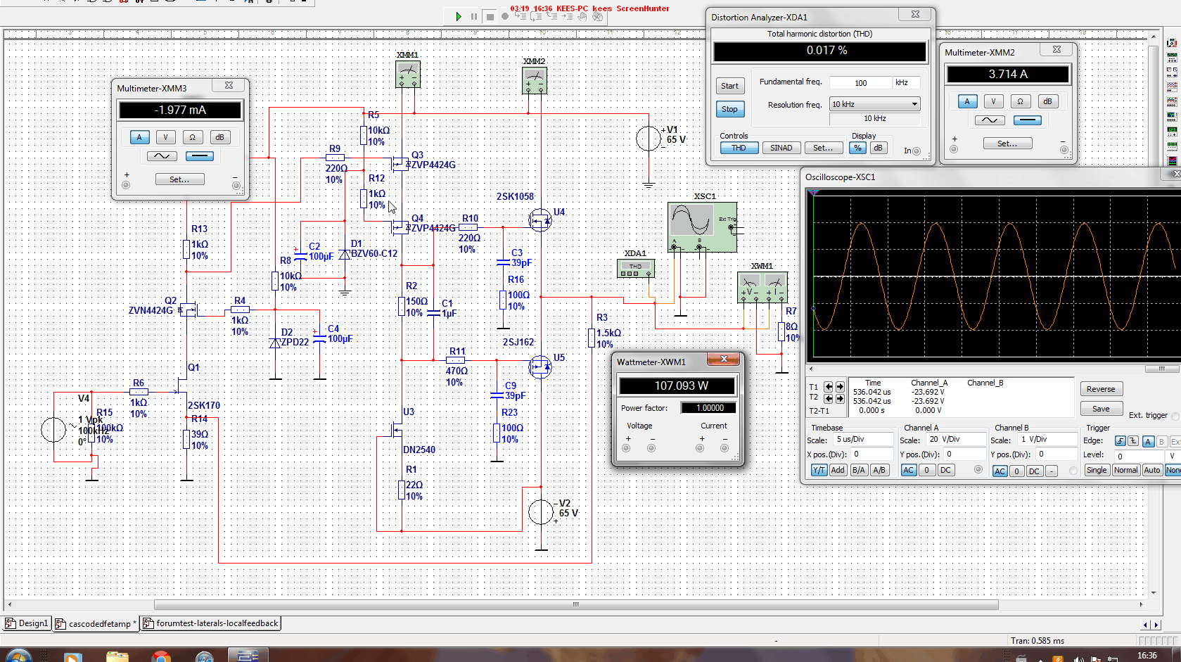

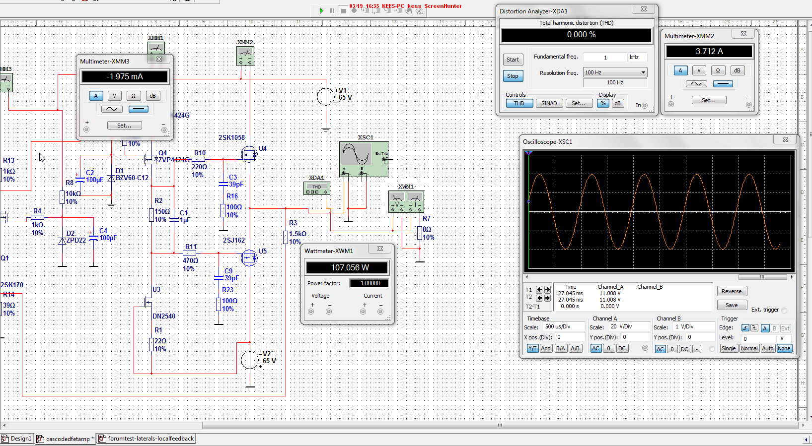

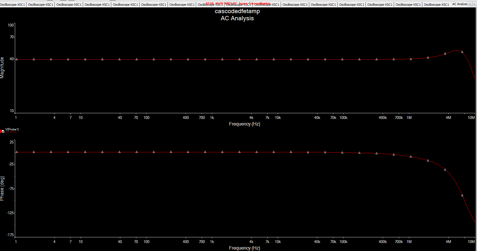

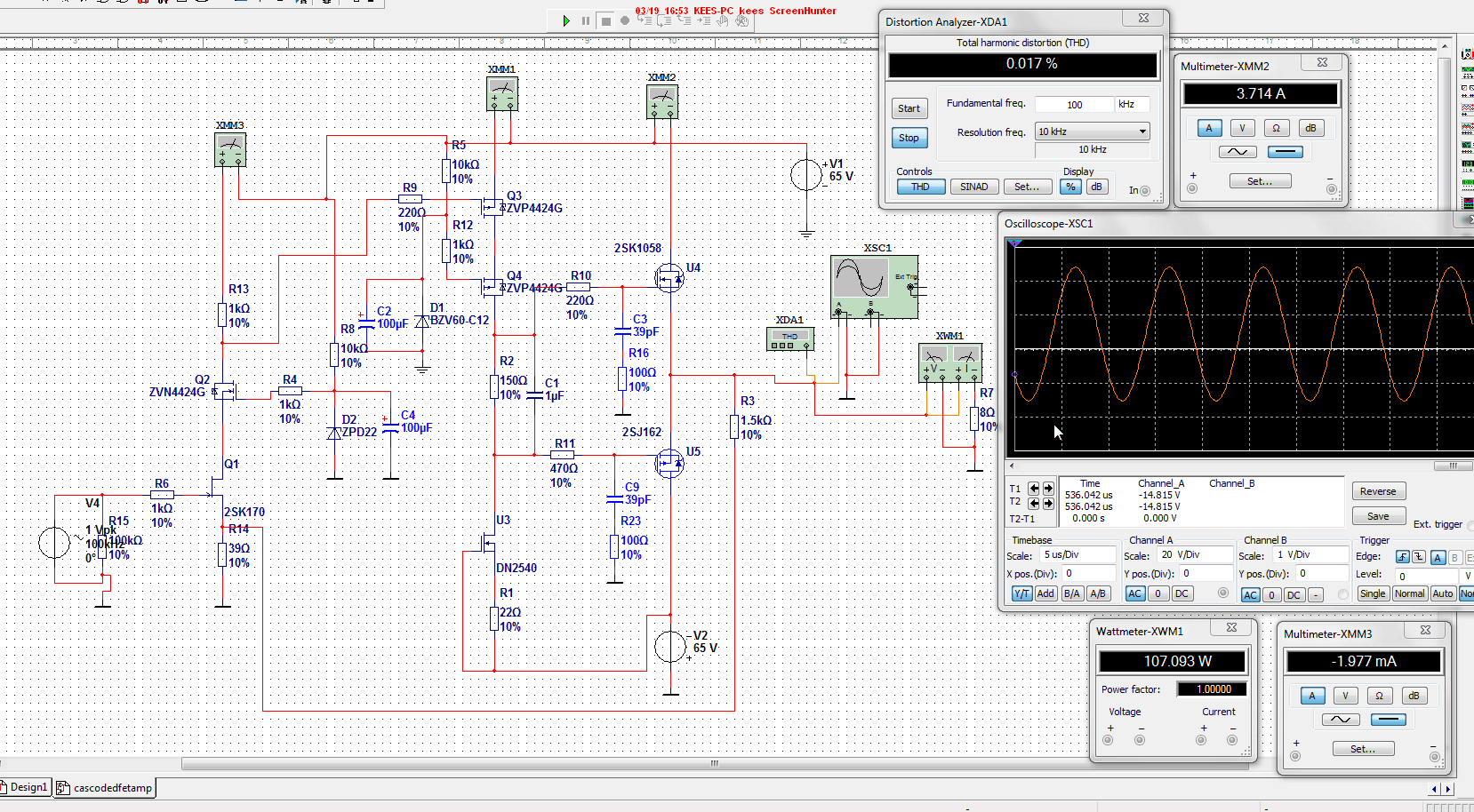

I have play some around to simplify the allfet amp, and came out with a current feedbacked one with single ended cascode vas.
it simulates wonderfull, if this is true wat I get then maybe this one will sound very good, it is current feedback and big bandwith, I have try differend mosfets in vas, the zvn4424 is the best, but maybe just to small, change one in the vas driver can however with some more distortion with a irf 9610, as I escpected capacitance in amps is very important, so cascode is a way to get transients good.
in picture the simulations, one in 100Khz and one in 1 Khz, and the bandwith test, it has no correntions yet, this is only when build it to keep possible oscillations away.
And now I go work in the vestibles garden, summer comes.

Hi Kees,
I have already built this design months ago and it sounds very good indeed! See here:
http://www.diyaudio.com/forums/solid-state/186650-jfet-input-mosfet-vas-lateral-output-perfect.html
Hugh is offering boards in the aksa forum. Ultimately I decided it sounded better without cascodes though.
Do you have build it without cascodes? I have also seen that with multisim and the zvn and zvp mosfet the distortion is very very low, maybe de models of this mosfets are not correct to ideal,, in mine I have 0.017 procent 100 Khz 100 watt, and zero distortion 100 watt with 1 Khz, cascodes are clean and avoid compression what give a more relaxing sound, called easy.
Kees,
I tried a cascoded VAS, but never a cascoded input. I preferred the sound without the cascode but it is something I would like to revisit. Are you going to build your circuit?

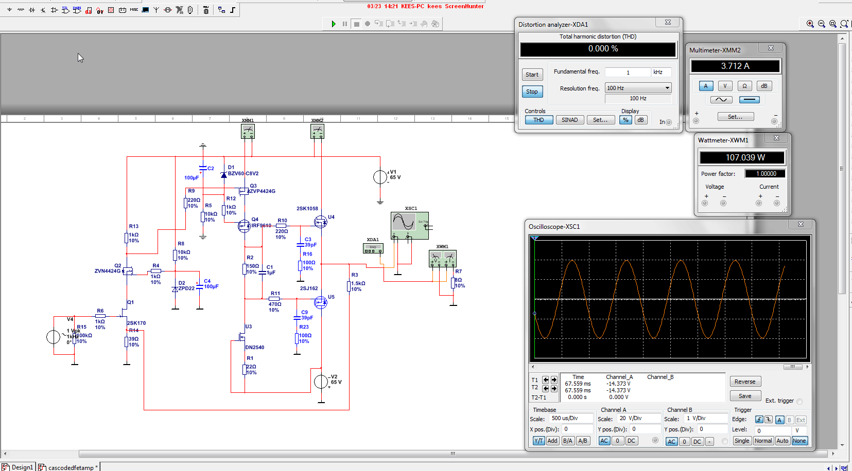

Oke a small correction to the vas cascode, now the upper mosfet can be a small one and de cascode mosfet itslefs takes the most and give juicy drive to mosfet gates. now you can use a lot more upper mosfets for trying how it sounds. I think this will sound good it has current feedback, the offset implementing is not done yet, but everyone now how so it is not a issue, best is a opamp for this in a current feedback amp, if it is current feedback, hmm yes because it feedback to source, I am not shure here, oke, someone else now that why we here for.
distortion is very good, 0.00000 but take it with a egg..
and with 100 khz, 0.013.

Kees,
I haven't looked at your circuit in the utmost detail but the theory looks sound enough and it should work ok. I would consider dropping the direct coupling in the feedback path and running a feedback shunt cap. This will let you set the DC offset with a simple voltage reference at the gate of the input fet, such as a string of LEDs. This worked for fetzilla at least. The use of a fet input and vas, and lateral fet output gave fetzilla a very stable bias and offset with no servo needed. However this was without cascodes, so I'm not sure if your experience will be different.
If you need parts, you could try digikey. They deliver nearly anywhere and stock most parts at good prices and in small quantities.
