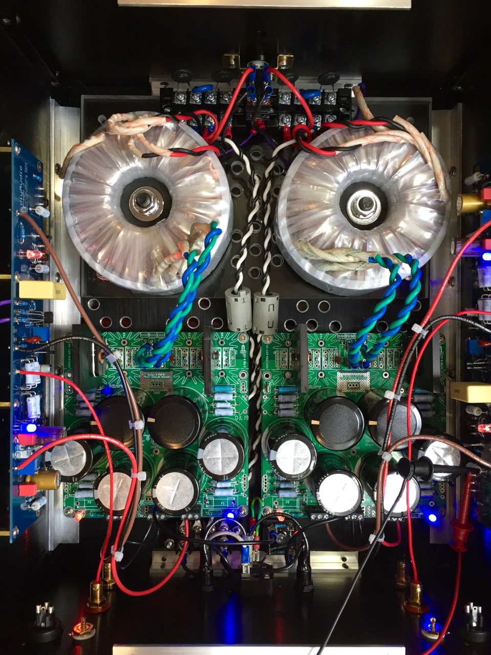

I'm new to all this so pardon me for asking, but what is it about a dual-mono power supply that turns an amplifier-per-channel into a monoblock? I thought the fact that there was an amplifier-per-channel was what made it a monoblock.

To have a complete amplifier per channel, one needs to build a stereo amp with separate PSU for each channel, or to build completely separate monoblock amplifiers for each channel. This is what an Aleph J looks like with a dual-mono power supply. Even though this is in a single chassis, the only thing in common between the two channels is the power cord. The power switch is a double-pole, single throw type.

I still don't understand. In that picture it looks like you have 2 XLR ins and 2 RCA ins, neither connected, which indicates to me that it is a stereo amplifier. You've set up a dual power supply in it, which makes me want to call it a dual-mono stereo amplifier. But the context of the original question was about one amplifier enclosure and associated power supply per speaker with a single XLR in for each. In that context, your reply seems to state that you would need to run dual-mono power supplies for each enclosure, with one power supply for each +/- rail of the XLR signal, in order for it to be considered a monoblock.
I think the question boils down to this:
Is it a monoblock because there is one power supply per speaker (what you have there)?
Or is it a monoblock because there is one power supply per rail? That would be a single power supply for an amplifier for a single-ended RCA signal and a dual-mono power supply for an amplifier for a single balanced XLR Signal.
Or is it a monoblock because the amplification circuit per speaker exists in a separate enclosure, regardless of the power supplies to rails ratio?
I want for terminology that clearly identifies each. Like is there a term that indicates that you have a balanced amplifier for one speaker in an independent enclosure with a dual-mono power supply, either in the same enclosure or in a separate enclosure? Or do you just have to word it out like "I run a pair of balanced monoblocks in separate enclosures with independent, external dual-mono power supplies." Does a setup like that make it more of a monoblock than what you have in your Aleph J?
For context, I've toyed with the idea of stuffing 4 whammy power supplies in one chassis and using an umbilical to connect it to another chassis with 2 whammy boards, each acting as preamp for a balanced XLR signal, and I was wondering what to call it. So questions like this have been on my mind recently. Stereo monoblocks with dual-mono power supplies?

Monoblock is a single channel (single speaker) chassis. Can be balanced or single-ended but still a monoblock.
Stereo is 2 channels in a single chassis, no distinction on PSU separation.
Dual mono is as TungstenAudio describes - stereo amp (meaning 2 speakers powered by a single chassis) but with completely separate power supplies per channel. To turn this amp into 2 monoblocks simply requires an additional chassis and IEC plug/switch.
The ACA is a stereo single ended amp but people take a single 2 channels of ACA and feed it with a balanced signal (1 channel with +/- and gnd input) and turn a stereo single ended amp into a balanced monoblock.
Monoblock is a reference to the PSU per channel separation. Balanced or unbalanced refers to the input/output signal - 3 wire is balanced where + and - are the same signal in opposite phase.

That picture of my Aleph J was taken during initial bias setting, before I had hooked up the inputs. I'm still just using the RCA inputs, as I don't have a proper balanced preamp yet. I included the XLR connectors because it's much easier to do that at the beginning. With single-ended inputs, the IN- connection on the amp PCB is tied to GND. If and when I get around to using the balanced inputs, I'll need to re-wire things a bit.
Tungsten - can you please explain how the transformers are connected to the PSU? It looks like you used toroids with dual secondaries...if you are doing a dual-mono set up would it be better/easier to use a transformer with a single secondary? Your layout looks good and this will be a useful reference for me on how to lay out the chassis. Thanks!
