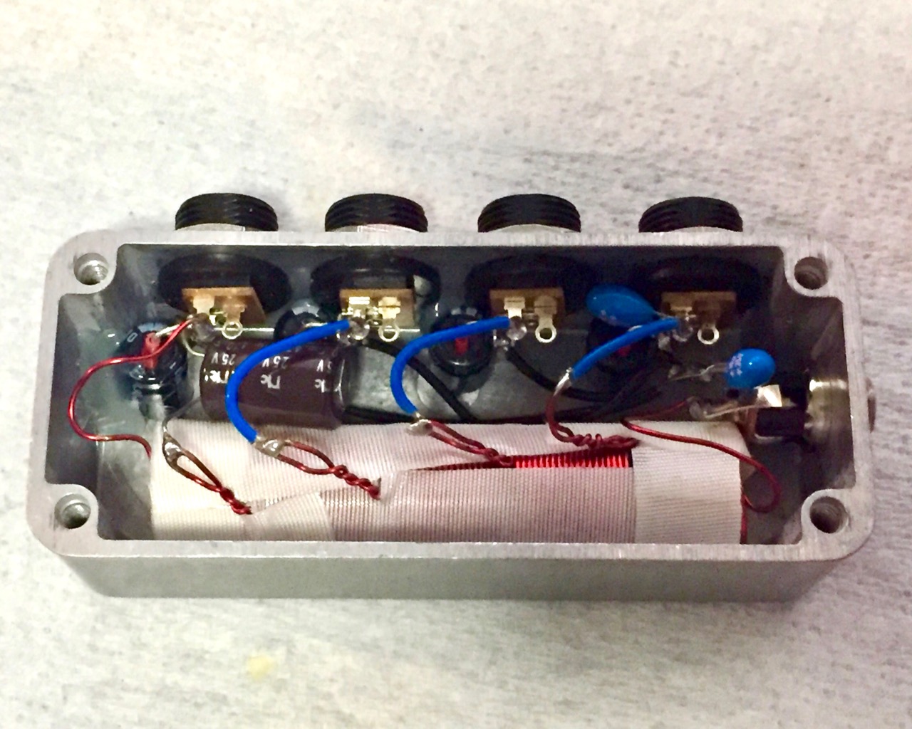

When using SMPS bricks of unknown quality for my guitar pedals, I have taken the precaution of providing some extra filtering between the PSU and the pedals. I made an inductor using 20 ga magnet wire wrapped around a 1/2 inch dowel, with four separate tap points, equally spaced. At each tap point I connected a 220 uF, 25V capacitor. Inductance between taps is approximately 5 uH. Ground returns for each power outlet were separately wired back to the input ground.
Some of my pedals are more sensitive to power supply noise than others, and this little contraption has proven to be effective at quieting the noise. It has the added benefit of providing the correct polarity for typical pedal power connectors. Picture is attached. Something like this could be cleverly hidden inside the B1 chassis to use with an external SMPS brick.
