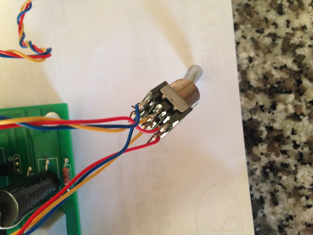

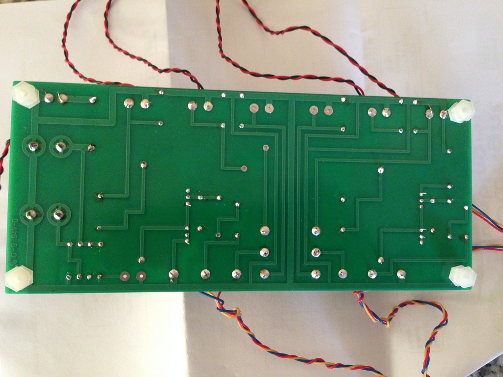

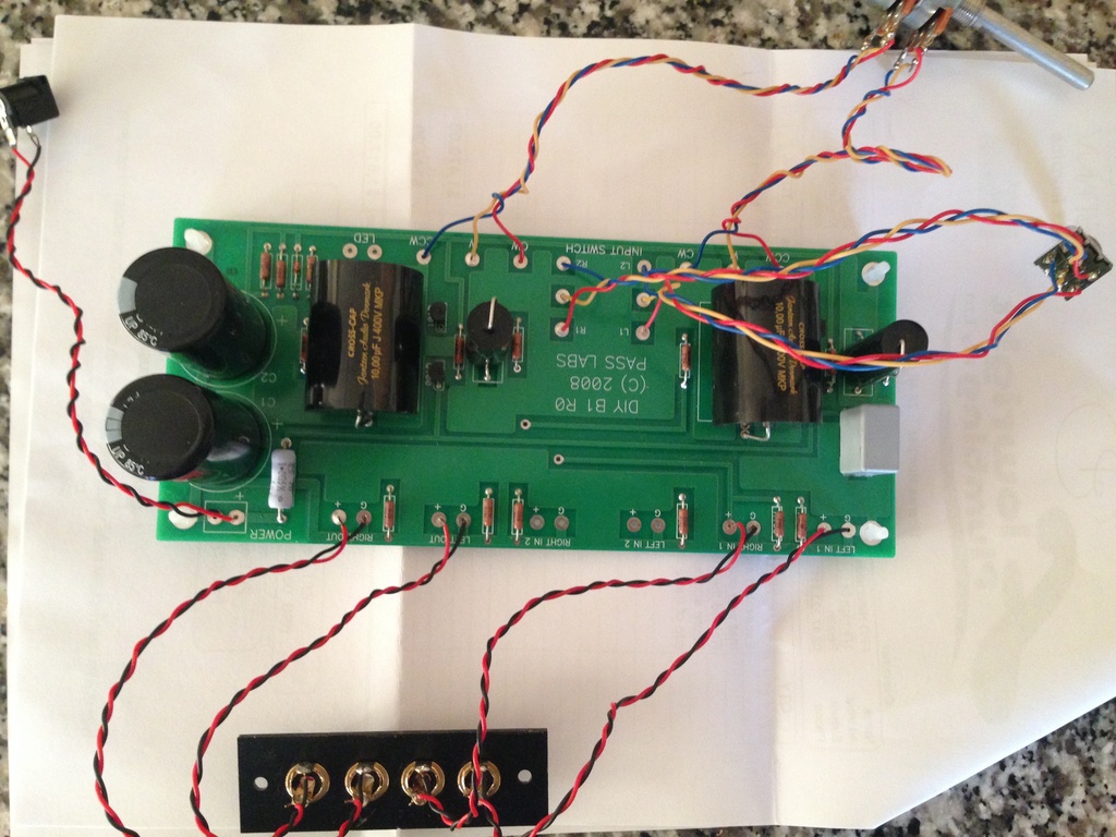

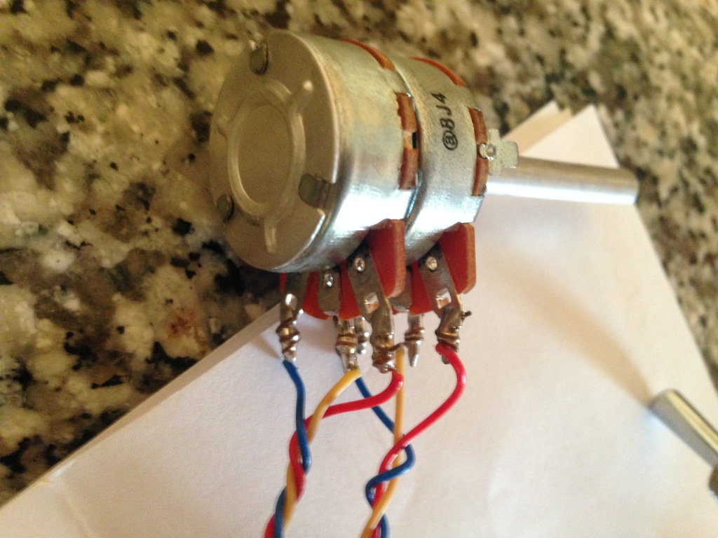

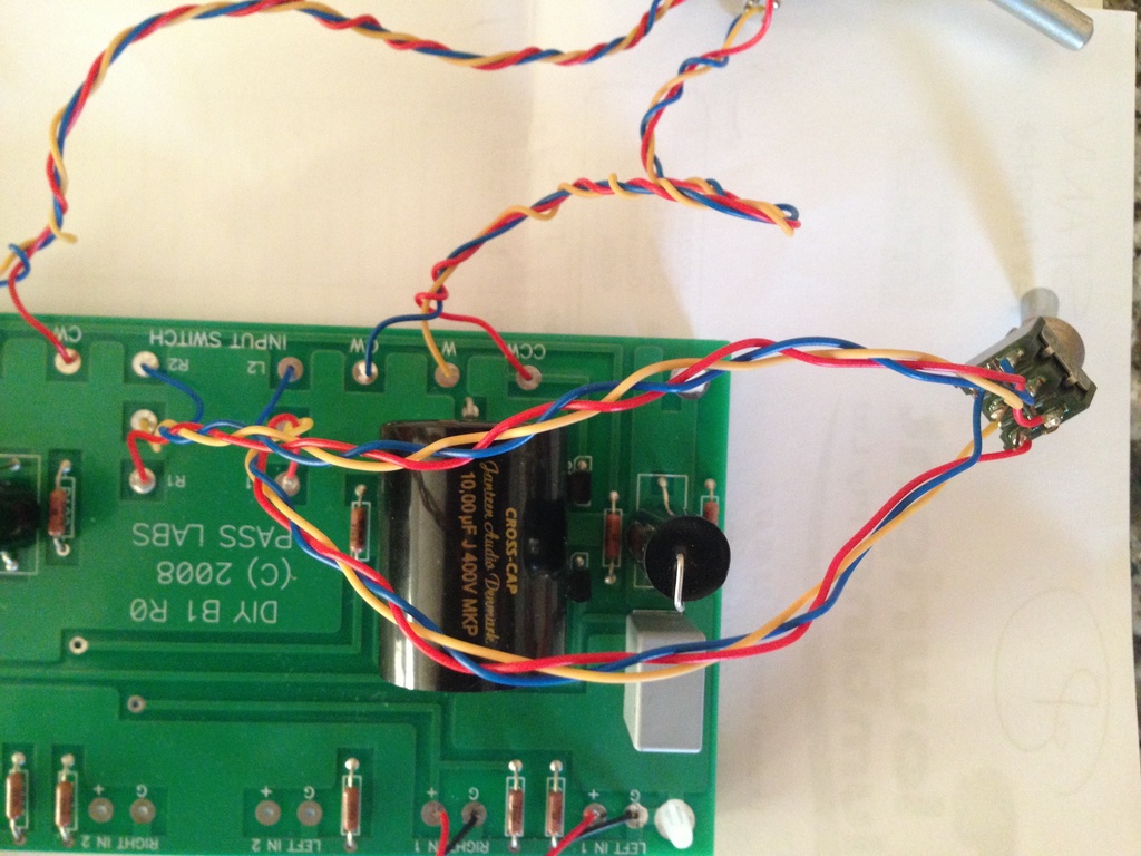

Take a picture from above which shows clearly, all the wiring, to both volume pots as well as rca plugs, etc. There really isnt much to go wrong.
Russellc
Hi Russell, please see the photos taken of the board and associated connections from both sides. Please let me know if you want any close-ups.

You guys are absolute champions! I can't wait to get home and try this. I can't believe how silly of a mistake I've made, so so silly! 🙂 But you guys are the best! I can move on and build the DC power supply for this now, and then move on to the DAC. Thank you
