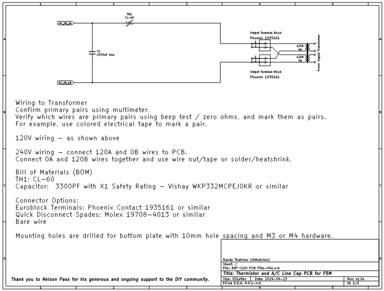

Does the F5M PSU kit contain a 230V hookup board? I only see a 120V one in the showcase pictures.
