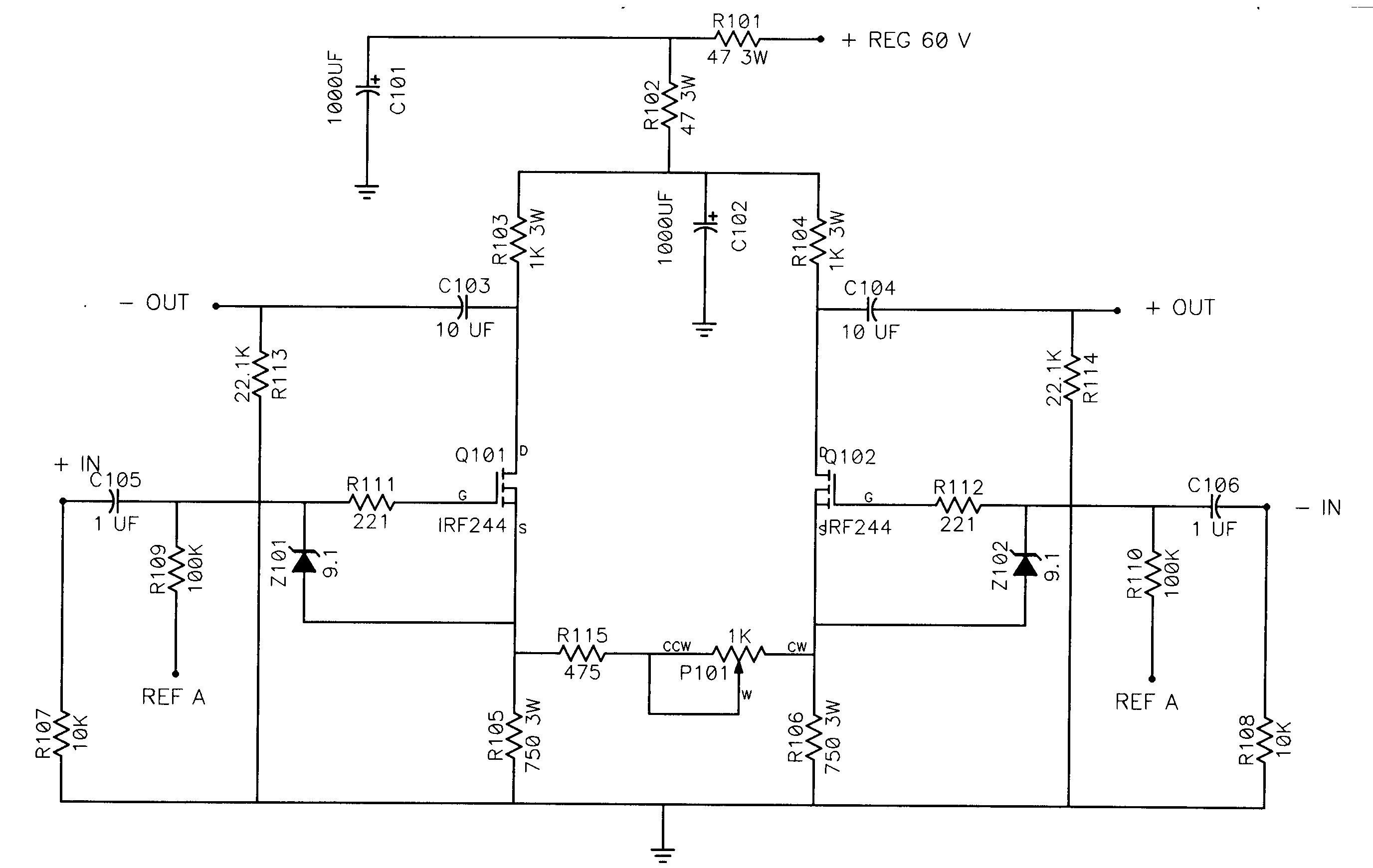

Most of the FW amps are happy with it. I would say that the SIT-1 and 2
would see a little more limited bandwidth with its output impedance.
If you want to take the gain down on the Aleph P. just load the output
with resistance to ground. It's quite happy with that, being a current source
whose gain depends on the output loading divided by the degeneration (the
two gain control knobs).
A consensus of sorts has been reached that says the best sounding spot on
the two center knobs is about 3 o'clock. If you load the preamp outputs
with resistance (pin 2 to pin 3 or both pins loaded to ground) you can set the
gain so that the volume control is in the range you want with those two
gain controls at that setting.
I am attaching the original original schematic.

I think Zen is saying balanced into the P then ground the - out and run single ended from P to the F5. Don't worry about balanced from pre to the amp.
The P is easy to do...
1) SE in BAL out
2) BAL in SE out
3) BAL in BAL out
4) SE in SE out
1) SE in BAL out
2) BAL in SE out
3) BAL in BAL out
4) SE in SE out
yup
yank gain setting to max
load pos out with resistance to have adequate swing
load neg out with same resistance
use just pos out to feed da amp
