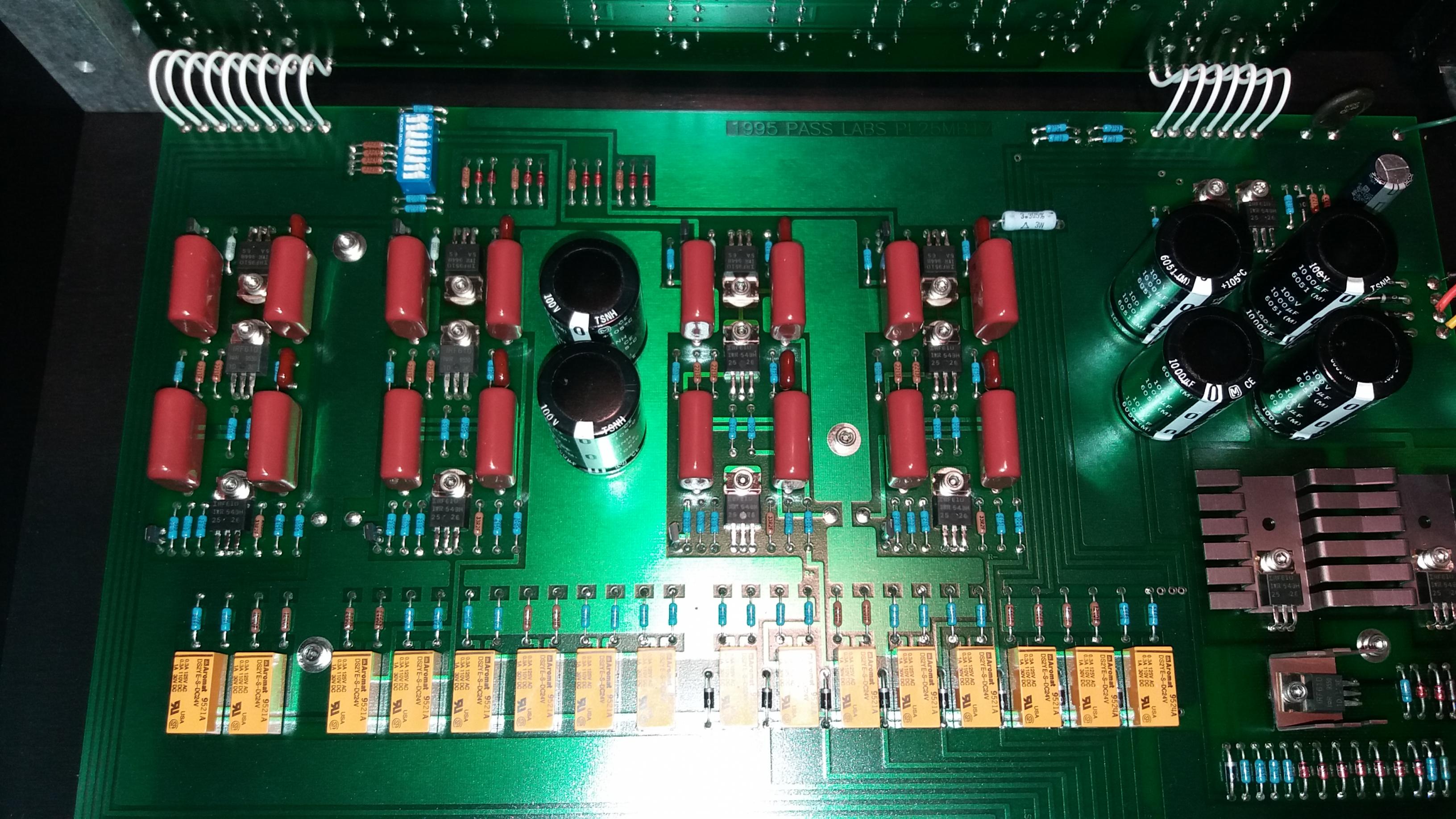

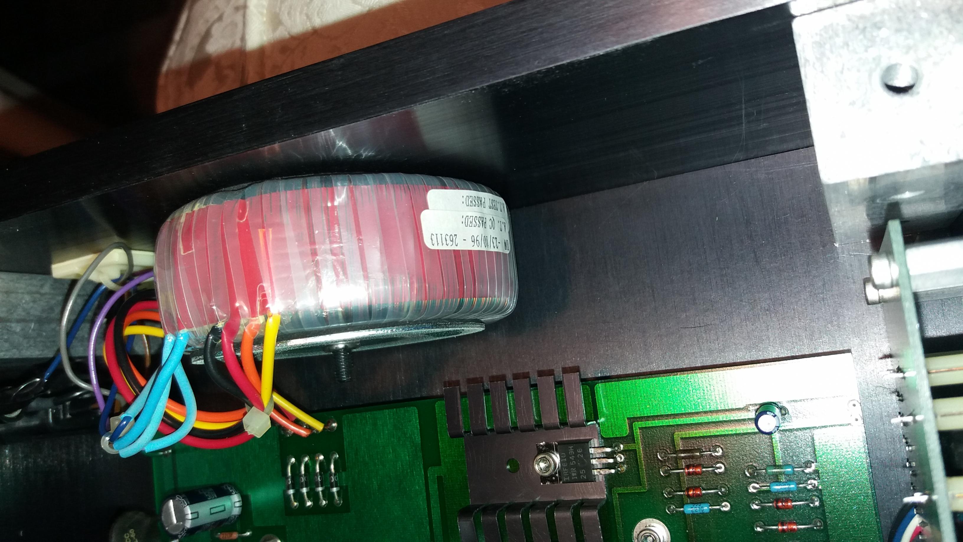

Good evening guys, my name is Matteo and I'm a new member looking for help, my pre pass Aleph p started to give a strange problem .. while the channel set knob is positioned on channel 1, the channel light remains on 2.and so far no problem since it still reproduces well. The problem arises if I select channel 2, it makes a mechanical noise that I can't describe but comes from inside the case ..

yes, it is the model with remote control, I didn't tell you that the pre has another problem, this time with the volume ... when I rotate the volume knob, there are two points where the signal goes away from the right channel, then I rotate again of a point and everything is in place.

Sounds like a relay without enough drive voltage/current to pull in the contacts which is what the chattering is about. Could be the power supply or worse, the drive circuit.
A bad capacitor in power supply would cause AC to pass to the relay which makes them chatter as well
