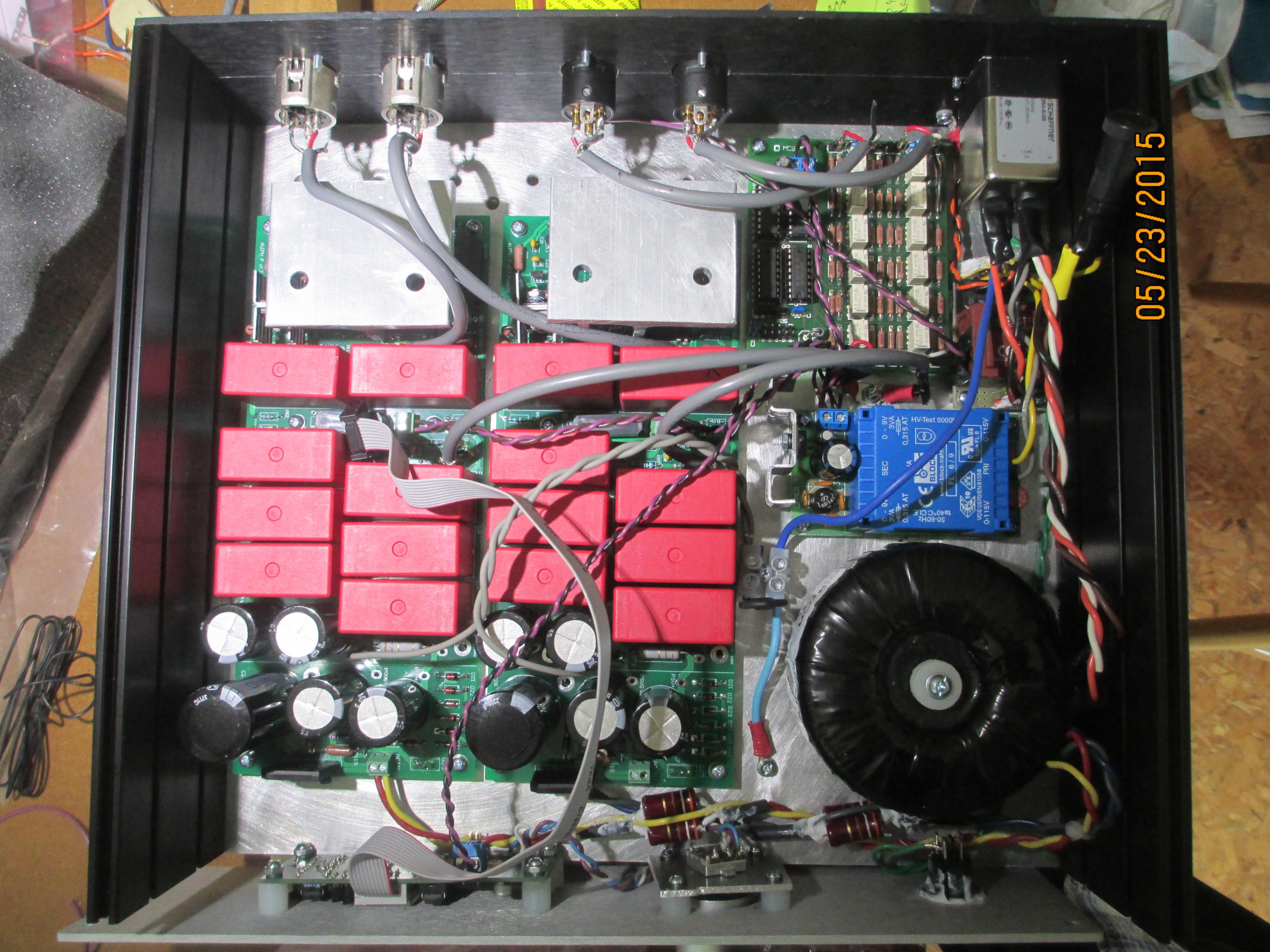

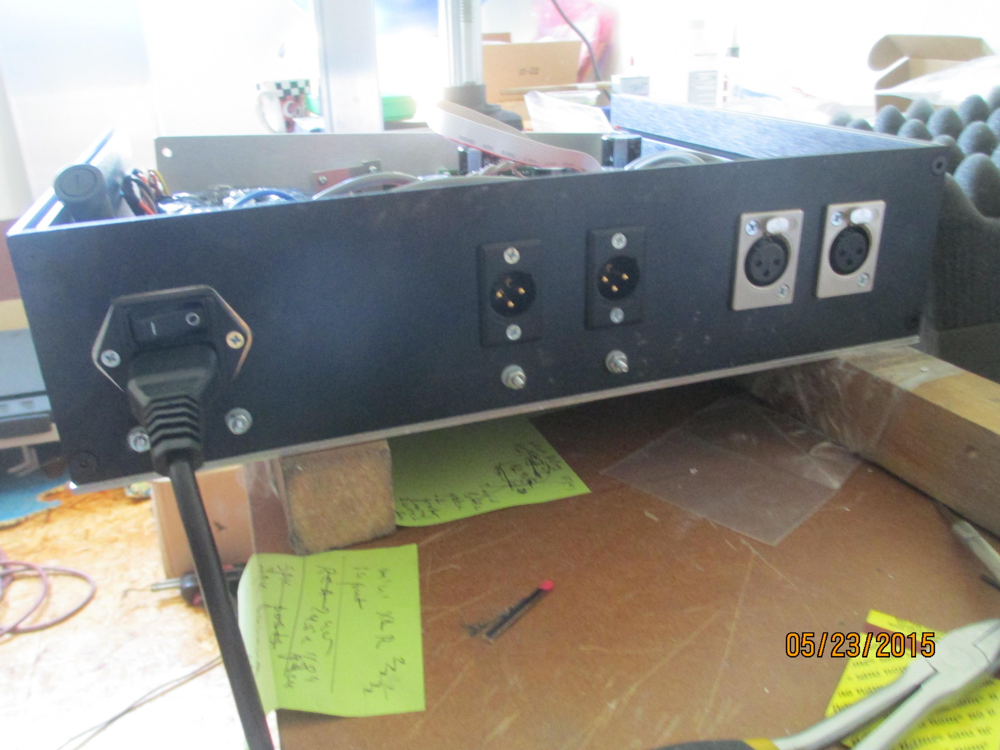

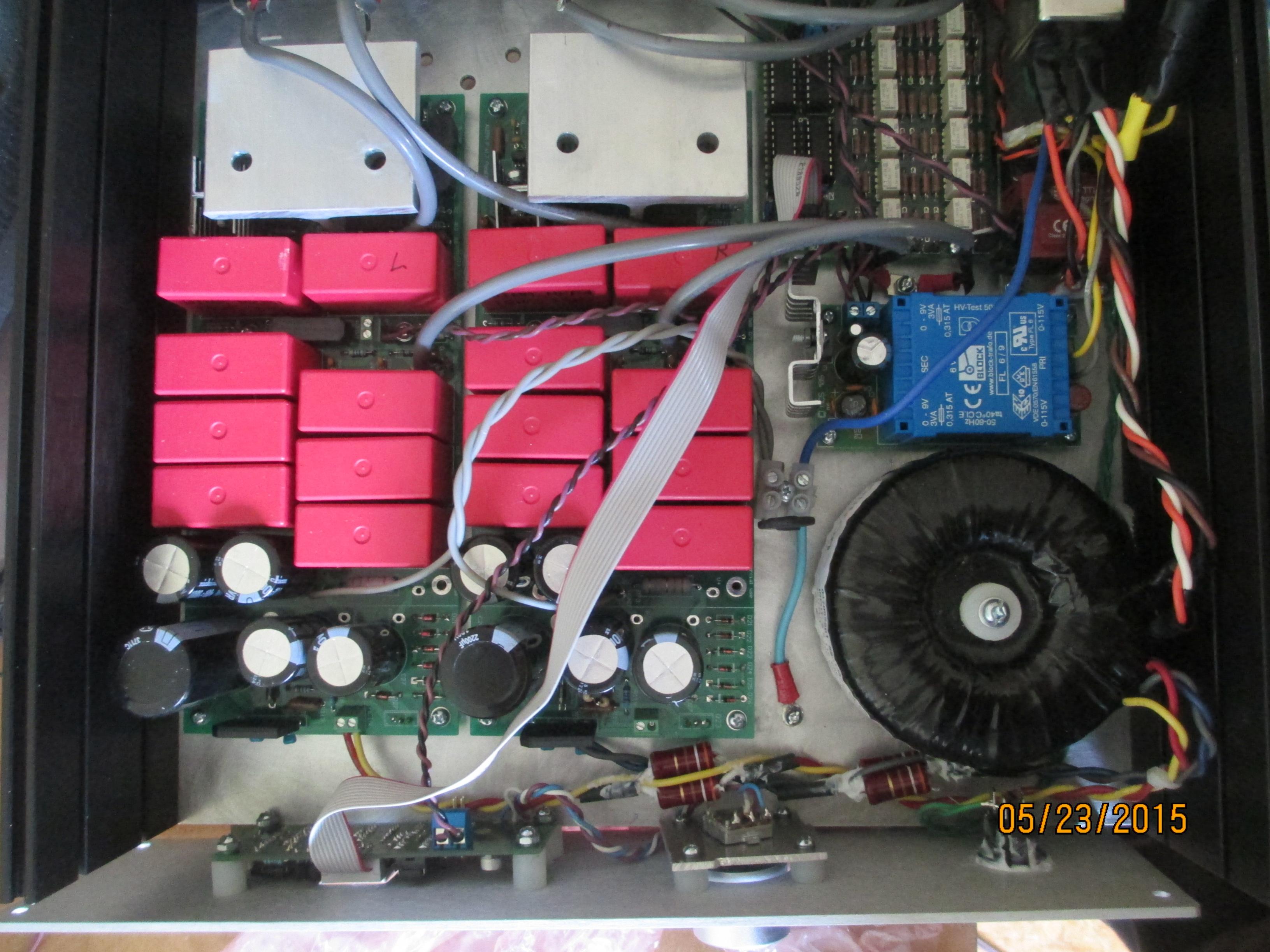

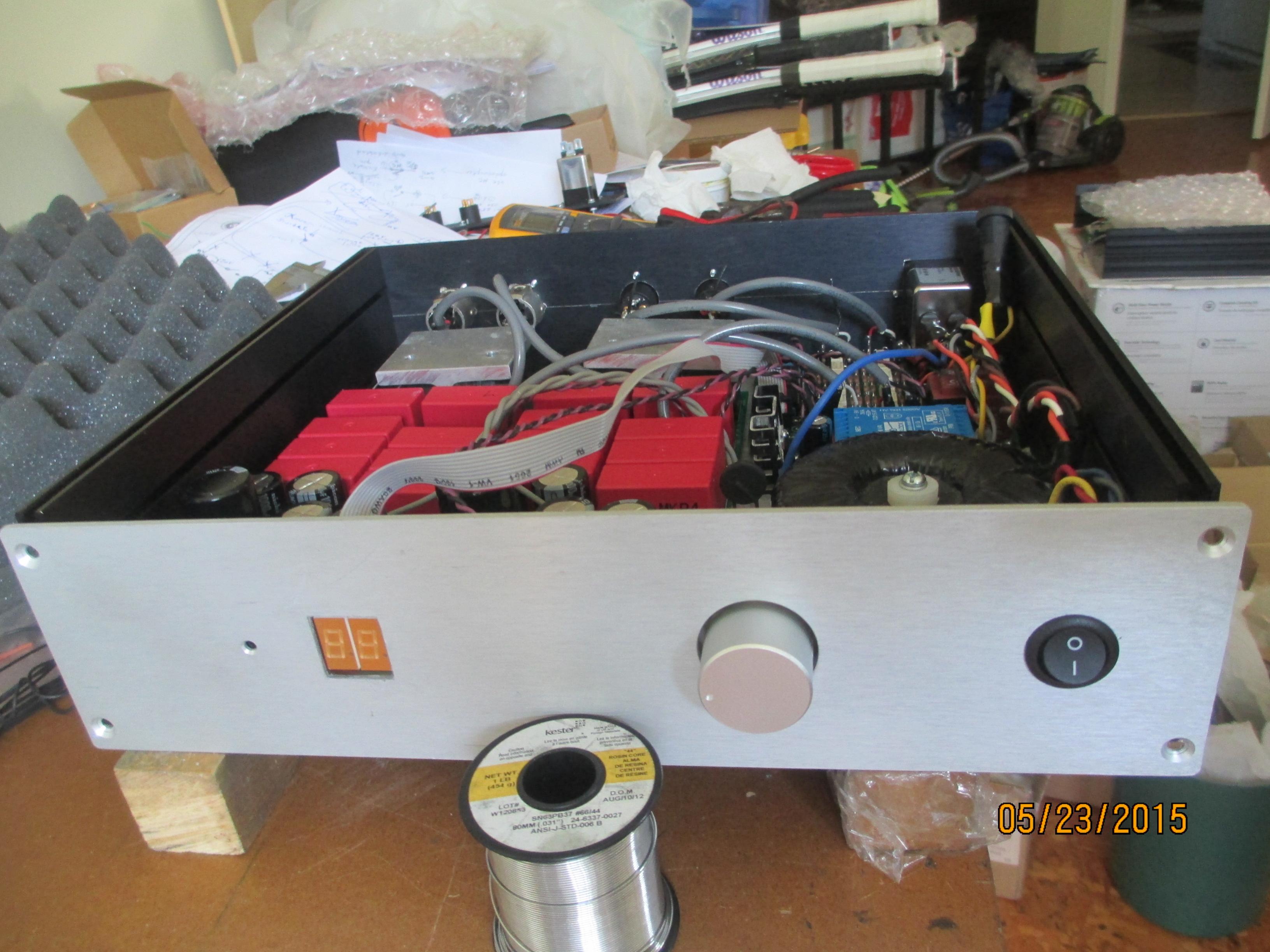

and I thought my build would be the last, hmmmm. Anyways, I am finishing my two Aleph Ps. they are identical. one will drive the top and the other one the bottom of a biamped system. they have each a 1kOhm Dantimax relay volume attenuator. the idea is to set each independently with a button and then move them both up/down with the same remote.
I added also the relay capability to have them turned on by the Xover which is upstream, and also for AlephPs to turn on the amps downstream (so i do not need to run around the room turning a zillion buttons on/off.
here are the pics of the first one. the box is still open since I need to order the fuses in another size (last minute change).

for yoke:
relays 1&2 (Hamlins) are the same as on Papa's schematic. this preamp benefits from having an input attenuator for hot sources. these turn the input resistors on/off for a few discrete gain steps. check the service manual.
the other two relays (Spartans or equivalent), can be used instead of a jumper to short the input or output to ground if the preamp is to run SE and not balanced.
all relays take a 5V from an external PS and are controlled by the 4pole DIP switch.
good luck.

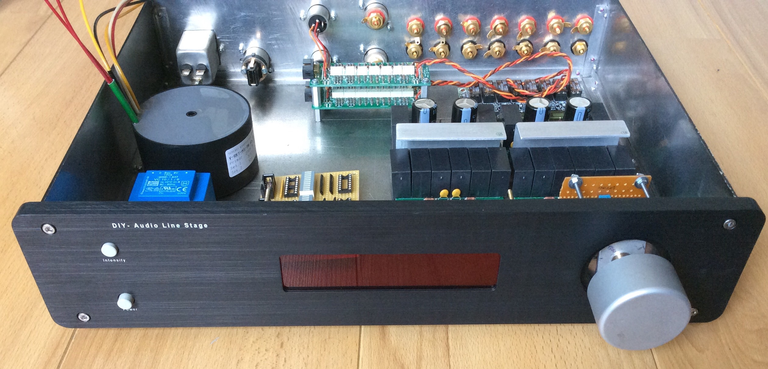

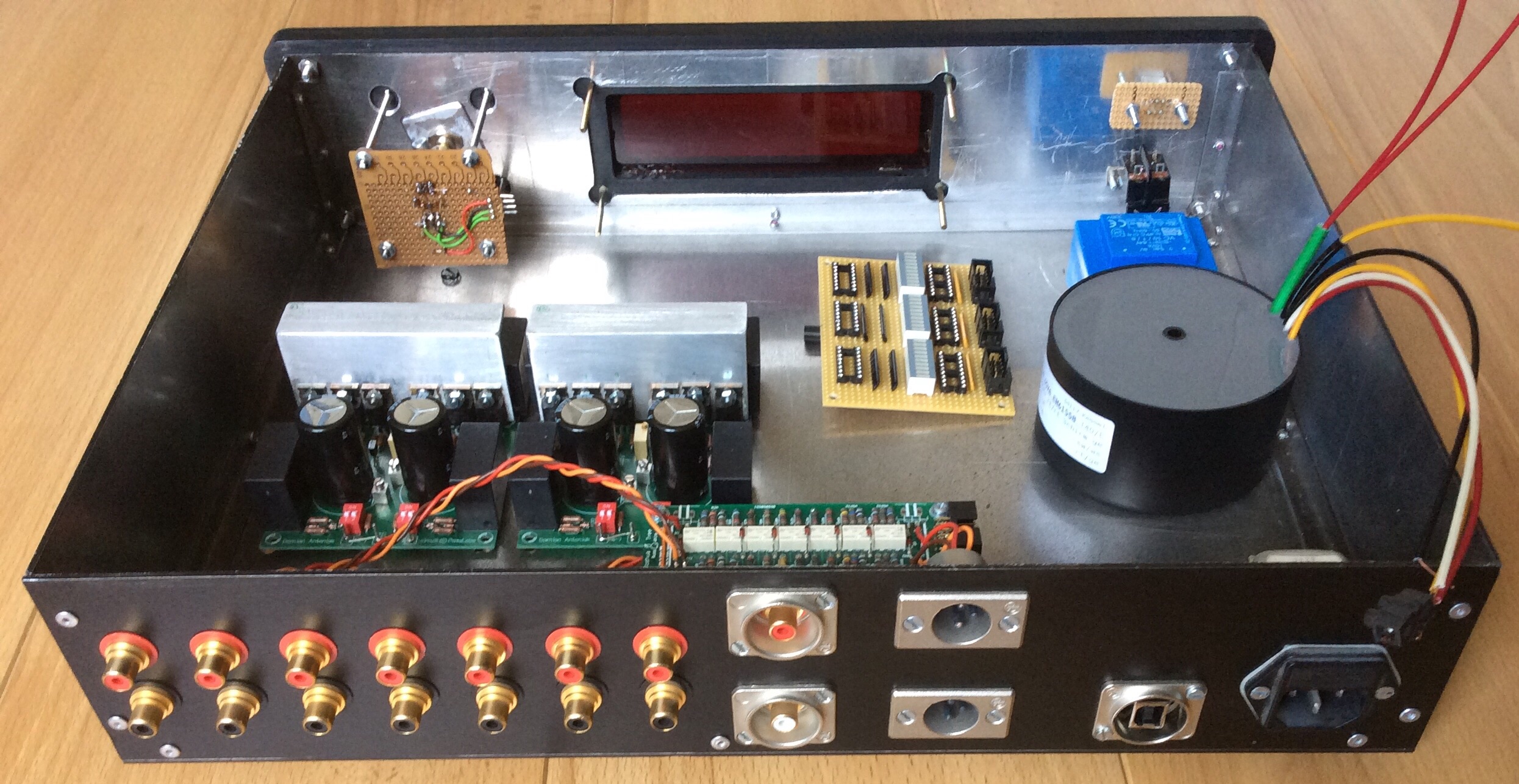

Here a little update from my 1.7 project.
I'm still strugling with mounting the rotary encoder. Alignment is a bit of a problem.
I'm using :
- Arduino for controls
- Twisted Pear attenuator
- AMB based source selection / att relais control
- LCD or VFD display
All is controlled via I2C.
Nick

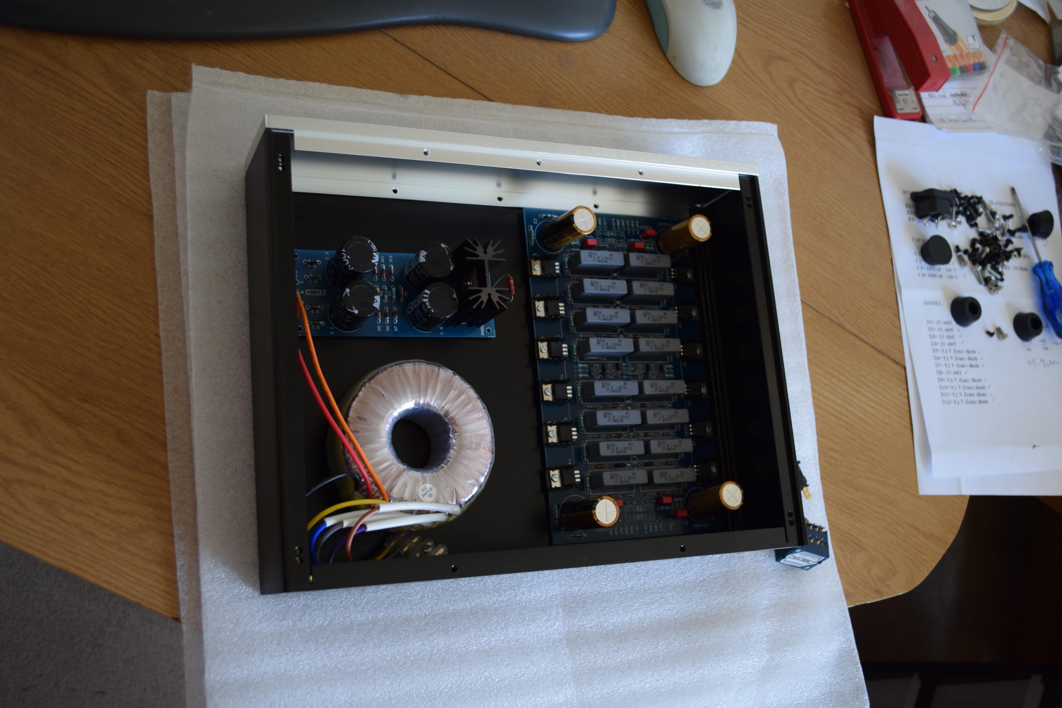

Sheesh! That's a huge power transformer. The the original Aleph P transformer is what I used and its small enough to fit on the side of the chassis. It IS best to have independent regulators for each channel but where you going too put it with that transformer. I used a common n rectifier pub feeding the on board regulators that are the n each of my PCB's. I suppose your transformer could be external in another small box.
BTW: My Aleph P has been running continuously for almost one year now.... I never shut it off.
