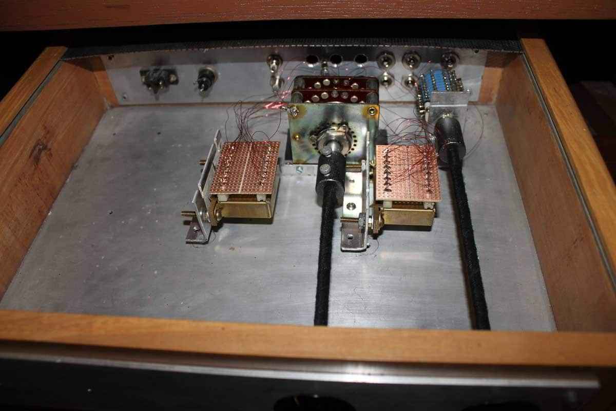

I swapped the new boards for the old ones in my existing Aleph P. So they are working fine and they sound good. The only issue was the mounting holes are a tad bit too small for a 6/32 screw to pass through. So I had to enlarge them slightly. Perhaps they are for metric. I also wish there had been a spot to place a tiny LED on each pcb in the power supply. I am going to tack one in each board.
I have not fed 5 volts to the attenuators so I am at maximum attenuation at the moment. I'll do the 5 volt supply for the input attenuators tomorrow. I did not install the output relays on mine since my Aleph 2's are balanced.
Pictures tomorrow also...

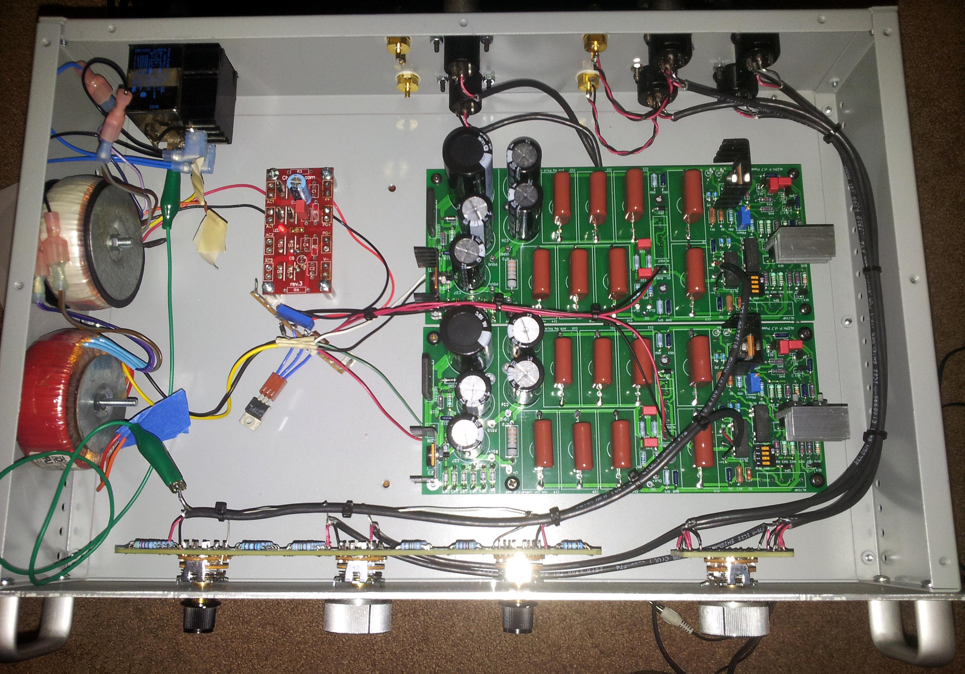

Ok, here it is at this point. These boards with these coupling caps sound great!
I am undecided on keeping the extra 5 volt supply in there. What I have now is temporary. I don't relay like the whole relay thing which adds unnecessary cost to the project and may just replace the input attenuator relay's with a small board with gold plated suitcase jumpers. Then I can dump the 5 volt supply. The relays are nice but they also complicate the whole thing, add about 50.00 to the cost and having to have a couple XLR jumpers to convert an input or output to unbalanced is irrelevant and uber easy. Gold plated suitcase jumpers will cost under a dollar! If this input attenuator were a practical front panel switch to add then perhaps... but once it is set I just don't need it.
If I decide to keep the 5 volt supply and the relays in this one I will make an extra circuit board that goes between the Transformers and the preamp boards for both the 5 volt supply, for junction of all AC and to route the 60 volts AC over to the two boards.

That looks good Mark and I'm glad to hear that you are happy with the sound. There is a lot of room to customize the attenuation to whatever control scheme you choose. I am still undecided. I am thinking of using a double pole shorting type 12 position rotary switch to adjust the gain rather than a pair of pots. That way I won't need to worry about channel balance when adjusting 2 different controls. I still don't know what I'll do with the output attenuator.
I am only using attenuation on the input and it works great. This is a very quiet line stage! It's also pretty hard to beat the price of the Glassware Audio balanced Attenuator unless you get something from China. Thenkit is less than 40 USD. It could also be used on the output if one wanted to. It is completely customizable. Glassware has several options for different resistors or just buy the board and switches and use your own resistors.

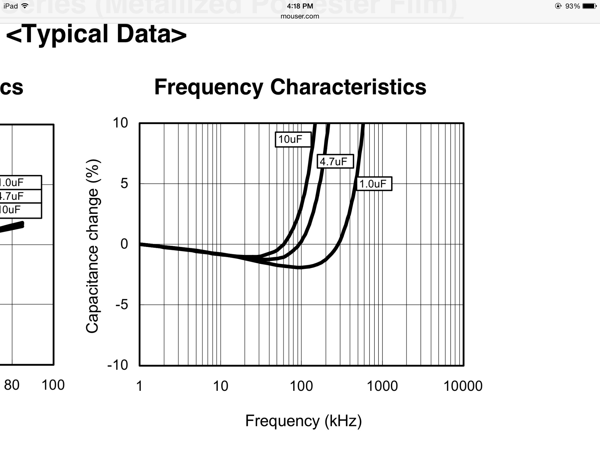

The more I listen to it the more I like it and the Panasonic capacitors are going to be hard for even the WIMA's to beat.

The interesting thing is my soundstage width and depth are now immense compared to the first set of boards that just had Elna Simlac II caps on the in's and out's. So I will mention to everyone here building this project to skip using Elna's.
Also, the attenuator I am using has no real effect on linearity since its a much higher impedance than the circuit input itself. There is no change in frequency response or linearity that I have measured, and I did look at this. The attenuator I am using also has left - right trim and a main gain adjust.

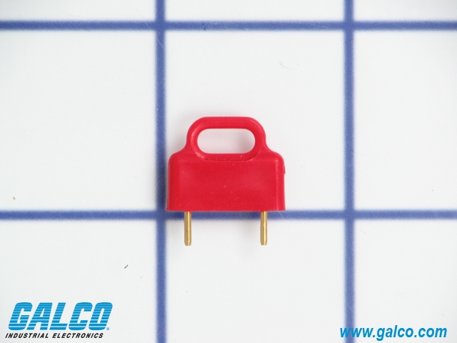

Mark, I have been in the electronics field for over 30 years mostly in laboratory instrument service. I have never heard the term "suitcase header" before. Could you post a part number or a picture of an example when you have a chance.

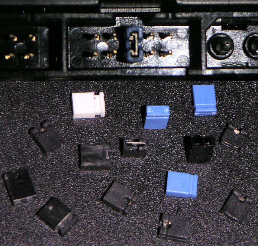

Here are pictures of the suitcase jumpers. The red one is a high end jumper and the others are as used in computers. All are available gold plated. I used the small ones on the DAC I built to place it in the correct mode. Some people call them removable shunts. I call them suitcase jumpers because they some times have that little handle on top.

Thanks Mark, I know what you mean now. I had just not heard the term suitcase jumpers but I can certainly see why you would call them that. I'm doing up a Mouser order right now so I'll add some of those in there.
