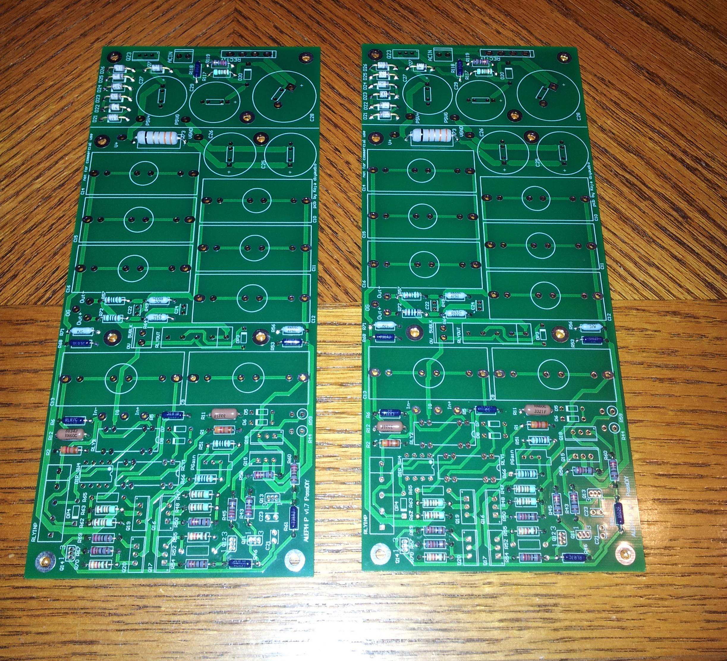

Some progress today... In the Pass tradition I did this work on the kitchen table.

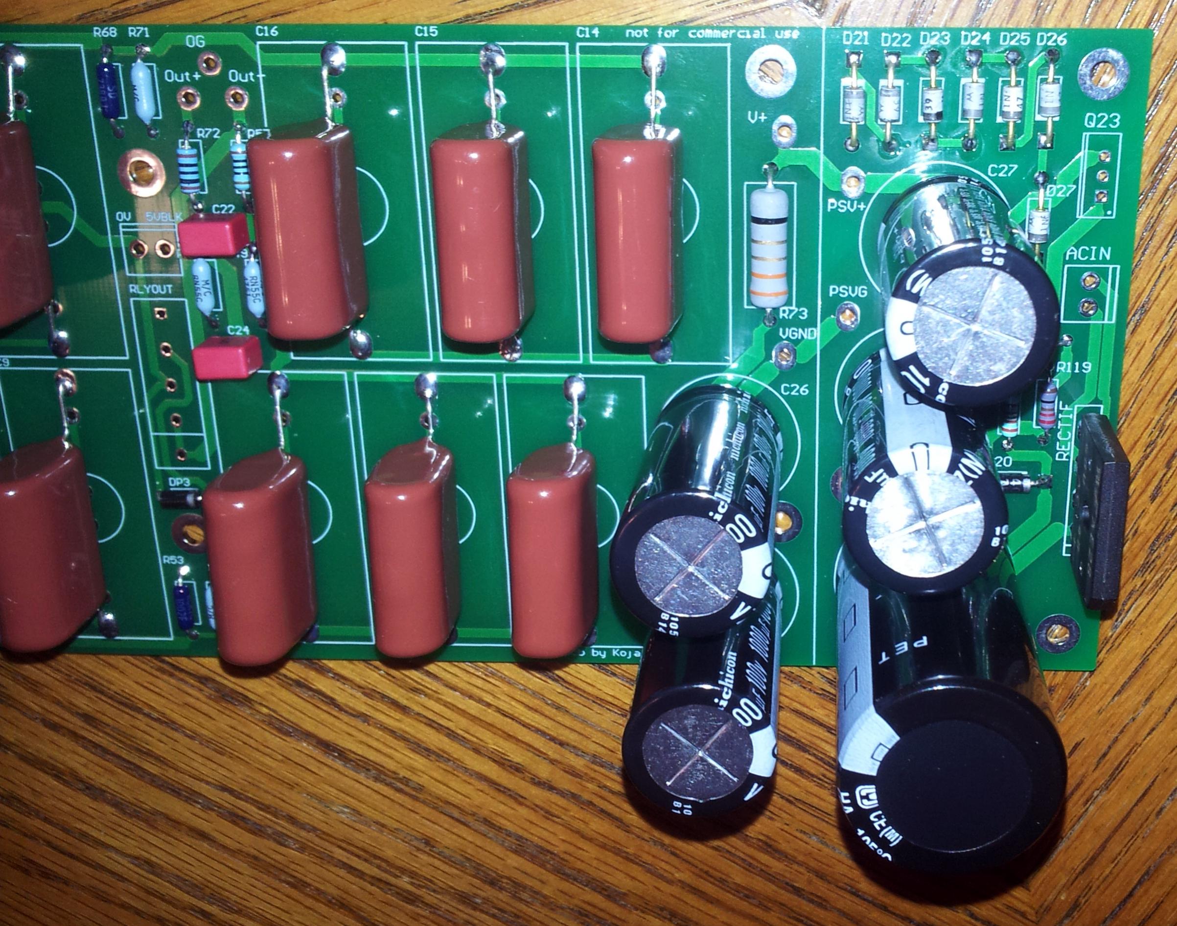

Parts arrived today and some more progress. I am short two 221 ohm resistors which I may have in my parts bins anyway and I still have to solder in the MOSFETS....
Also, if you order the Nichion FKP2D006801D00JSSD 1000 uf - 100 volt (105c) electrolytics these leads fit the pcb pad holes just fine, and these caps are available from Mouser. No need to enlarge the holes as Koja mentioned but I did have to offset the caps on the board to get them to go down as you can see in the picture.
Also, I hope I got the DIP switch oriented correctly. I put switch 1 at the pin 1 mark on the silkscreen....
Mark

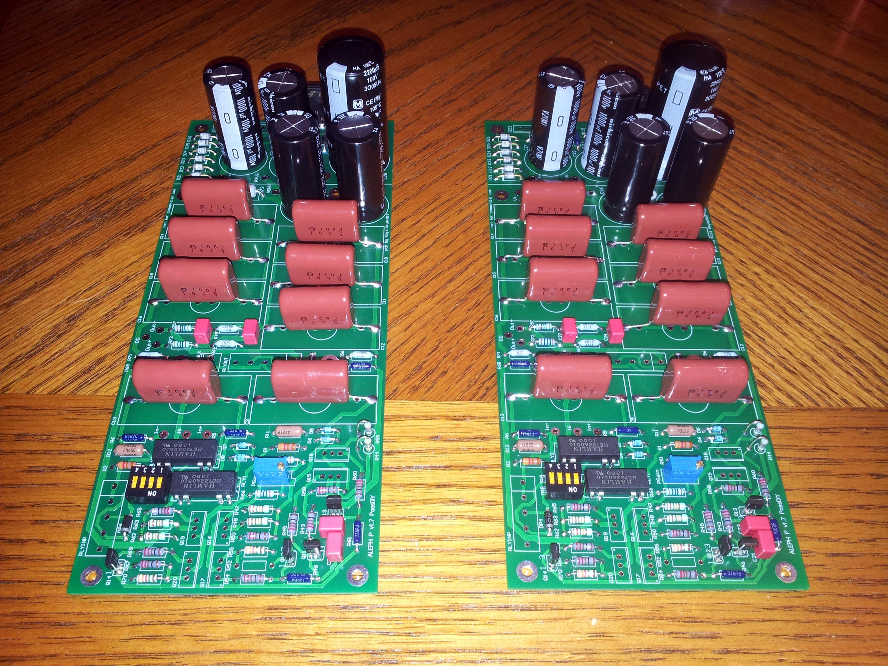

OK. I received yesterday the matched fets from Brian and stayed up late last night. I stuffed and tested one board.
this is the official ALL CLEAR, the board works as intended:).
my only issue was that I have an oversized Xformer driving the regulator fet at high V and I will be screwing the sucker onto the chassis for cooling. my PS zeners also only added up to 58Vreg to supply the preamp. I set the internal gain to 18dB and also checked the three dip switch settings:
min. atten.=max input signal: Switch1 ON, Switch2 OFF: Vgain 18db(balanced)
>>Note: max gain around 21.5dB is available; you may get around 22 with your PS voltage.
both switches (i.e. all input attenuator relays) OFF: Vgain 7.75dB
Switch1 OFF Switch2 ON: Vgain -1.6dB (got AlephP dropping signal because I tuned the internal gain under the max available but turned the max input attenuation ON. I may still change the final settings based on my application).
so this is just to give you an idea before you measure yours.
So my job is finished (except for sending the last few boards), and enjoy your boards!!

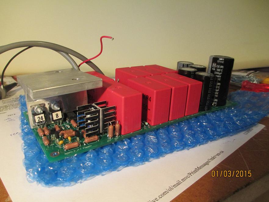

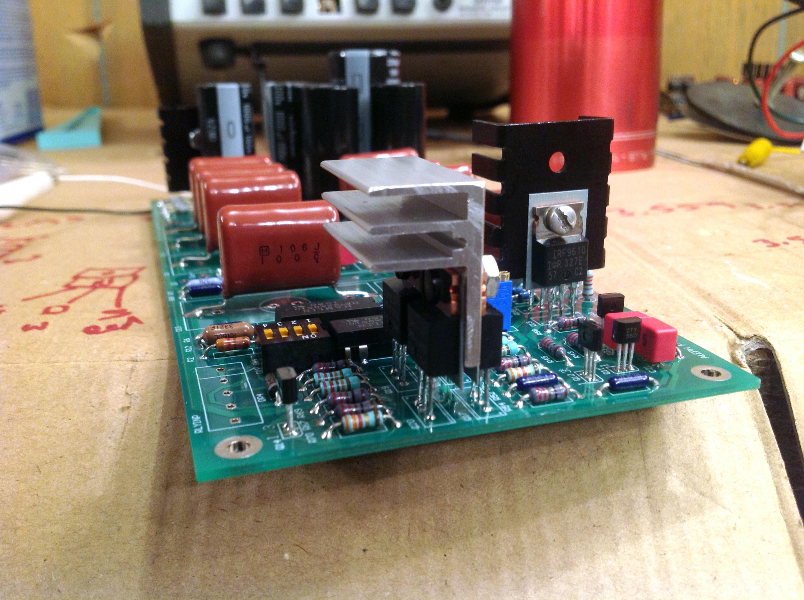

So I have one board heatsinked and its working good EXCEPT my regulator was only giving me 48 volts to the preamp circuit. My raw DC is just shy of 80 volts so that's not the issue. I added one more zenerto the string and that brought it to 58 volts which is very close to optimum. Actually, the IS now 60 volts on the regulator mosfet and accounting for a couple volt drop this is normal. Also, the less voltage the regulator has to drop the cooler it runs. My heatsink's get warm but not hot after a half hour.
Mark
Edit: Fixed regulator problem. One Zener was in reversed. Now I also have ~58 volts.
Another photo which refused to be edited in with the other... Note that I clipped one lower fin off the heat sink to accommodate the vertical pair of resistors... These heatsinks get warm but not hot. I think many builders of this preamp has over heat sinking these things based on images I have seen in other threads. The more sinking you give it the longer it's gonna take to reach thermal equilibrium. Also, note I used thermal pads rather than messy heat sink compound. Assembling the heatsink to the four transistors is a but tricky. When one side is done and tightened up the second side is easier. I also used nylon screws going though the heatsink on the one sinking four transistors. The other screw is going to get changed out for nylon as well. Check each transistor to heatsink for any shorts before you power it up!
Mark

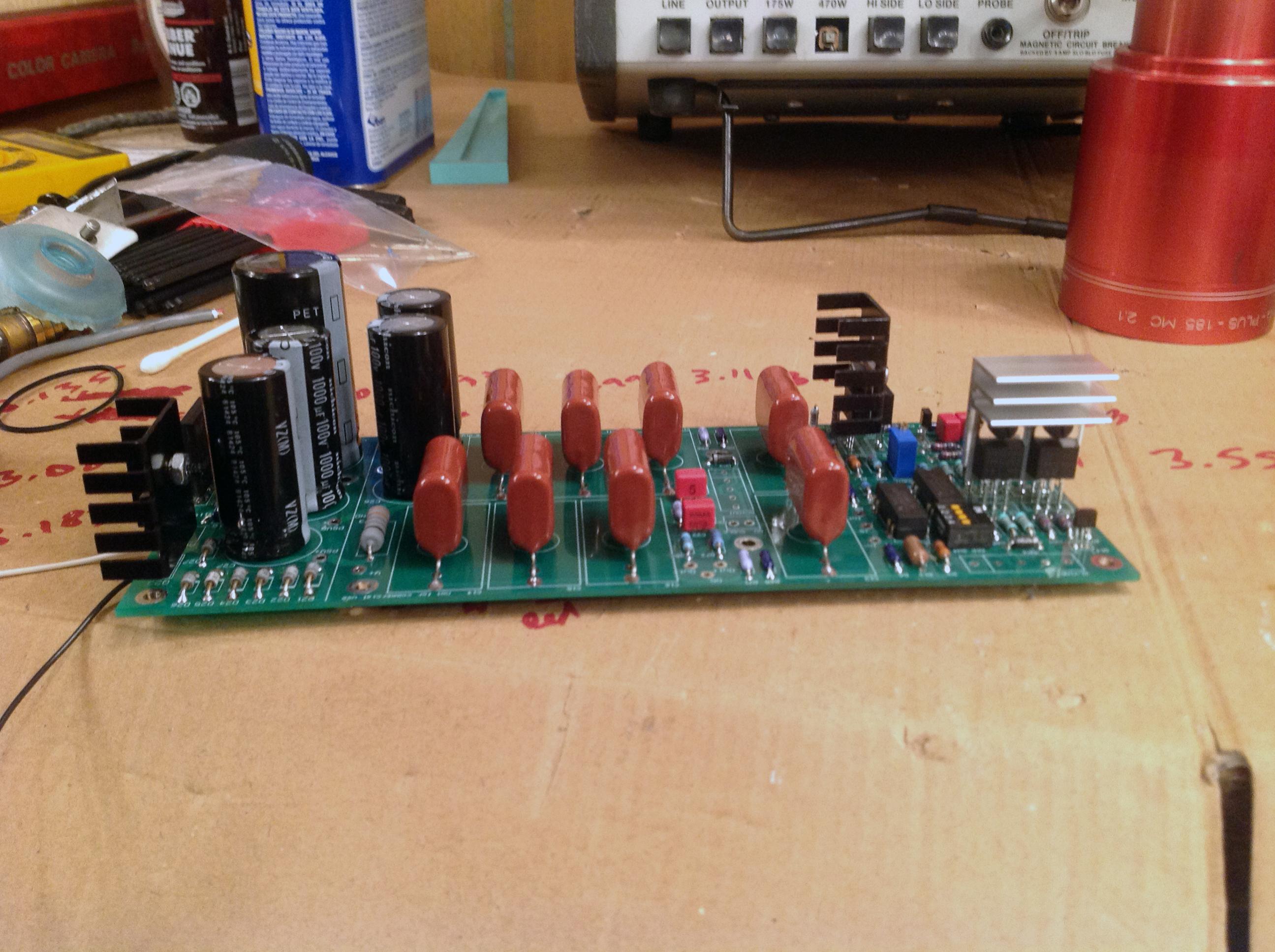

Both my boards work fine. I tested them last night. Can't leave them running very long though as no heatsinks on the matched pairs yet, just on the regulators. I'm making heatsinks today and will post pictures later on.
Mark
If it's built to the Pass schematics you don't really need a heat sink on the matched pairs. I've had mine running un-sinked for 4-5 years without any ill effect.
The originals P17 had all the MOSFETs mounted flat to the board, and only the regulator pass MOSFET's had additional heat sinking. Perhaps diy builders see "class-A" and think it's going to need a heatsink that would cool an Aleph 5?
The regulator MOSFET's definitely need heat sinking.
