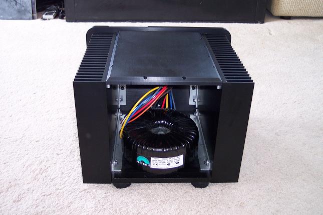

- All panels are machined 1/2" thick 6061-T6 Aluminum except the back.
- 32 microinch surface finish bare aluminum (perfect for anodizing).
- All bolt holes are drilled and countersunk.
- Enough heat dissipation for up to 300 watts total (per chassis) with a 20 degree C rise.
- Back panel is powder coated black 0.118" thick carbon steel with vent holes and all jacks.
Well, if a 2D picture is worth a thousand words, a full 3D rendered model must be worth more like a million. If you want to see all the details of the intended design, please download the CAD program from http://www.emachineshop.com/download/index.htm (it’s only 5.3MB, and it’s free) and open the .ems file at the end of this post. Then all you have to do is render it (click the pyramid in the toolbar) and you’ll be able to see the full design and rotate it and whatnot.
The estimated cost right now for the front, back, top and bottom would be about $350 US per chassis. A single chassis would house a small Aleph, but it’ll take two for the bigger versions All that would be left to buy is the bar stock to hold it all together (about $35), the bolts (about $15) and the heatsinks from R-theta (I paid $45 CDN each for the four mine). Assembly would also be up the buyer, as it simplifies shipping. Just for reference the R-theta heatsink used is model #65340 cut to 9” length.
The goal of all this is to get a very professional looking chassis that will fit most of the larger class A amplifiers people are building. The prices are high, but that’s the name of the game with small run high quality parts. This group buy would be run as a not for profit setup, but I would like to get about ½ off on my purchase for the time and effort involved in such a big buy. The $350 dollar price is based on 10 units (5 pairs), so if there are more people interested that price should drop somewhat. An ideal number for me would be a total of 10 pairs which should land the price at just under $300 per chassis.

Thats a sweet looking case, but for $350 + heatsinks... uh.. thats a bit much. I'm not convinced that those sinks can do 300 watts of heat w/ 20deg C rise either. Sweet looking case though, $300 inc. heatsinks wouldn't be a bad price... heatsinks should almost for sure be bigger though. Just my 2cents.

Sorry for the late reply today, I spent the evening breadboarding my BOSOZ linestage. It sure doesn't look pretty, but it gave me a good evening of listening!
Kilowattski,
Maybe you're right about the overkill size, but that was sorta what I was going for. I guess the general public doesn't budget as much for their chassis as I was ready to. Nonetheless, I went ahead and priced it out again with good old black powder coated 0.118" steel plates for the top, bottom, front and back. The basic layout would remain the same, but just not as substantial. The price break turned out to be huge, since I can get all four panels on the same turret punch sheet. If I went that way we'd be looking at about $180 US for all the plates, both heatsinks included (anodized black to match), and all the bars and hardware. Maybe this would be a better way to go… the top plates alone on the other design were over $100 each! Could anyone else posting comments please let me know what they’d prefer?
Matthew,
The heatsinks with the design are some of the largest I've ever seen anywhere. That includes this site. Maybe the cad drawing didn't really do them justice, but we're talking about an 8mm thick base, 60mm tall fins, and an overall size of 9" by 11". The data sheet gives them a CW rating of 0.5 deg /watt / 3" length, which is a total of 1.67 deg / watt for each 9" sink. An Aleph 2 dissipates 150W per sink, so that's about 25 degrees assuming they're hanging in free air. Once mounted to a chassis made of an additional 40lbs of aluminum, I think the 20 deg. above ambient estimate is pretty safe. The other upside to the sinks is the fact that R-theta was a real pleasure to deal with when I ordered mine. If you have a specific type you'd prefer let me know and I'll look into it, but I'd really rather stick with the spec'd units. If any of my numbers are off please let me know too, and I'll look it back over.

I like the 1/2" front panel and 1/4" bottom (for those heavy toroidals). 0.118 is good for the top and back. Here is a picture of a chassis I built with the configuration I stated. The front, top and back panels are not pictured.

That's a beautiful chassis! Did you do the machining yourself or do you know someone who does it? I'm gonna head back to the drawing board and try to get a price on something with a steel top and back, a 1/4" bottom, and the same 1/2" front in the original design. The fronts are going to add quite a bit to the price, but they really do make for a much nicer amplifier.

One of my neighbors owns a machine shop so I asked him if he could build it for me. He of course said no. But he said he would teach me how to use a Bridgeport and let me come in on Saturdays to work on it. So I built it myself. With the learning curve and all it took 8 months. Near the end he let me use a Bridgeport with a DRO (digital read out) which make it go a little faster.
Here's Aleph 4 in monoblock version using 11" lengths of those heatsinks. They are about right.

It's kind of hard to say how much they cost overall since I ended up doing the machining myself. The raw costs are as follows:
Heatsinks: $210 CDN
Aluminum Plate: $180 CDN
Anodizing: $80 CDN
Hardware: $30 CDN
L-channel: $60 CDN
So that's about $560 before any labor costs.
The L-channel and plate could probably have been found much cheaper at a metal surplus store, but I bought all mine brand new before I knew about those places. If I had to factor in the amount of time it took to machine those plates, drill and tap all 150 some odd holes, and assemble everything, I can honestly say that I wouldn't do it again for anything less than $2000. Even then I think I'd be making minimum wage...

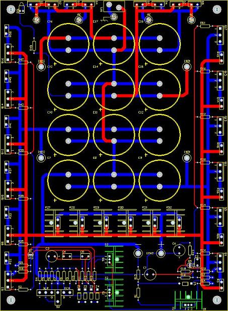

As for the caps and boards, everything will be mounted on a larger circuit board in the centre of the chassis. The transformer slides all the way to the front, and two large Alpha Core inductors (for the pi filter) will sit on the bottom towards the back. The caps are multiple (12 per channel) Elna 10,000uF Audio Grade and they're mounted on the board. I'll include a screen-shot of the PCB for anyone interested. For reference, the board size is about 7.5" wide by 11" long, 2.5 oz copper, and those traces are mostly 100mil.
Any other questions please feel free to let me know! If there are any comments on the PCB I'd love to hear them too.

I don't suppose you could make a few of those PCB's available at a reasonable price?
