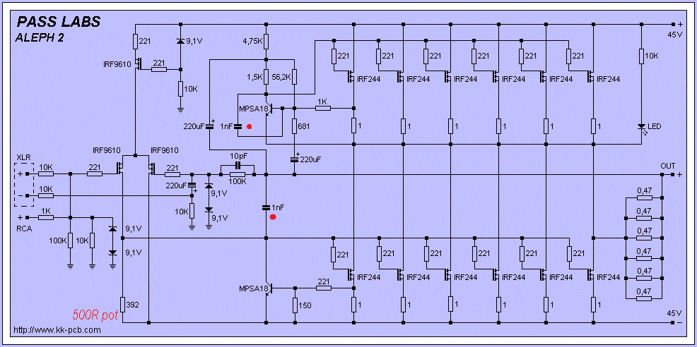

I am fast approaching completion of my Aleph 2 amplifier, and would like comments regarding the usage of IRFP 140 devices.
I will be running about +40 to 45 vdc rail.
According to the data sheet, this should be OK.
My choice for this device is based on nothing more than having hundreds of these devices here ready to go. (Subject to matching).
Could someone please tell me if the usage of this device will be OK?

also - instead of 390R resistor , put 500R multiturn pot (preset to 390 or so ohms) , for fine output offset set
just go for it
consider decreasing gate resistors to 150-180R
observe stability
don't skimp on 1nF anti-oscillation caps
to vivanco - 500mV across 1R source resistors

The circuit that you requested is exactly as shown in post 7.
Also the 1nf caps that I am using are Roderstien metalized polypropylene.
The source resistors are currently 221 ohm, and there is no problem in reducing them to 150 to 180 ohm.
What advantages do you see in reducing the value of the source resistors?

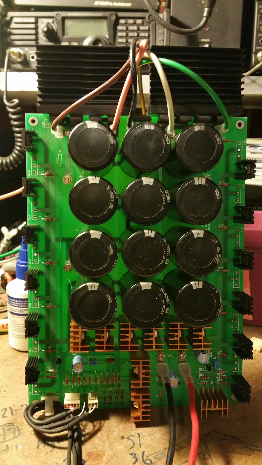

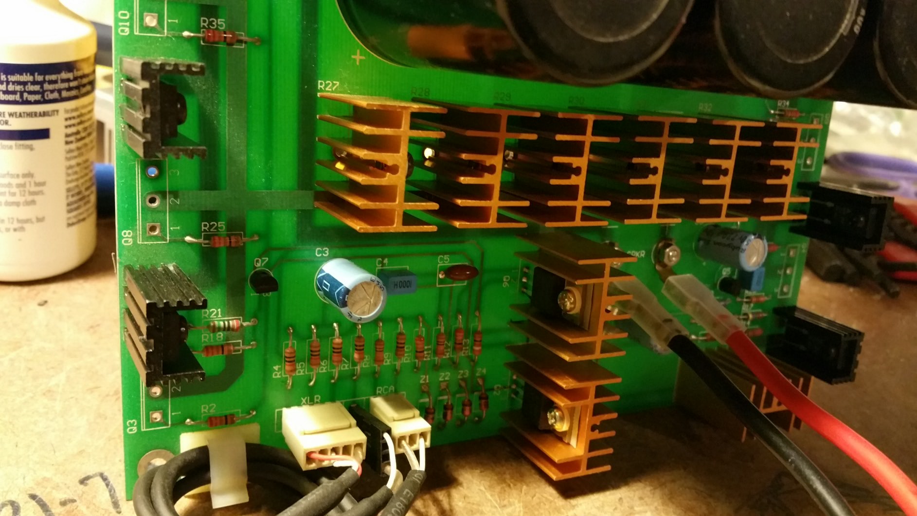

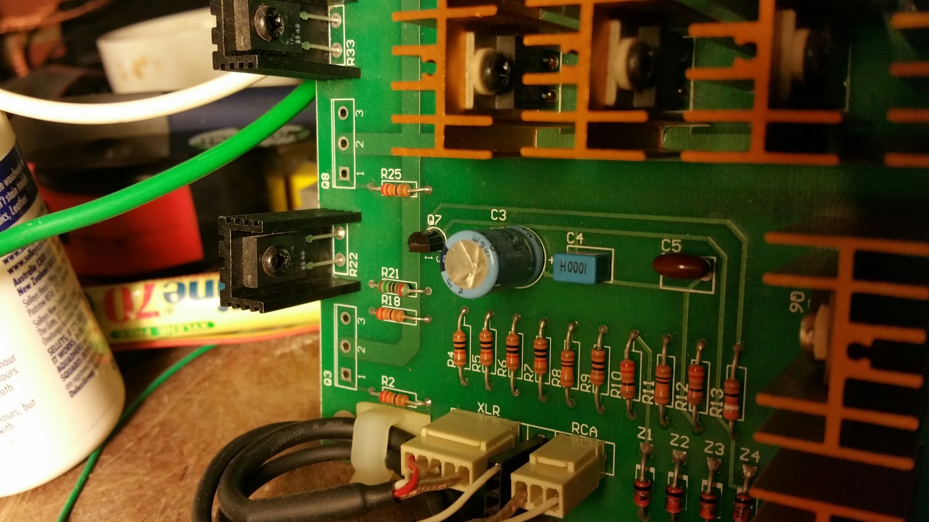

Ps: here are some pics of the boards.

OK , pics still pending
140 is having slightly more capacitances than 240 , also greater xconductance , so Mueller effect resulting in harder (capacitive) load to preceding stage ...... means lesser/shorter bandwidth
to counteract that , decrease slightly gate resistors , observing stability
whatever , I think you're most probably good for.
