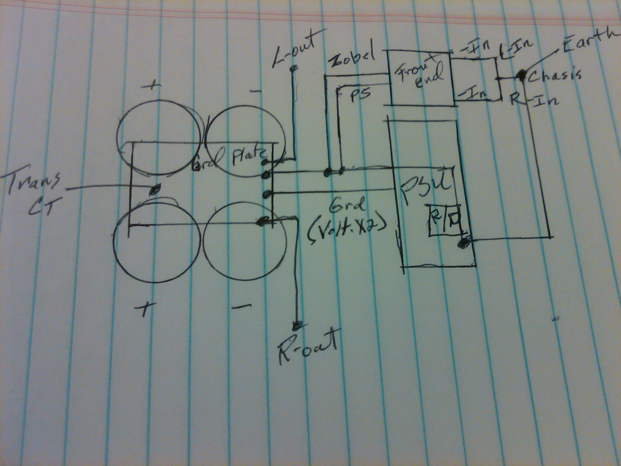

I threw together a quick sketch of my ground scheme this morning hoping someone might point out where I went wrong. I'm working from memory so hope I have everything. As my wife reminds me I can't draw worth a darn.

The input grounds should meet at a star with the front end ground and zoebel grounds. Right now you have them isolated by the diode//R. If you have XLR connectors Pin 1should go straight to the case, but the rest of the circuit's grounds should be on the other side of the ground loop breaker.
As long as I keep the input, frontend and zobel grounds together does it matter which side of the diode/R they're on? Up until last week I had the input ground connected to the same star as the frontend and zobel.
The diode//R is a ground loop breaker. It is only necessary IF there is a problem. Theoretically you should be able to ground all equipment to the chassis star. Suggested reading David's grounding article Audio Component Grounding and Interconnection - diyAudio

Over the weekend I went out and bought an outlet tester as you suggested and all the outlet tested fine. The extension cord from another outlet made no difference either. Still a buzz. I checked the house earth ground and cleaned things up where it connects at the water mains entrance to the basement. It was pretty corroded. Still no change so have been doing alot of research on amp grounding keeping in mind how I have my grounds connected. The one thing that concerns me is that the Reg PSU ground is in the path to the chassis / earth ground connection, which puts it directly in the downstream path of the high current ground to chassis. If I understood what I read correctly the high current ground where the main unreg PSU caps and transformer CT is connected should be the connection point to chassis. This puts the Reg PSU, input, and frontend grounds upstream of any ground currents flowing to the chassis ground.
I realize that in the end it'll all come down to what works the best so it's becoming an exercise in test and trial. Because of the amp layout and physical distance between the AC earth ground and possible main cap/CT chassis ground points I'm wondering if it's acceptable to have the earth and circuit chassis grounds connected at 2 different points. Everything I've read states the AC Earth ground should be connected to the chassis with the shortest possible wire. Any thoughts / comments?

Sounds like a slight variation of Figure 4.8-1, using the chassis as the link between the system and safety ground. It should work. You can also isolate your system star from the chassis and use a 16 gauge or bigger connection from the star to the chassis at the same place as the safety ground.
