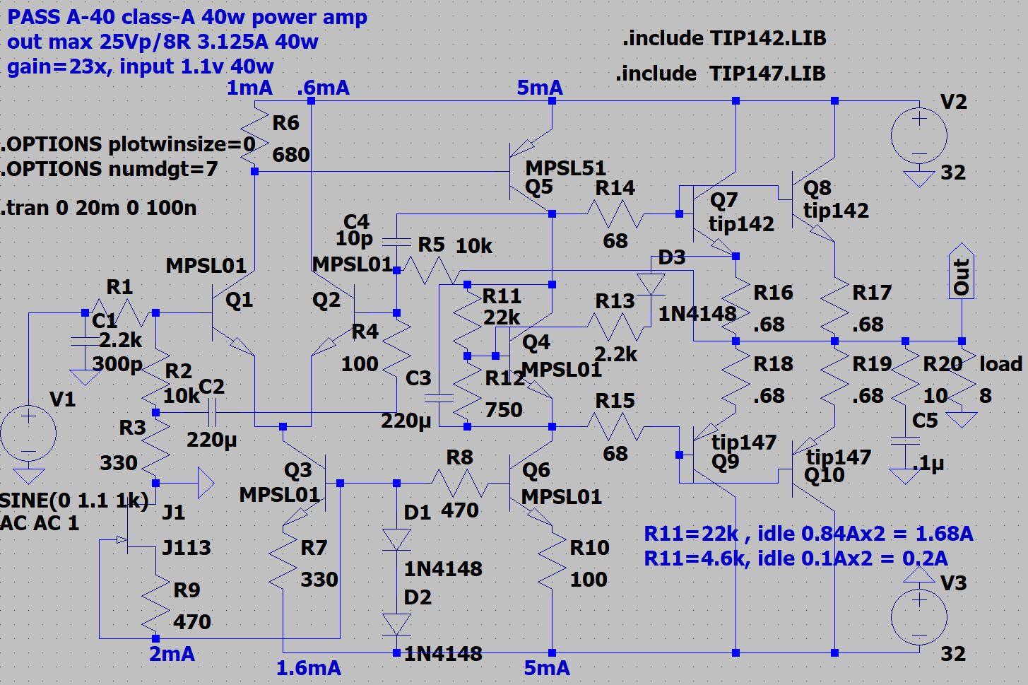

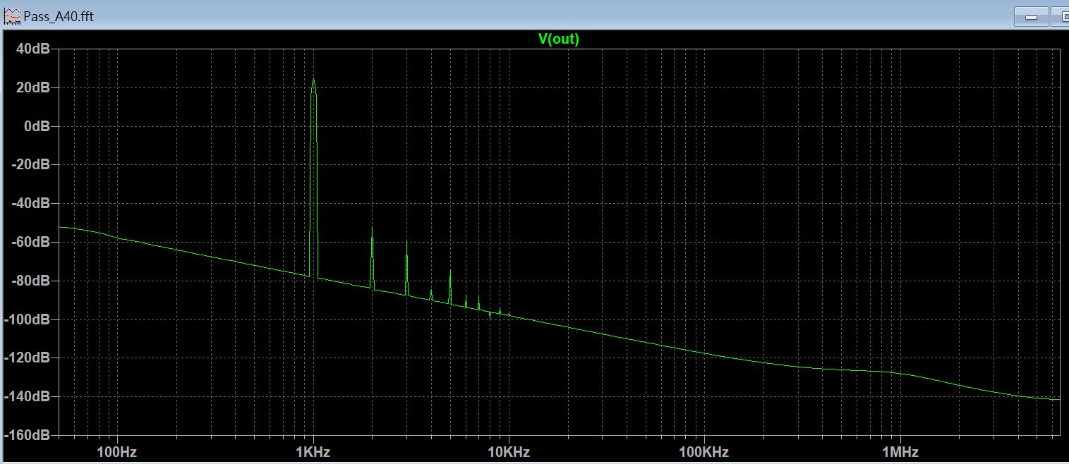

PASS A40 LT SPICE results?
LTspice PASS A40
A LTspice simulation file as attachment if any one need reference.
