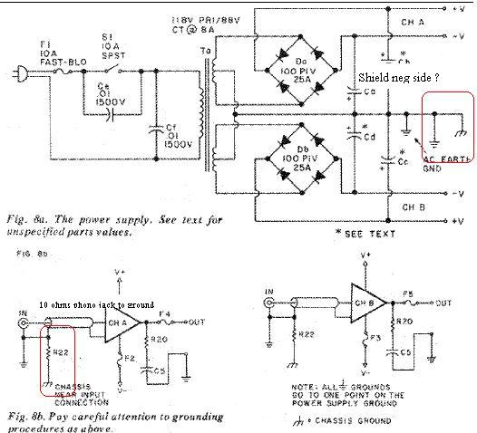

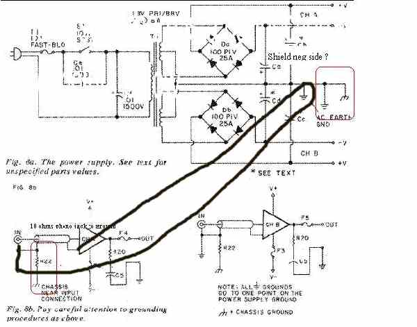

OK this one I understand and will do as suggested
This one is more difficult for me to understand. I looked at the PDF on passdiy but can't figure out what do you mean with "shielded (negative) side" and how it should be connected. I attach a file for better precision. Thanks anyway & I look forward to the picture
gpsmithii said:
There should be a 10 ohm resistor connected to chassis ground very close to the input phono jack (itself isolated from ground).
gpsmithii said:
There should also be a connection from the shielded (negative) side of the input wiring to the center of the power supply.
Re: Hum in A40
OK ... In the example you posted it shows the connection from the ground or shield side (incorrectly stated negative) of the input connector to chassis ground through the 10 ohm resistor. It also shows a connection to the circuit ground i.e. power supply center. I have worked on several of these gems over the years and many times the connection is not made to the power supply which is where all circuit grounds should end up or the connection is a cold solder joint. Sorry for the long answer. Hope this resolves your low level hum.....
Re: Re: Hum in A40
Hope this will help .... Make sure there is a connetion back to the ps center from one of the two choices (in addition to the resistor to chassis) not both or you will have a ground loop...
Great, I reckon I get it now. Your explanations are very clear for me. I'll revert for the results

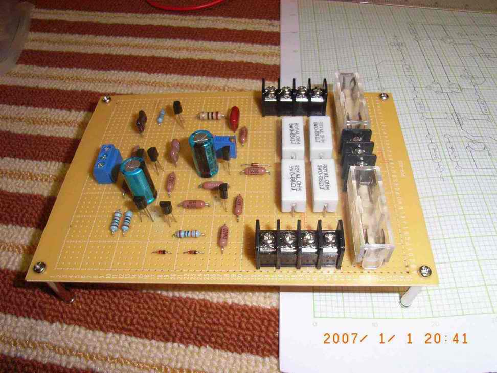

Can I see 2-3 pictures of your A40 . . . ?
For my good references . . . A40 is one of my future projects . . .

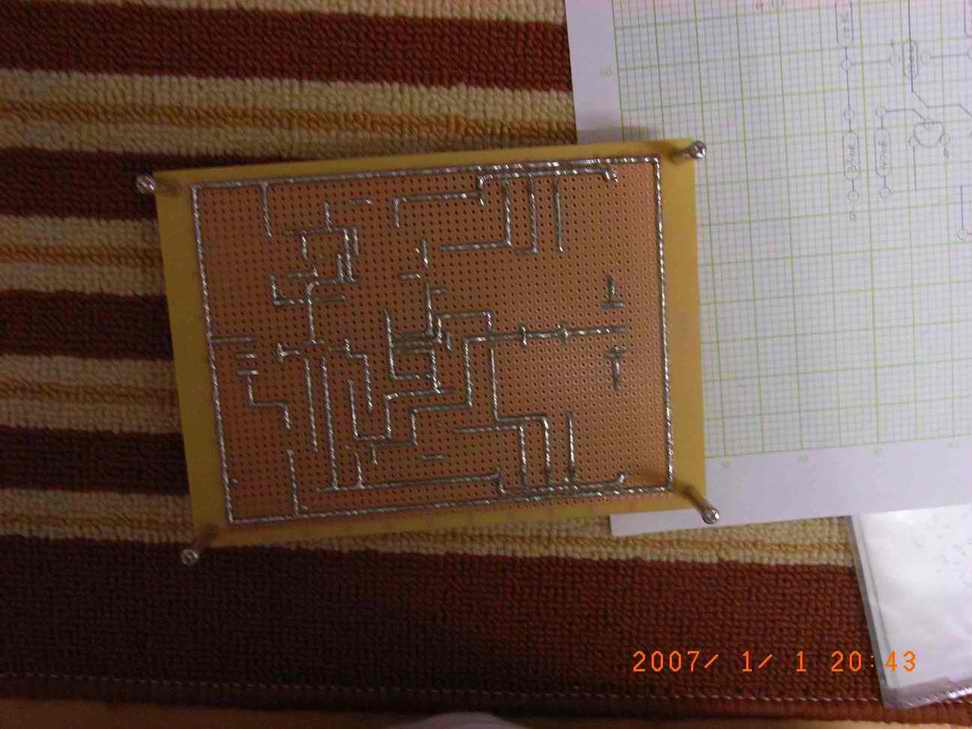

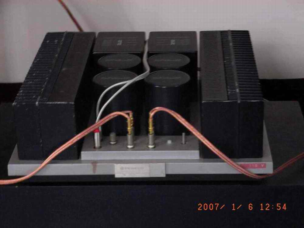

I finished building the Pass A40W early Jan 2007. I feel very happy with the sound quality of this amplifier. I use MJ11015 & MJ11016 as the power transistors. My A40 did not has any hum problem at all. My new plan is to add more power transistors to the output stage of the amplifier maybe 5 to 6 pairs per channel.
Pass DIY Addict
Joined 2000
Wow, that is one packed chassis! Nice work and glad to hear that you are enjoying a working amp! I thought about tinkering my a40 some more, but then decided to move on to the aleph-X next.
Eric
Eric
Pass DIY Addict
Joined 2000
Ahhh, the tube-amp look for solid state stuff. I like it! I've seen a few others designed like that. I think Mark Finnis also has an a-40 that is modelled after a tube amp.
Its no wonder the bottom side looked so busy!
