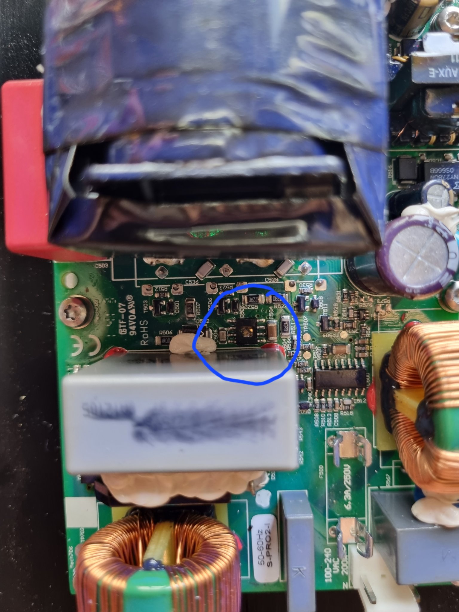

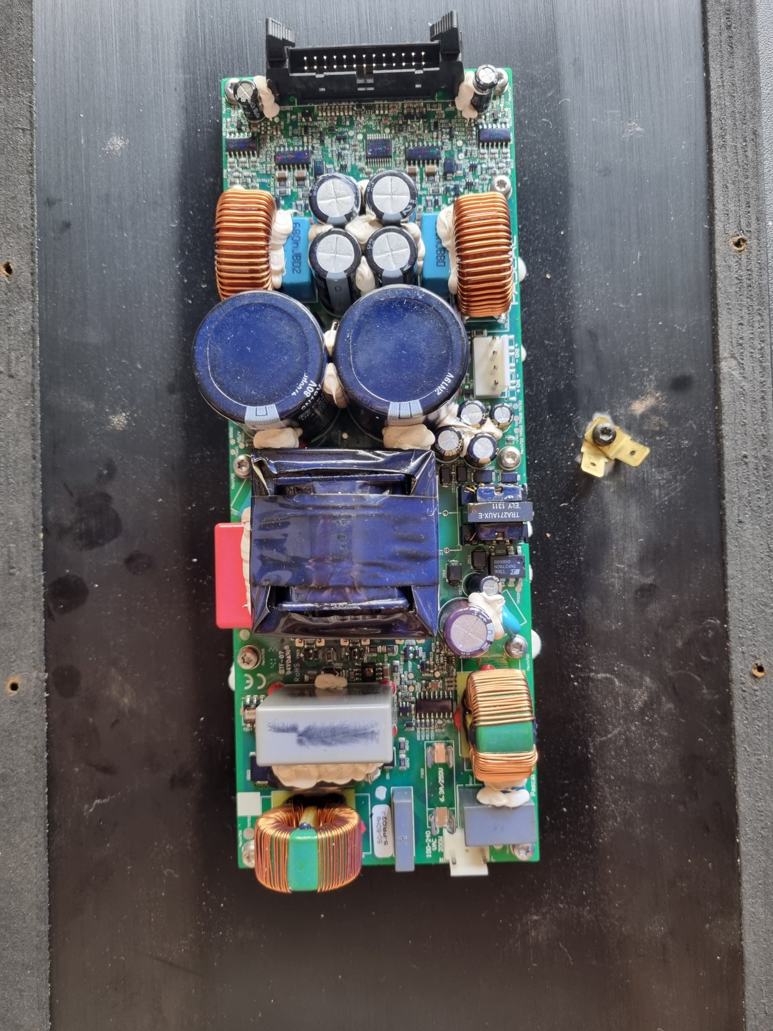

I was using this module in a Professional Audio Subwoofer. One day it blew and certain small components were burnt such that they are unidentifiable. I am a certified Electronics Technician and would like to have the chance to repair my module,. If you have this module in your equipment and you would like to help, please help me identify the following parts. I need to know the values/part numbers of the following components:
TRANSISTORS
T503, T506, T509, T511
DIODES
D502, D504, D506, D508, D520, D522
IC'S
IC501, IC505
RESISTORS
R500, R507, R511, R520, R527, R576*, R573*
CAPACITORS
C138, C205, C229
Thank you for reading. Let me know.
TRANSISTORS
T503:
T506:
T509:
T511:
Seems like they are all marked "718" some (most) of them are completely impossible to read.
DIODES
D502: ON J49 U1J
D504: Most likely A6
D506: Most likely A6
D508: Most likely A6
D520: Where is it?
D522: 440A 8FIXD
IC'S
IC501: 1811 TNY278GN 7A421C
IC505: Where is it?
RESISTORS
R500: Where is it?
R507: 10RD
R511: 10RD
R520: 22RD
R527: 22RD
R576*: Where is it?
R573*: Where is it?
CAPACITORS
C138: Where is it?
C205: Where is it?
C229: Where is it?
Unable to find C229 but R229 is 10RD
Hope this helps, it's been well over a decade since i worked in a lab with stuff smaller than this but nowadays it's just a non-priority hobby so no microscope or fancy equipment anymore.

Hi Thabto, how its going?
Did you finally repaired your module?
I have one on a Das Audio Vantec 18a and it burned out due to high voltage…
Can’t find any transistor burnt or something. I wrote to pascal and their response was the same as yours (copy paste)…
All resistors are ok and Dsp module is working fine so voltage is going thru the pascal module, but it doesn’t work.
I think the main failure is on switching IC’s UCC2893D and IRS21867S.
Did you found a solution?
Greetings!!

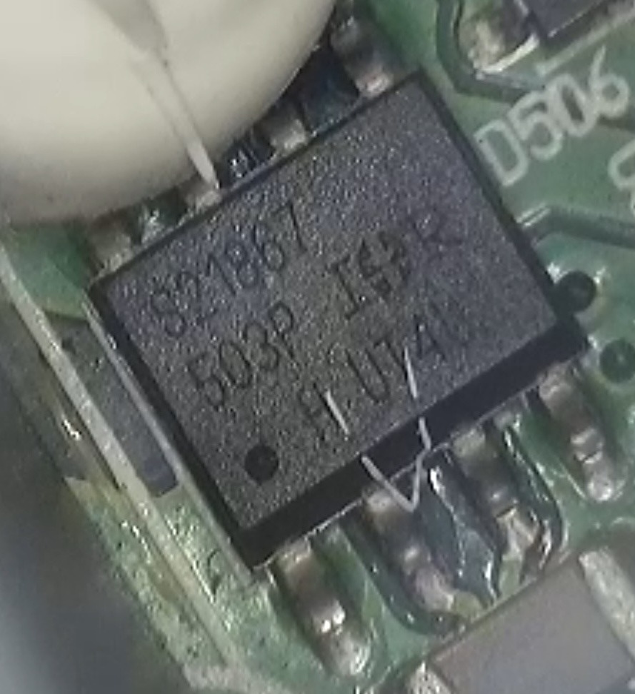

Hello, does somebody has a pascal s-pro 2 amplifier module? I have one but there is an IC that blew, i can't read what is on top of the IC. Could somebody send a picture of say which IC that this is?
