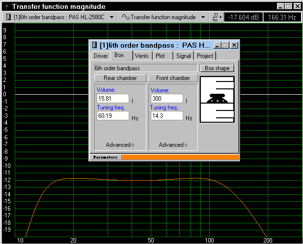

The 2580C is big enough for me! anyway, in a 6th order bandpass box it seems to tune up better. I am throwing away lots of sensitivity though. From 99dB down to 87dB.

So, what's the TS Parameters of the 2580 C?

OMNIFEX said:So, what's the TS Parameters of the 2580 C?

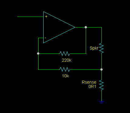

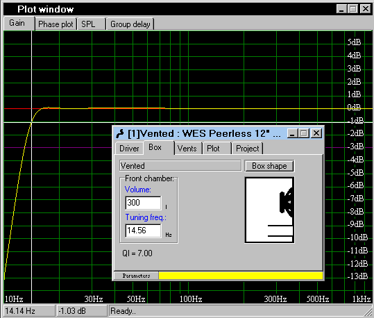

Nahh... Actually, I'm looking long and hard at this Peerless thingo now. It's Qts is 0.21 but if I can raise it to 0.5 by upping the amplifier output impedance a bit then I think it will be a winner. In a normal 300 litre vented box - woohoo! 😎

Circlotron said:It's Qts is 0.21 but if I can raise it to 0.5 by upping the amplifier output impedance a bit then I think it will be a winner.
A) Is upping the amplifier output impedance a good idea?
B) Are you going to do this using tubes or transistors?
C) How are you going to do this?

a) As a random thing to do, no. But if it raises the Qts to a more suitable figure of 0.5 then yes, I think so.
b) Initially a pair of LM3875's that I am already using as a sub amp.
c) see diagram. Instead of returning the - input of the amp to ground as usual, put it to the top of the current sense resistor. For a given output voltage, if the positive-going load current increases then the top of the sense resistor goes a little positive. This voltage is fed into the - input of the amp via the 10k resistor and amplified x22. This causes the output voltage to droop a bit with the increased output current, just as if there was a resistor in series with the output. The output impedance can be varied by altering the amount of current-sense resistor voltage fed back into the amp.
Of course, I havent actually built one yet... 🙄
