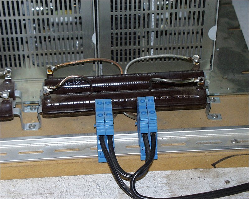

These can be used as current limiters in the B+ line or for dummy loads. I typically have 2 of these in series and a second series pair that I parallel for lower resistance loads.
For higher power, I use higher power resistors of the same basic style.

Yes. Wirewound but they don't need a heatsink and can take far more than their rated power, especially when fan cooled.
People can choose what they like. This is my preference. I used them for about 30 years and they worked beautifully.
