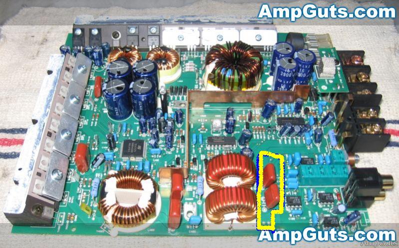

Im gonna place a parts order with future electronics soon..
Wondering if anyone can help me with a couple of part numbers..
First off i need theese caps as show in pic they are marked 475K 63 volts..
I cant seem to find a part number for them on future electronics website..
Then next is an A1294 ( output) canty seem to find either
Any help would greatly be appericated..
475 is 47 followed by 5 zeroes pF or 4700000 or 4,700,000pF or 4.7uF. Look for Panasonic polyester capacitor with 4.7uF value and 63V voltage rating, on the Panasonic site or a distributor's site, and there should be an orderable part number.
