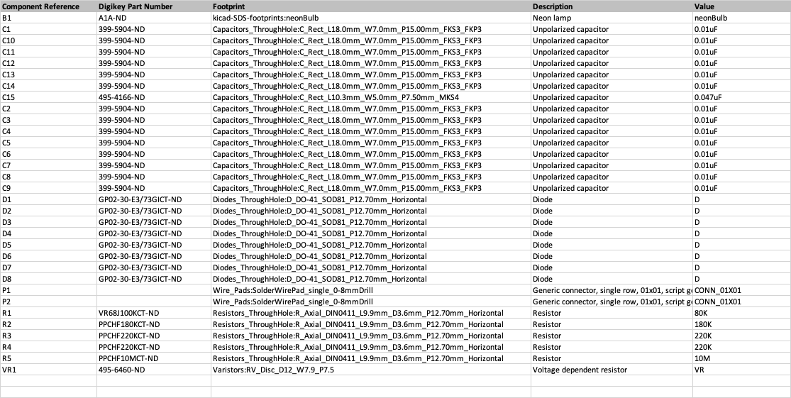

@stokessd do you have any more information on these replacement PCBs / parts lists (any additional ones for the clamp board)? I have at least one EHT that needs to be rebuilt and a fresh pcb without the wax sounds like a good idea.The fact that the caps are physically disconnected from the panels when the neon isn't lit is a pretty compelling argument for not being too concerned about the HV caps. Films won't hurt anything, but don't expect any sonic improvements. The trick is to find films that would fit on the board. You can lay out a new board with films and then everything is good.

Here's the schematic and BOM for the HV board. With the supply chain issues, you will probably have to substitute some parts. The diodes are hard to get, you may need to use a different brand etc.
Also I haven't built up a set of these. They are simple and should work well, but Caveat emptor.
Sheldon

Great, thank you for sharing!Here's the schematic and BOM for the HV board. With the supply chain issues, you will probably have to substitute some parts. The diodes are hard to get, you may need to use a different brand etc.
