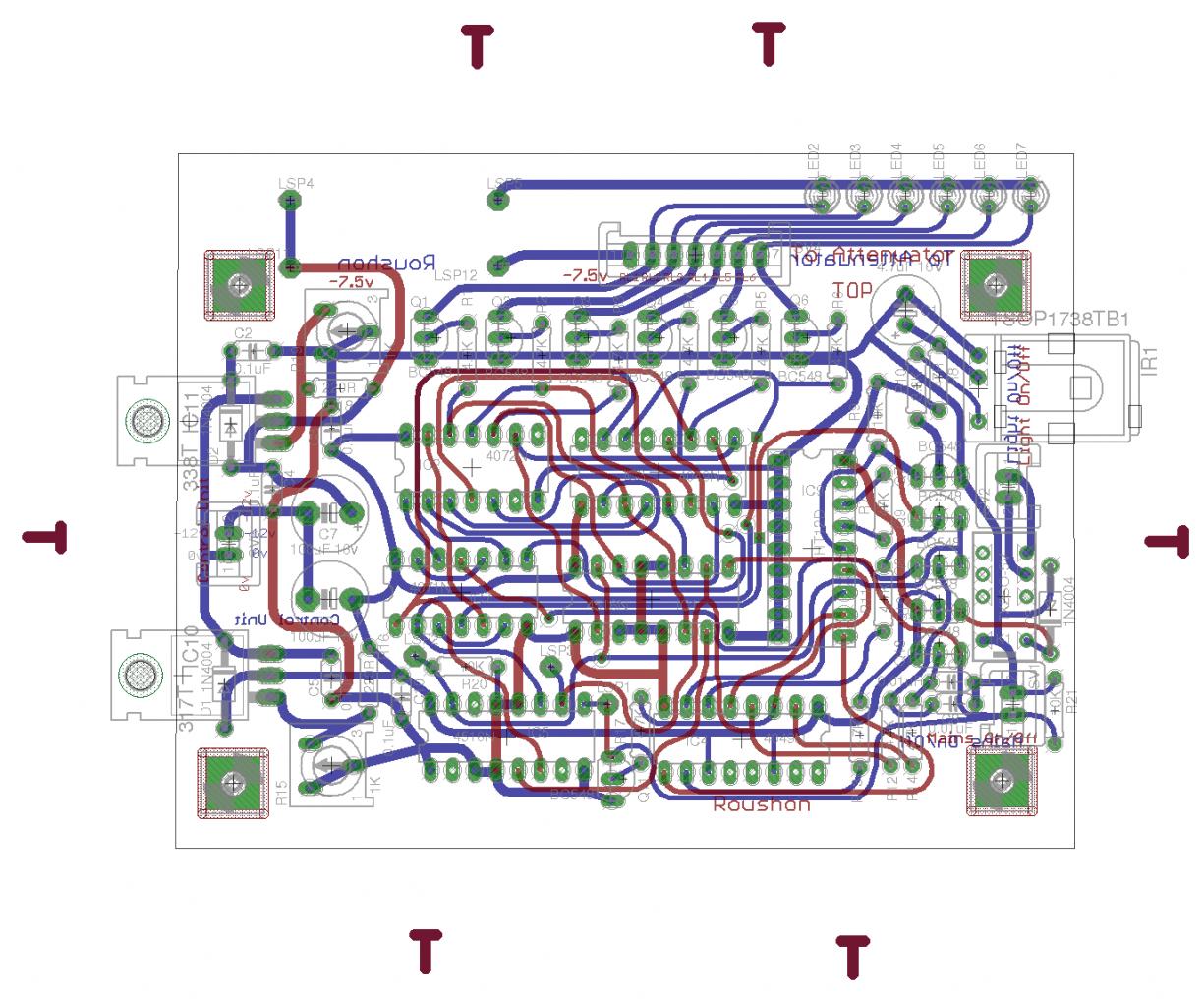

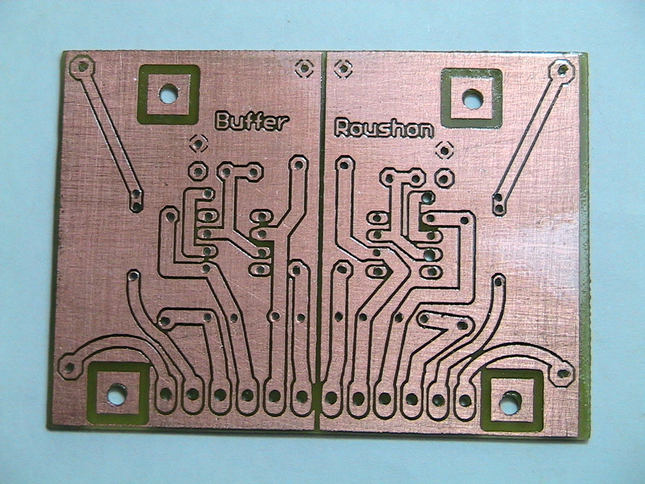

Toner transfer
For years I struggled to make my own PCB as like most of you. In a post
in this thread I gave the details of the chromo paper I finally found
in a shop in Flora Fountain area for toner transfer. Believe me I have
made at least 30 PCB of fine quality by this method. Two examples are
attached. Some of them are for SMD parts and most of them are double
sided. It takes only 20 minutes for a PCB if you uses hot ferric chloride
solution. This is to show and encourage you to another fruitful method.
One drawback as pointed out earlier about getting good laser print.
But in south Mumbai I got very good print out in a cyber cafe. May be
look around little bit more.
I promise to give you the address of the shop in Flora Fountain
in a few days. The chromo paper costs 400 sheets Rs 120/- only
two years back.
I hope you find it useful and saves your time...
N.B. Sorry, I do not have the picture of the pcb of the first board but it is
exactly as you see in the eagle design.

You have really got very good quality transfers, very nice. Not everybody has not been as lucky as you.
dont use ferric chloride for etching , very bad chemical and you need to keep it hot.
instead try hydrochloric acid 2 parts + with hydrogen peroxide 1 part, very clean etching, You can use it many times, does not stain,And is pretty fast, is clear so you can see how much has been etched. No heating required.and you can easily dispose it.
Thanks a lot for the suggestion. I knew about it but never tried. Will use in
my next project. Yeah, the heating part was tricky. I had to make a special
arrangement with a small water heater to do the job.
Regards
Roushon.
Yeah, the heating part was tricky. I had to make a special arrangement with a small water heater to do the job.
Is it possible to upload snap of your spl heater arrangement.
I always failed with DIY pcbs.
those look professional. what is the smallest track size possible? 8mil track?
Yes, it looks professional. I did not believe it myself
when I first made these pcbs. The special arrangement
is too simple and embarassing to give a photo. Next time
when I make a pcb I will take several photos and upload.
Let me describe how I make the pcbs in detail with the
above chromo paper.
1. First take a dark enough laser print out of the
design on the glossy side of the paper. Do NOT touch
the design by hand at all and cover it immediately after
taking the print out so that no dust falls on it.
2. Cut the clad board in proper size and then rub/wash it
with vimbar soap and a scotch brite very hard. Do NOT
use steel wool or anything metalic to clean (can use a
file to smooth the sides after cutting). You will get a
very clear glaring coper side. Do not touch the copper
side any more after the wash. Dry it very well under fan or
a hair dryer.
3. Place the print of design on the copper side and
wrap the extended paper around the lower side of the
paper so that it does not slips out of the surface.
4. Iron it (cotton heating slection) first slowly and then
press hard for about 3-4 minutes uniformly. Somtime
tilt the iron a little and press by the edge of
the iron, this is very useful. This needs practice.
5. Drop the board on a bowl of water. Careful it is
extremely hot. Do NOT lift it holding one of the paper
corner. Rather iron it placing on a piece of cloth and
then lift the cloth and drop the board in the water. Leave it
for about 10 minutes. Then slowly lift the paper under
running water (take the help of the force of the water to
peel the paper). NO too much force. The paper will come
out clean without any trace of the toner. Still do NOT
touch the board. If you want to do some forgotten work
(like writing names) or small correction you can do it with
permanent marker pen. Once this is done then your work
is 90 percent successful.
6. In a bowl of ferric chloride solution place a deep plastic
cup filled with clean water and put a small water
heater into the cup and heat and move around the
cup once in a while to distribute the heat. 50 to 60 degree
centigrade is good enough. Heating is needed only to
make the process faster. If you do not heat it will take
longer time that's all.
7. Drop the board and shake it once in a while and
monitor it, do NOT go away to do some other work. It
takes 5-10 minute depending on the heat and the
density of the ferric chloride.
8. Take out the board when the extra copper desolved.
Do NOT keep it longer as it will start eating up little
of copper below the toner.
9. Once again bring back the scotch brite and vimbar and
give a very hard cleaning, you do not need any chemical
to remove the toner. Then dry it and drill it and again
clean it.
10. Finally spray it (or tin it) with the pcb coating which is available
in the Lamington road (Visha Electronic). A big spray bottle is
around Rs 300/- if I remember.
11. Happy soldering......
You can make pcb with very very thin line. I am unable to say
about how much mil but as long as you get good print out and good
steps 4 and 5 anything is possible.
Roushon.
clean it.
Roushon.
