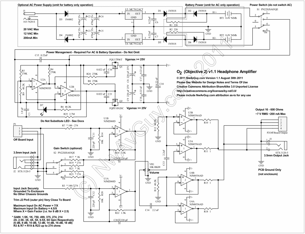

BTW has anybody built (or going to) Objective2 (O2) Headphone Amp?. If yes pls PM me as I'm stuck for want of DIP8 JRC4556AD Opamp(N.A. in Mumbai)

Thanks for your kind reply, the NE5532 (or JRC2068D) will be used for gain stage
- but JRC4556 (100mA peak current into 150R) is simply double of NE5532(50mA peak into 600R). The JRC4556 are needed to drive h/p as low as 16 Ohms.SOIP JRC4556 are available in Mumbai but they get hot above +/- 7V.
availlyrics
Don't bother to search for JRC4556, not worth it. Anyhow, these r dual 741s, so just buy two metal can 741s of good specs/mfr and fix it on a dummy ic socket.
availlyrics
Can you share the circuit diagram with us, so it would be easy to suggest you.

AD8273ARZ Analog Devices | Current Sense Amp Dual18V | 709-7095 | Welcome to RS Online
Check If you can configure this Op-amp for your need.
I've been following nwavguy's blog for quite some time(He has stopped updating from last May 2012 though). The objective analysis & measurements plus comments are very exhaustive & in depth but at the same time very "enlightening". A must read for all DIYers.
For detailed explanations-
NwAvGuy: O2 Details
Dispelling opamp myths-
NwAvGuy: Op Amps: Myths & Facts
Objective measurements of different opamps-
NwAvGuy: Op Amp Measurements
nwavguy a.k.a. RocketScientist thread-
http://www.diyaudio.com/forums/headphone-systems/193977-objective2-o2-headphone-amp-diy-project.html
I've got PCBs for the same from jtkam at diyaudio.(a kind DIYer from Canada who has given away more than 100 PCBs free all over the world with the only condition that 5$ per PCB be donated to diyaudio.com & a postcard to him. Well that might explain my "single star" status)
If any body in Mumbai wants to hear this headphone amp(I'm going to build with smd JRC4556 for the time being), they can PM me.
