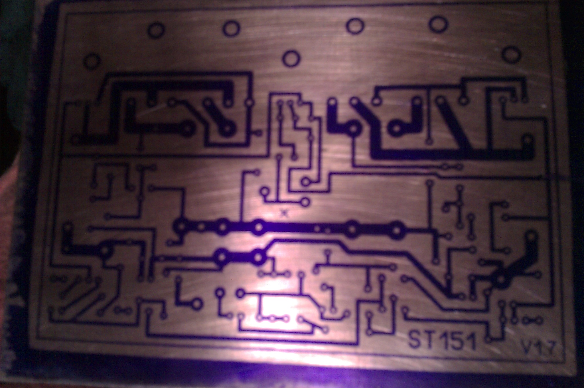

my friend has a chemical that he says glue.he paste the glue on pcb and then he put the negative on it and then he put under sun exposure for 10 minutes after this he dip the pcb in blue colour .the image engrave on pcb.but question is that when the pcb is etch the image is also dissolve .ferric chloride etch both image and non image .How can we make image strong that prevent from ferric chlorde.some people says to dip in naoh i am cofused to know how it is possible and what is the chemical name of that glue.can any body help me .

Dear Masood,
Would you like to try toner transfer method, that is with
iron and a laser print out of the pcb design? The procedure I described in
this thread in very details. It is cheap. I also gave a complete address of
the shop where you get the chromo paper in Mumbai. They will send you the
paper by post if you prepay. In case you have difficulty in getting the paper
PM me with your address I will post you some paper. You do not have to pay
anything. I purchased a 500 sheets bundle in Rs 120/- and most of it lying
unused.
Best wishes
Roushon.

If you cannot do it using a Laser printer and electric iron + HCL ( floor cleaner solution) + Hydrogen peroxide from a pharmacy, then better to give it out to the numerous companies who advertise in EFY magazine.
The screen printing method is useful only for making large quantities AND VERY messy ! Waste of time and money too.
Method mentioned above ( HCl + H2O2 ) is on this forum. Do a search.
