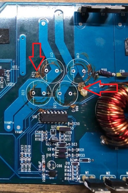

What is the purpose of these ceramics and what could be the possible values? (Rail caps are 50V so I am guessing these will be 50V as well)
I'd use the highest voltage available for the allotted space but a 50v would be OK.
For many instances like this a 0.1uf is used. It's fairly universal. The attached manual shows a circuit that was designed by Zeff (or a copy of his design). You can see that they use 0.1uf. The board is different and they use a 150v.
