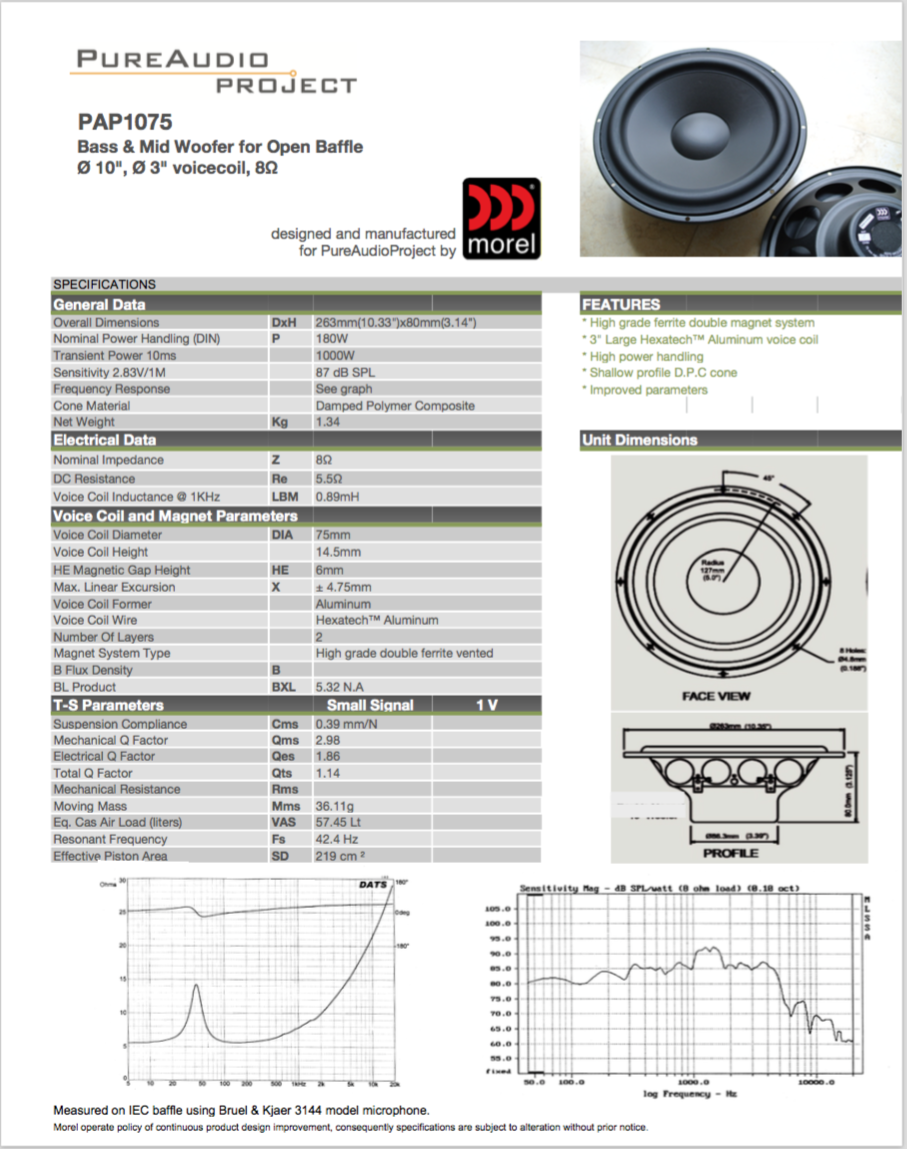

No go. 🙁 The "Web Nazis" block me. What is the nominal impedance? What is the claimed sensitivity?
How about this image?
That helps. The driver is nominally 8 ohms and supposedly 87 dB. sensitive. Applying Joppa's Rule yields a 32 WPC requirement. You should be OK with either EL34 or 7591 O/P tubes.

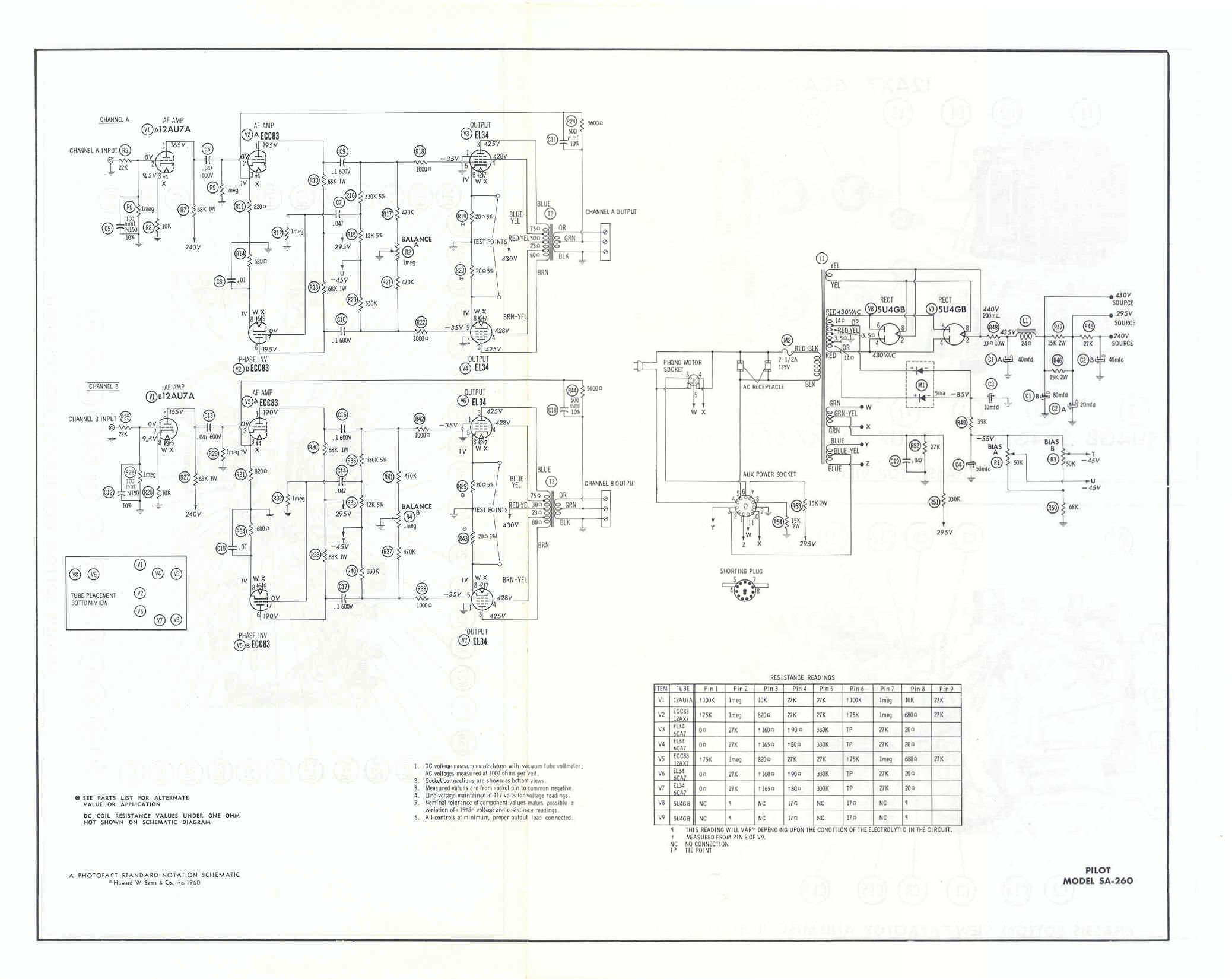

This amplifer is not a very sensible design.
I like the boards that Super8 audio makes as they are high quality boards but the Jadis circuit is silly..At the very least,the 12AX7 should be handling the voltage amplifier duties and the 12AU7 should be the driver especially since you are driving an Ultra Linear circuit. if this was pure pentode,you could get away with it but not with UL.

That sounds awesome! I am not that limited, but i can get all parts except the tubes for free, so it gives me some space to do what i want to do. I just want to keep it as lean as possible, so a PCB is a must as i do not want to get into the process of making a ratsnest with wires. The range i want to work in is ~400$, which should give me enough space for tubes and trafos and a home-made chassis. I do not intend to use my Class-D amplifier, i really just want to output some power from the tube amp and use that in an isolated setup from a DAC or direct line input.
Take a look..It can work but it isn't the best way to do it with UL.. Pilot and others were selling their preamps to go with their amps and it was probably a marketing thing.
I have to be honest and say that i fell in love with the price and quality of the PCB (even though its just a picture on the big web). But now i see the issue.
Even with my limited experience with tube amps i can see this is not a good design. There are many designs that are way better and free to check. Even with extensive description how and why like those on the Lundahl site and others. Better build those in stead of this bad design.

Interesting! I assume its this link you are referring to: Schematics ⋆ Lundahl Transformers
Indeed. Those are designed by experienced people, wel tested and work. You can use other transfo's than the expensive lundahls mentioned, as long as they have the right specs.
