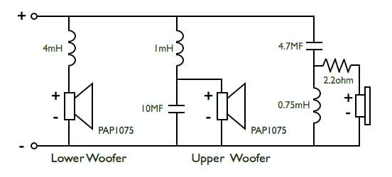

I have attached the crossover in a document. There are some graphs in the build thread i have referred. A part from that the setup is quite "simple".
Is there a decent way that i could do this measurements or calculations?
That crossover is not horribly complex. No Zobel networks are present.

Here are the specs: https://drive.google.com/file/d/0B36Kyv2xZFCtYWhmVjA0a0M4Z1U/view
No go. 🙁 The "Web Nazis" block me. What is the nominal impedance? What is the claimed sensitivity?
