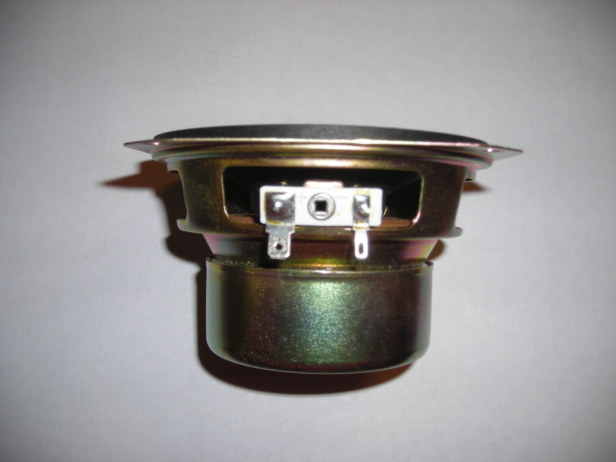

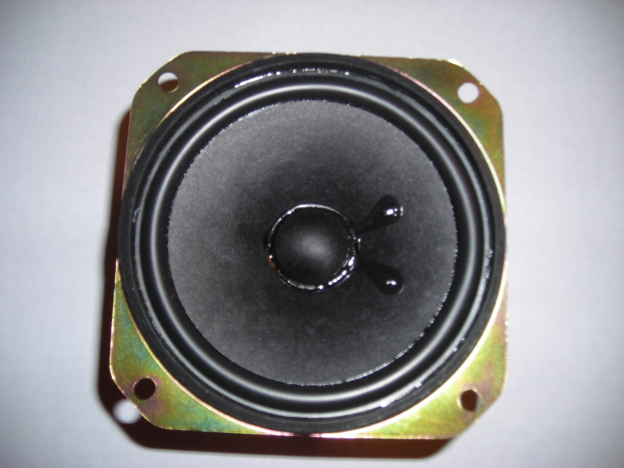

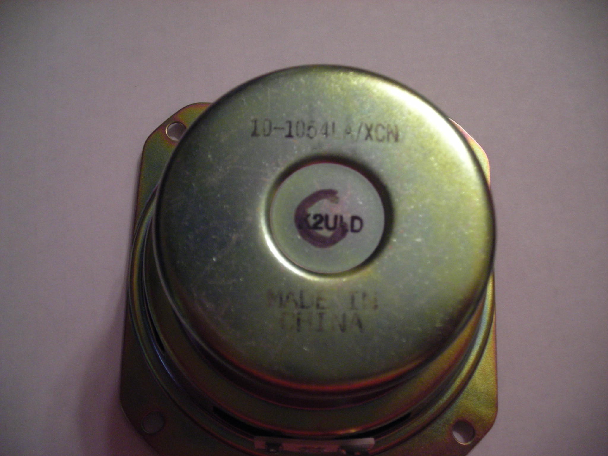

I bought them off of Craigslist. heres a couple pics, hope they work.

I found this receiver, Pioneer USA - Pioneer A/V Receivers as i said before I know nothing about this sorta thing, so I guess im basing my decision for this reciever because it looks good price is right and im asuming Pioner is a good enough brand for HT.
On the specs of this receiver it says 1 kHz w// 0.05% THD @ 8 ohm and on the specs of the speakers on that provided web site it says the speakers are *Znom: 8 ohms *Re: 7.50 ohms. so if i wanted to run 4 of these speakers would i simply hook them up paralel?
and for the final question... what you guys think, boxes or open baffle?

Hi, if you hook four of these in parrallel you will have a 2 Ohm load. Most amplifers won't be happy with this.
You could wire them two in series and then the two pairs in parallel. This would give you an 8 ohm load. However the speakers may not sound at their best this way.
I would wire two in parrallel and use them as 4ohm speakers.
As for OB against sealed box. Do you have a subwoofer as OB designs do not play very deep.

You can try the Totem Pole speaker made by Jean Hiraga with these.
see: L'enceinte Totem (J.Hiraga) (in French but the pictures as always are self explaining)
He used 12 in a series/parallel connection. This is an open baffle of course and has a special form for the bass.
As your speaker looks a slightly bit smaller than the 4 inch Fostex you can of course increase the number . . . to 20, 32 if you like.
