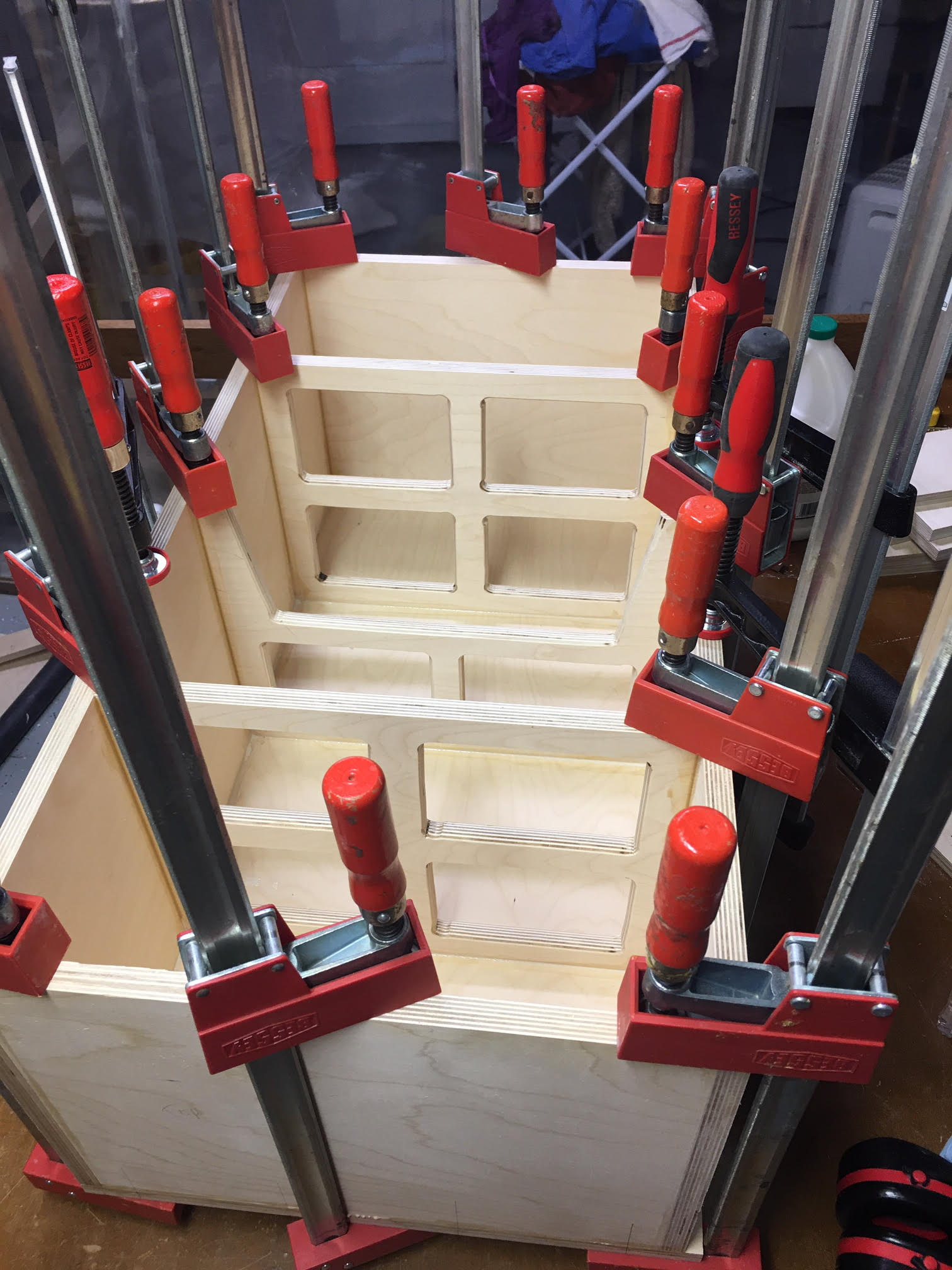

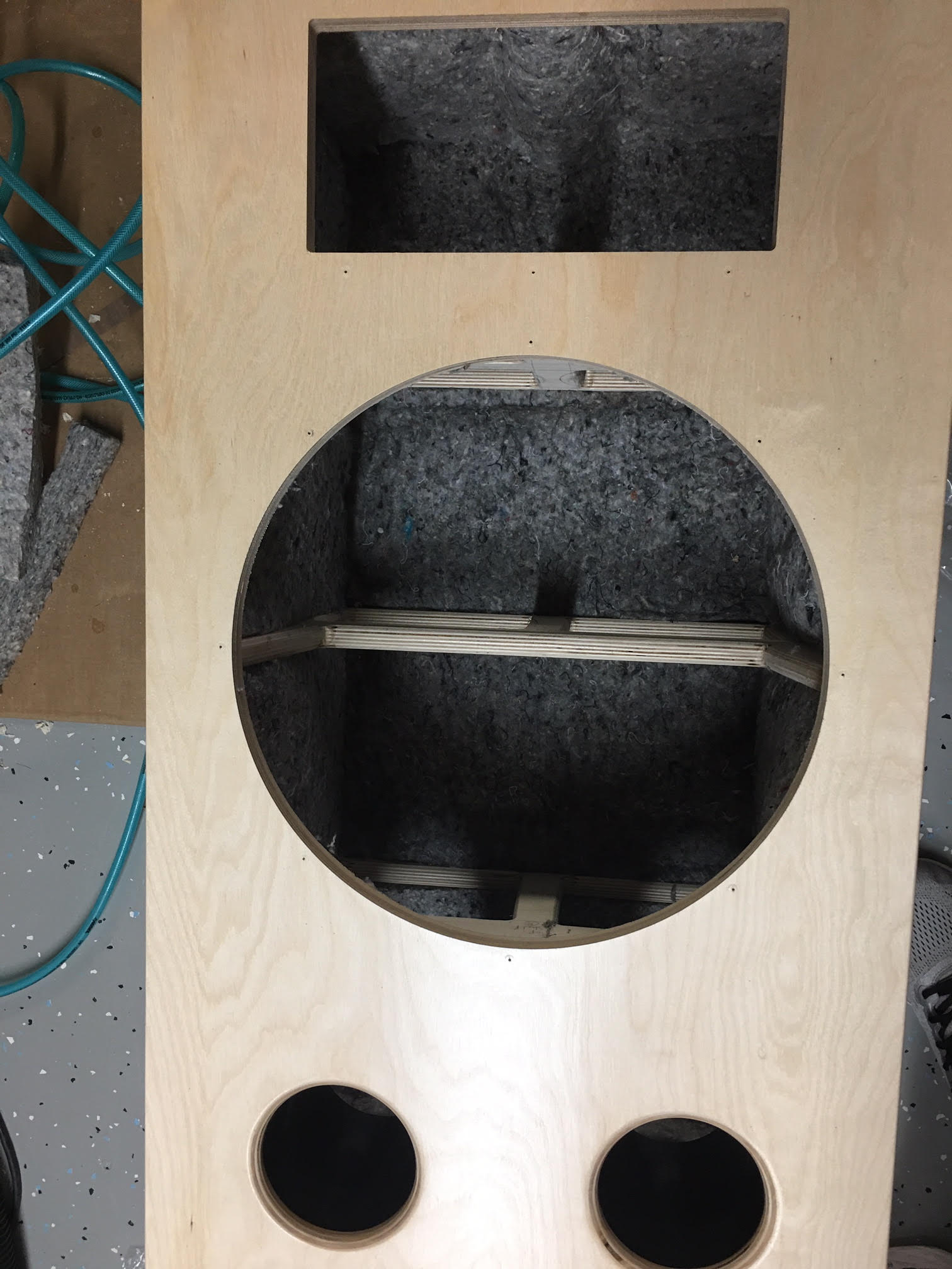

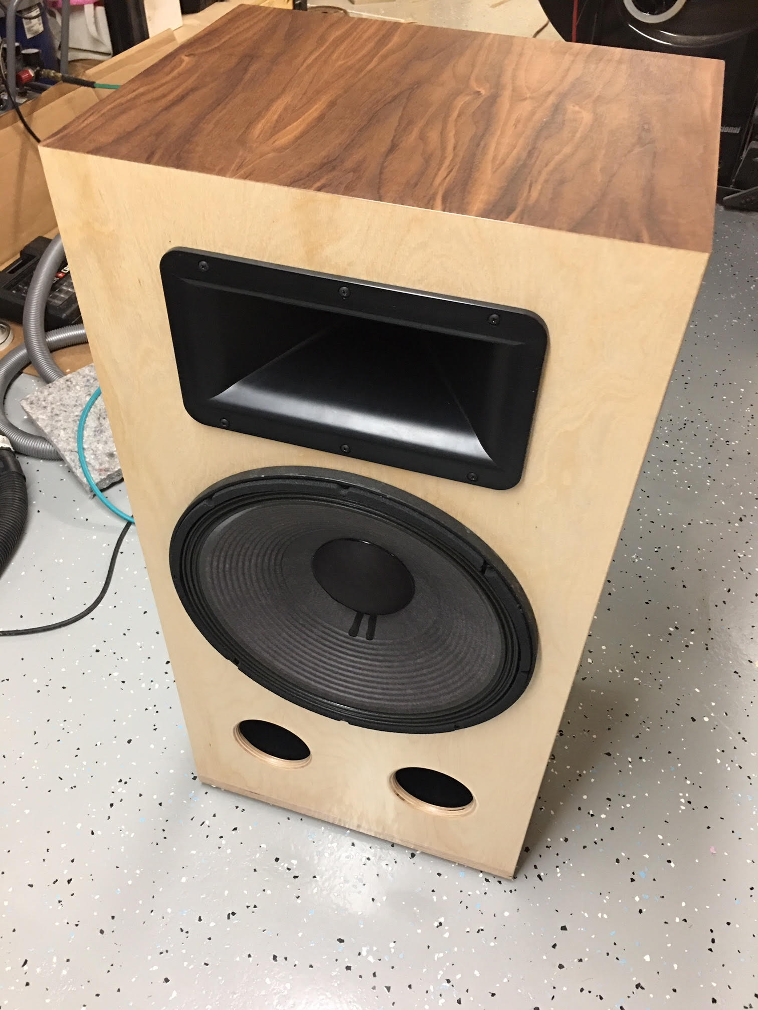

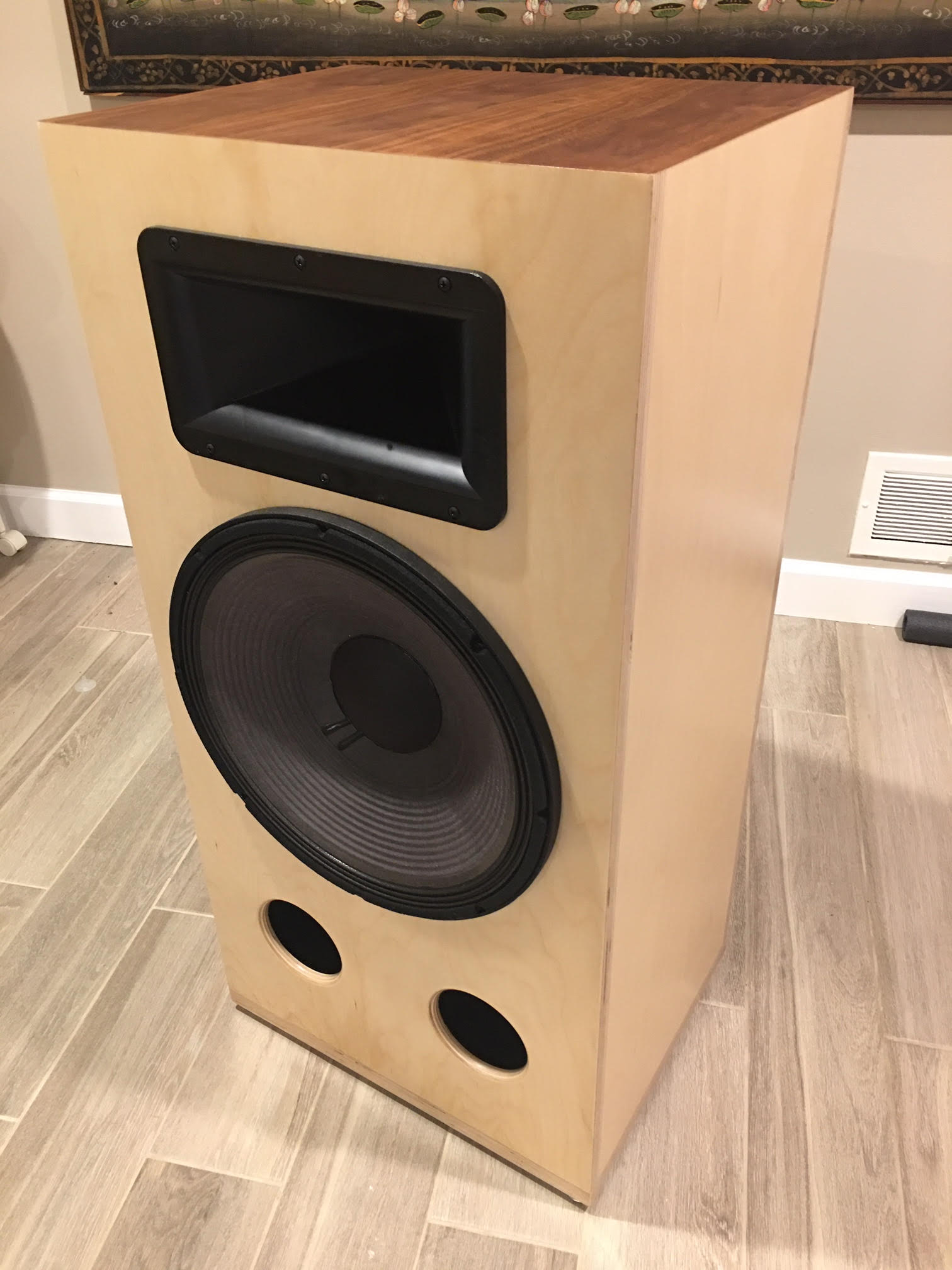

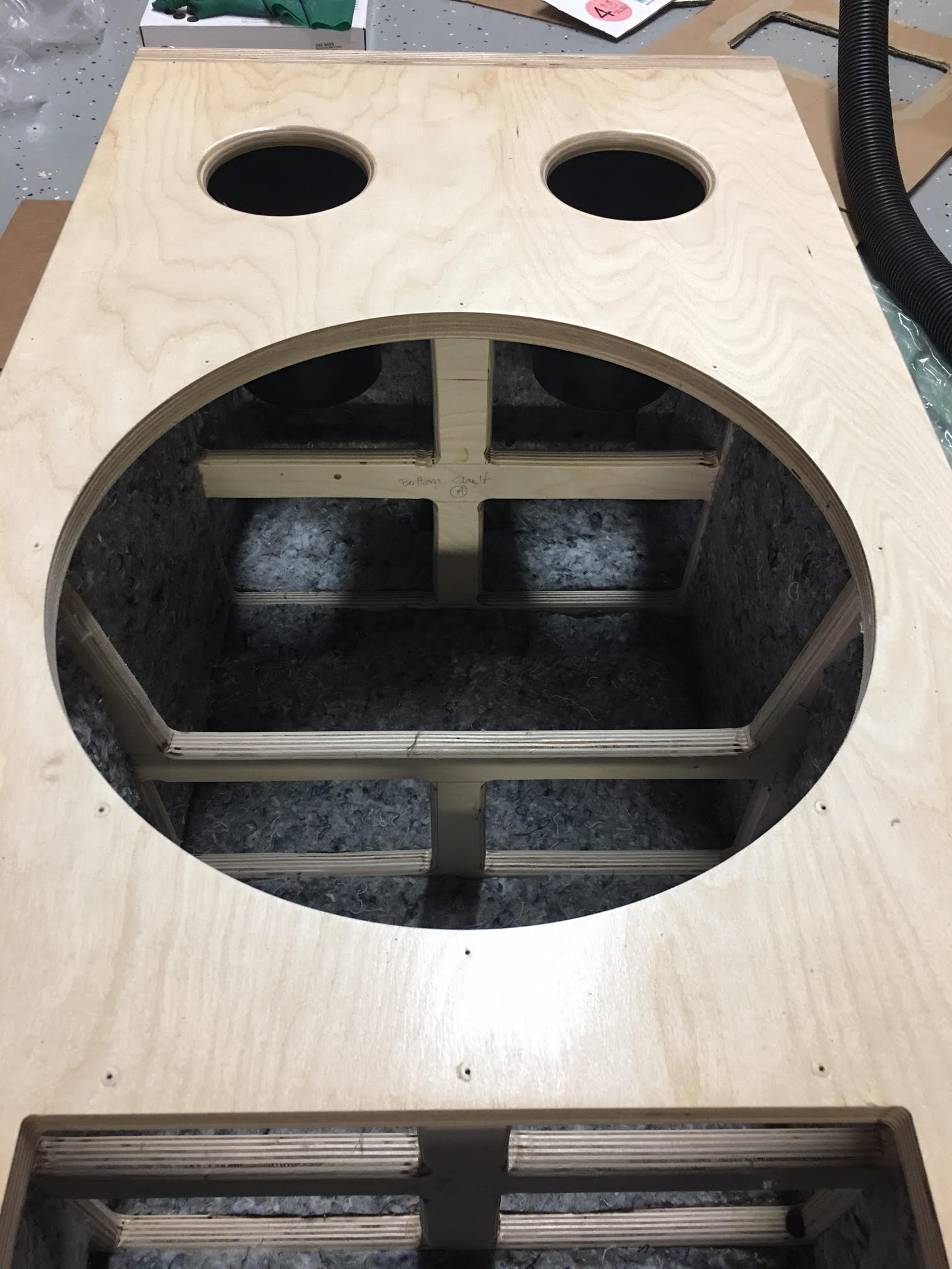

Pair - 4Pi Cabinets - built with 18mm Baltic Birch Plywood - the enclosures were built taller and the horns were centered for aesthetic purposes. No standing wave issues with the tall cabinet - this was verified via impedance sweep and close mic measurements. The enclosures were heavily braced and were finished with water-based poly.
Pair - Wayne 4pi Horns
Pair - Denovo DNA-360 compression drivers (apparently a direct clone of the DE250)
Pair - JBL 2226H drivers, one works flawlessly, the other has a buzz at low frequency.
