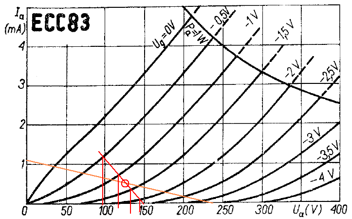

I know that it will be difficult to find an optimal operating point with a starved 12AX7 as driver tube. The effect of the anode-anode feedback will change the load on the 12AX7 to a considerably lower impedance than the static load-line. I have however not yet figured out exactly what the load impedance will be, nor the effective Rp of the driver tube.
A rough estimate of the effective load-line is attached. The oscilloscope also shows that the top half of a sine curve start to look flattened with increased volume.

I think I will have a closer look at the effect of the 15K shunting resistor. The design idea is that the middle of this one will have zero AC signal (virtual ground). This may hold true as long as the output tubes operate in class A, but I am unsure of what happens when transitioning to class B. I will replace the single 15K with two 6.8K resistors and measure what happens in the middle. Maybe also reduce the values a little to reduce the signal feedback.
Any one know what the effective Rp of the 12AX7 will be as a diff-amp in this circuit?
This value seem to be important to estimate the feedback and signal levels.

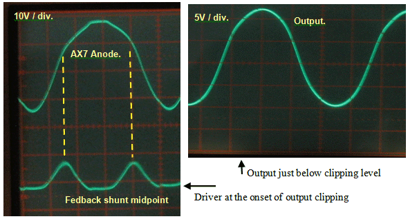

A few measurements show that the circuit works - sort of, but the 12AX7 seem to be under a bit of strain.
My earlier statement that shortening the 15K shunt resistor did not produce any noticable effect in gain is not entirely correct according to my scope. It does give a difference of 4dB, and lowers distortion with the resistor un-shorted. at least at low to moderate volumes. The shunt resistor is now composed of 2 x 5.6K = 11.2K.

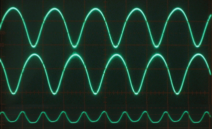

Attached is a scope picture of the anodes of the 12AX7, and the midpoint of the shunt resistor. It is a couple of dB below max power with distortion >5%.
It show unlinearity at the 12AX7 anodes. The lowest trace is the midpoint of the shunt resistor, not quite a true virtual zero.
The circuit seems to operate very close to the limits of the 12AX7 capability, and needs very careful tweaking. I wonder if a more conventilal wiring of the driver with anode resistor to B+ and separate feedback ressitors might be easier to work with. Also a different driver tube (12AT7 ?) might be happier under the strain of the anode-anode feedback.
This means that the voltage at output stage anodes are not equal.
One goal of this configuration is to improve symetry.
Could you indicate the scale of the scope ?
Perhaps what you see is not a distortion introduced by a wrong operating point of the LTP, but the result of the feedback action, I mean a predistorded signal to compensate the one from the "in the loop" output stage which looks at the limit of the overload ?
Strain ? Mmmh ? no over heat nor over voltage !
Perhaps do you dislike such lo current ? It's the key !
Just use an higher value for plate resistors an don't try to pass more current.
You will have difficulties running 12AT7 in such a way
The 6BQ5 are very sensitive and do not need more than 6V rms drive level. The AX7 can do that easily even with a somewhat reduced load.

My measurements are done with the outer global feedback disconnected in order to isolate the inner loop.
My design goal (wishful thinking) was to achieve around 6dB of local feedback and maybe get the output impedance down to around 5 ohm before applying global feedback. So far I have about 10 ohm output impedance. The reduction in output with feedback I believe is a combination of feedback, and the reduced output of the AX7 due to load impedance.
The scope pictures above are 10V/div for the anodes. I am attaching another trace with driver signal at the onset of clipping, and the speaker output. This shows that the signal at the midpoint of the feedback shunt coincides with some "shoulders" of the driver (and output) signals. I am not sure which one is cause and effect.
It is clearly important to keep the load impedance as high as possible. My use of 180K anode resistors instead of your 220K might just be tipping the balance.
I will try to rewire one channel to use separate anode and feedback resistors and see if I can compare the behaviour.
effect
Neither me, but at this level (near 40V pp) the 6BQ5 are clearly over driven.
The shoulder/flat topping is probably the result of some current in the 6BQ5 grids that the driver is unable to deliver.
When this occurs, the link cap charges itself in such a way that the 6BQ5 grids become more and more negative.
You could confirm/infirm that by scoping at those grids in DC mode.
The fact that so much drive is needed to obtain a bit less than 8W suggests that something may be wrong in the output stage.
Thel signal at FB shunt midpoint contains plenty of H2 that could indicate severe unbalance in the PP ?

SveinB[/i] ... the signal at the midpoint of the feedback shunt coincides with some "shoulders" of the driver (and output) signals.I am not sure which one is cause and effect[/QUOTE] [QUOTE][i]Originally posted by Yvesm said:
Neither me, but at this level (near 40V pp) the 6BQ5 are clearly over driven. The shoulder/flat topping is probably the result of some current in the 6BQ5 grids that the driver is unable to deliver.
Yves.
I do admit that i cranked the drive up a bit for the left scope picture to better visualize the effects of the drive circuit. The symptoms are there also at lower volumes. The drive required for 8W is less than 20V p-p as it should be, and there is no serious imbalance anywhere.
The overall result is that the THD start to rise gradually at fairly modest levels, with a high ratio of higher harmonics. Below 1w there is only 0.2% of H2 and H3.
